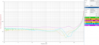

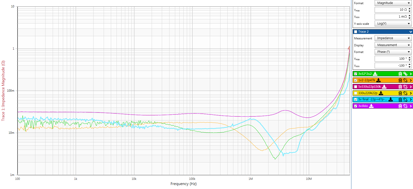

I finally managed to fine tune the output impedance of the regulators. The dips in the impedance are results of big MLCC - 10uF and 2uF respectively. The ESR is in reality way smaller than stated in the datasheet. Speaking about differences between reality and datasheet - I had to degrade specs for 5V buck. Original target was 5v@3A, but it's too hot for sustained load. I had to reduce inductance, reduce switching freq. and reduce rating to 2.5A. I went with too small(package) inductance and did not bothered to sample/measure it before hand. Oh, and since the buck is at the edge of pcb, the cooling is also bit worse than expected. Who would though, you if you place your IC at the edge of the board and place a big 2.54mm connector on the other side, cooling sux.... 🙂
Moral of the story? Before you use new component, measure/validate it first....
Oh and PCBs for thermal characterization are rather bigger than you would imagine... But you need to bother to open the appnote and read about it 😛
I made f*** up 1v2 plane a bit - added testpoints and pullups and plane got separated. Impedance is a bit bigger than planned - but nothing serious.

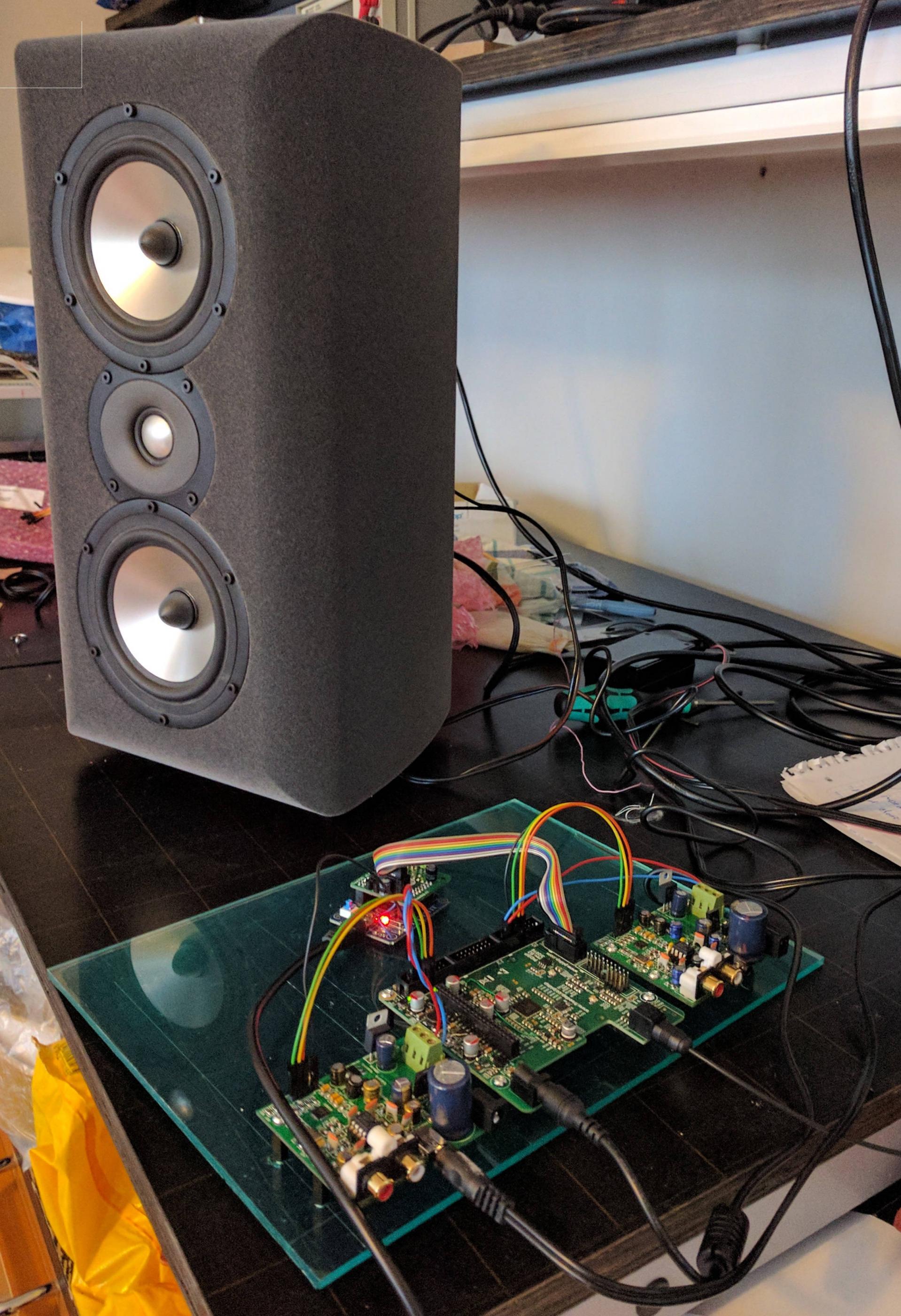

I've managed to finish my speakers - well, right one at lest, i still need to screw in the drivers for left one. Spdif from PC, PiDSP and ES9018 from ebay - lot of observations about this little board. I'll probably post a thread about it in future.
BTW. I've started to built these speakers for my university thesis 6years ago...

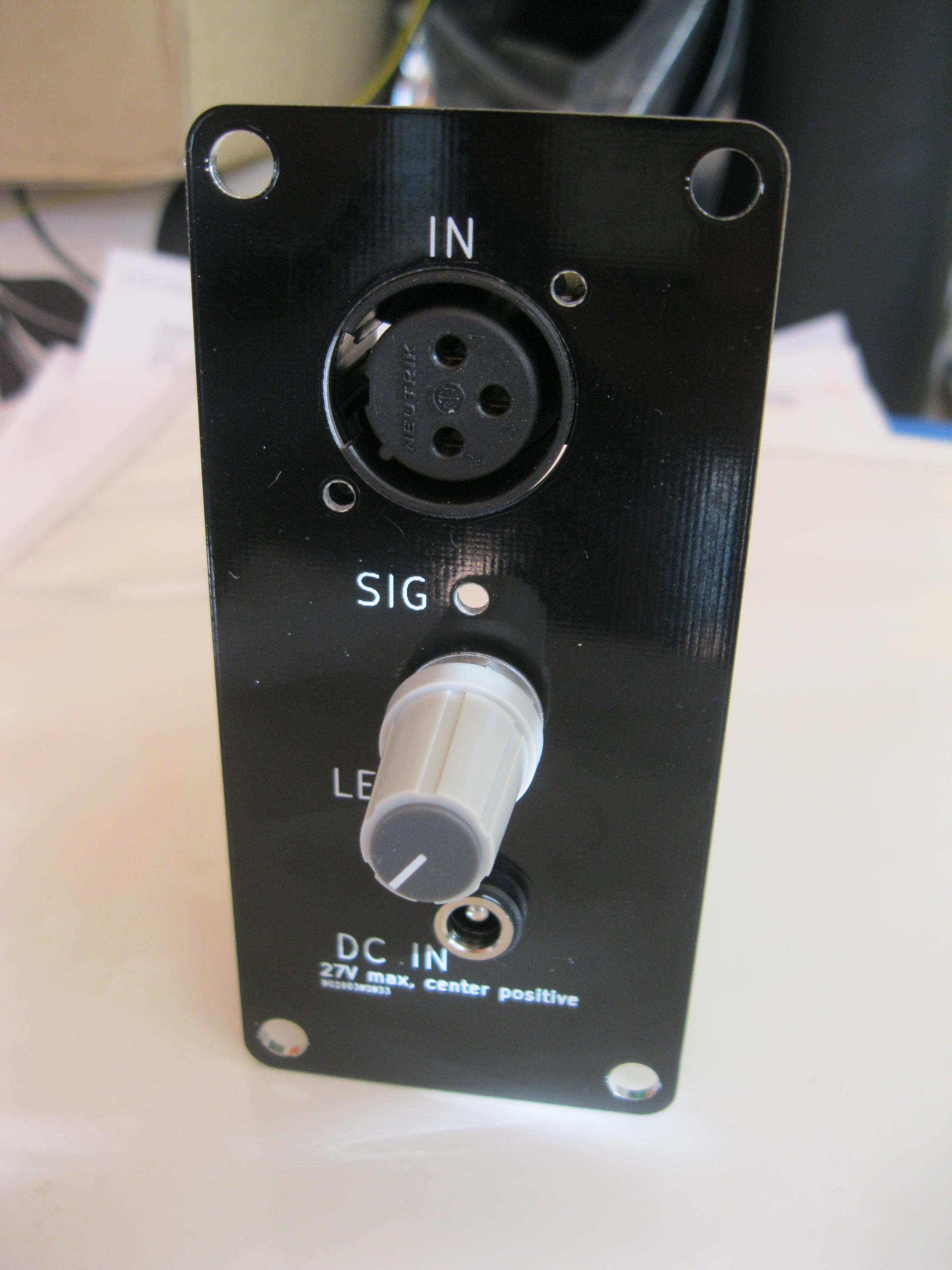

i've used pcbway.com for small runs. the disadvantage is that you may need to provide the exotic parts, and they have to pay import duties on the parts.
enclosed a pcbway frontpanel I did as standard PCB with black soldermask.
I used nut inserts at the back to be soldered in.

Pitrsek, you have mentioned few times you are doing comprehensive power supply impedance measurements - how do you do these? I would like to do such measurements as well - my image is to have a PCB with power supply components (regulators and caps) populated and then measure the impedance at regulator output and at points where ICs are populated? I wouldn't need super accurate GHz results but more like to spot potential resonances up to 100MHz or so.
At home I have only scope and function generator but can use network analysers (never used these though) etc at work. This gets slightly off-topic but if someone could point some references I would be happy, couldn't really find much.

I would recommend reading up on papers/videos by Steve Sandler and Istvan Novak. Appication Notes from omicron labs are also very nice.
I'm using Bode 100 from omicronl labs. Really nice piece of kit. Its a low frequency VNA - 1Hz to 50Mhz, for higher freqencies I use big VNA from RS 9khz- 3ghz. Problem with regular RF VNA low freqency bandwith is usually to high. So you need to suplement lower end freqency range with another measurement- soundcard could suffice. Usually the interesting stuff happens in range up to 30MHz. From there on its just inductance of capacitors and pcb plane resonances. I'm not sure if scope + sig. gen combo will have enough dynamic range, but sure you can try. For scop+ sig. gen you can use injection transformer
, or load tester - see app.note 104 from linear technology.
If you had a two channel sig. generator(or two of them), and have some SCIPI/labview kung-fu, you could roll out your own network analyzer - just need two mixers. If you are interested in "low" freqency VNA, search for N2pK vna. There is even a variant that goes way lower than original N2PK design.
Anyway, low frequency VNA is a great piece of kit, very usefull! Filter transfer functions, component impedance profiles(losses, resonances), stability measurement, output impedance profiles....
I'd much rather have mid level scope and Bode 100, than high end scope only.
