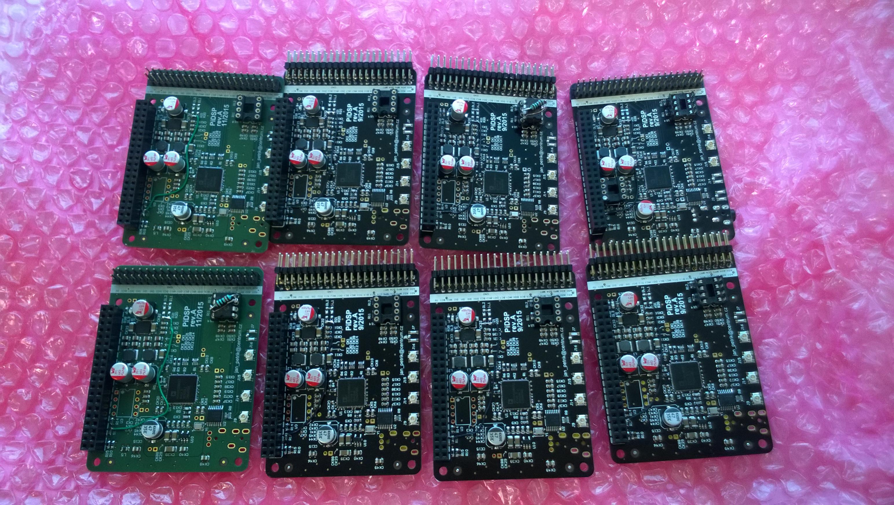

Hi guys,
sorry for being absent for so long. My decision to populate rest of the boards bite me in my posterior, big time... all the soldering, testing, more soldering,more testing....
Unnecessary to say, I made some mistakes and learned few things in the process. Should I do something similarly crazy, I'll probably hack together a re-flow Owen before I start soldering. And get a binocular magnifier. eh, enough bitching.
Some boards are ready and tested, I'm waiting for oscillators to arrive to finish the rest. New version is almost populated and is in the testing process.
In a meantime, new raspberry pi has arrived, and UpBoard, which seems to bee compatible too
For others working with ADAU145x - watch out for power supply sequencing and POR. My core supply and IO supply starts simultaneously, and as such 1v2 is ready before IO. Which is sub-optimal(dataseet page25). Another unfortunate result is that master POR does not seem to work properly. Master POR might work if sequencing was correct, dunno. I've settle with POR signal from buck converter.
Also watch out for EEPROMs - some vendors include pull-downs on WP, some don't. Also some wants you to externally hard-wire 3rd address bit.... yes all of it is in the datasheet, i know...

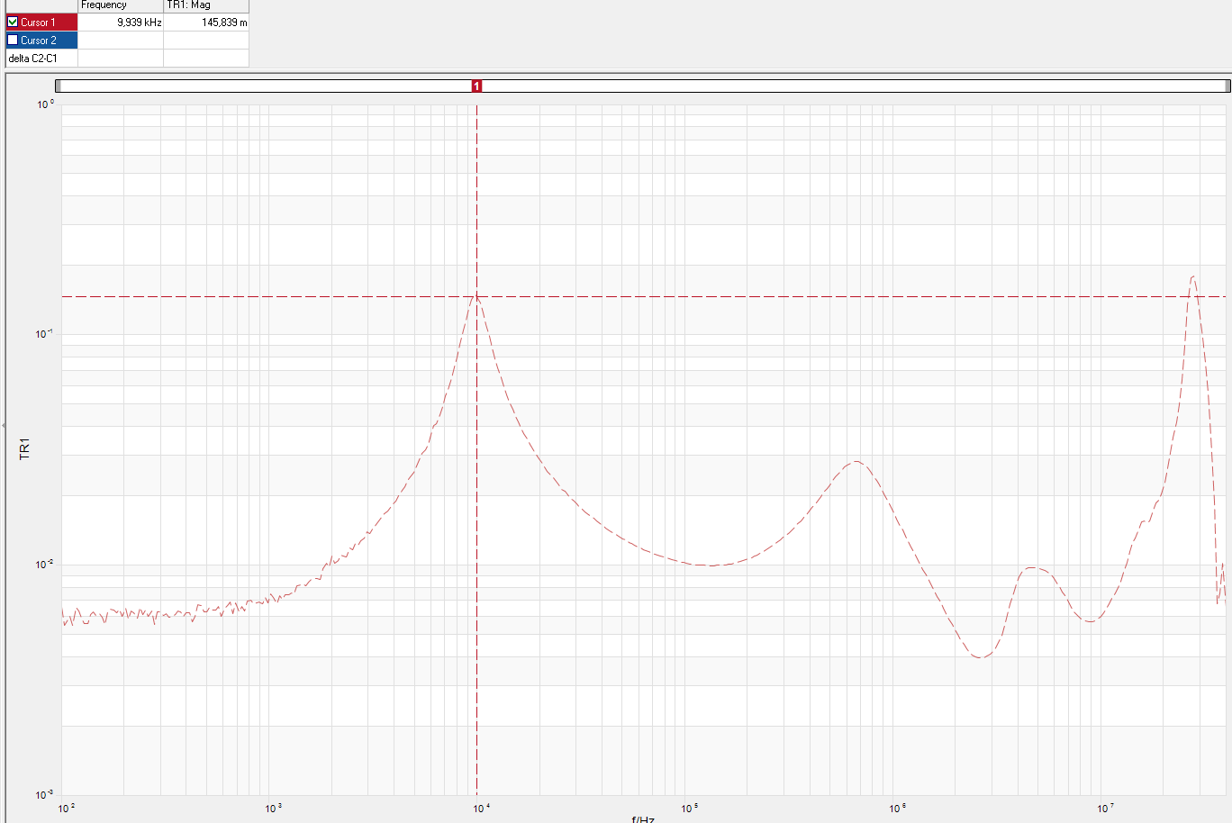

I've played with Bode 100 and measured output impedance of the regulators on PiDSP.
LP5907 3.3V@20mA - low frequency output impedance is cca 80mOhm, if you adhere to the datasheet and use only 1uF output capacitor, you'll have really nice impedance bump(cca 300mOhm). If you want flat impedance, you need to increase output capacitance roughly 100 times . I have suitable 100uF capacitor(with 80mOhm ESR) on the way. This should result in nice flat impedance. I'll post measurements when it's soldered&tested.
lm3370 - output impedance is burred in noise, I would estimate it to be around 10mOhm. Problem with such low output impedance is that it's very hard to attain flat impedance. Alas there is no compensation pin on LM3370 that would allow me to increase its output impedance. Even with 390uF the impedance peaking is quite sever. It's quite hard to measure such low impedance.

Hi vigia,
nice catch with the load current, thank you. I've managed to measure output impedance of LM3370 - it's actually 6mOhms, and it's probably going out... I have a replacement in mind(NCP3170), but I need to test it first. If I like it I'll probably replace L6986 with NCP3170 too. It's 3A converter, with easy to solder package.

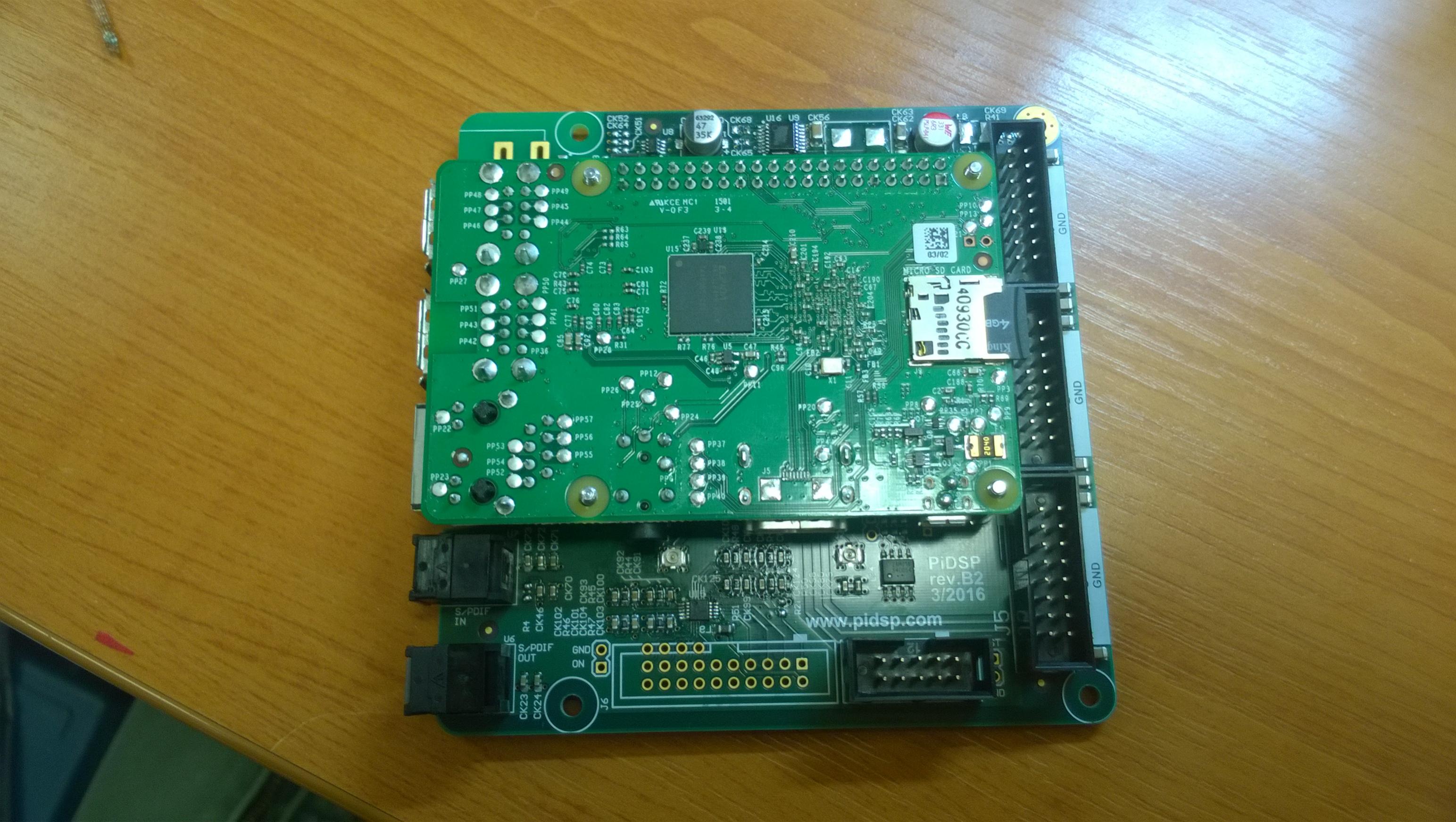

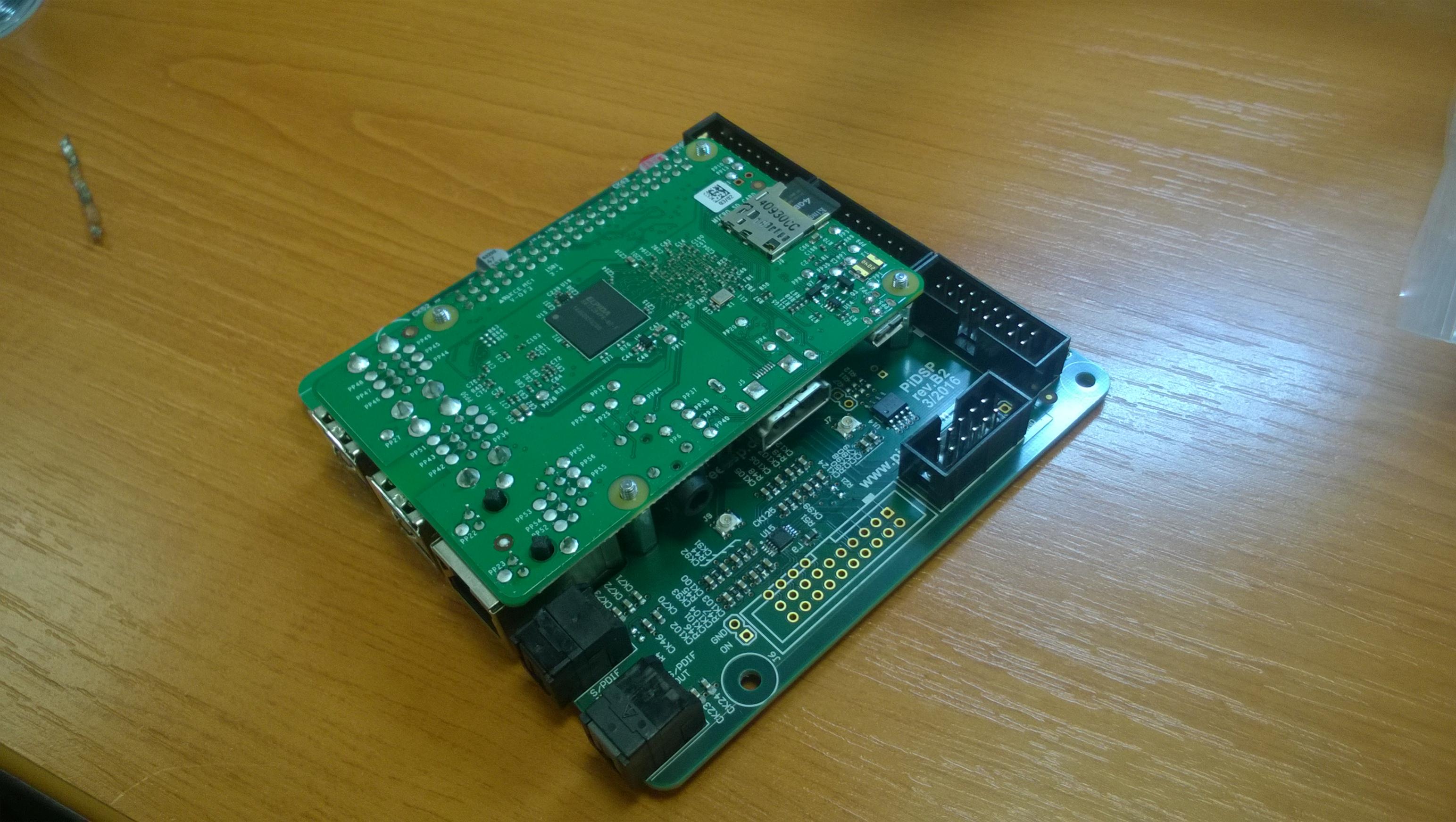

I've discovered two bugs on big version - swapped pins in power jack symbol, and enable pull up for a voltage regulator connected to its output. I'm yet to test the dual L6986.
Oh, and I've spent some time with DAC board.
