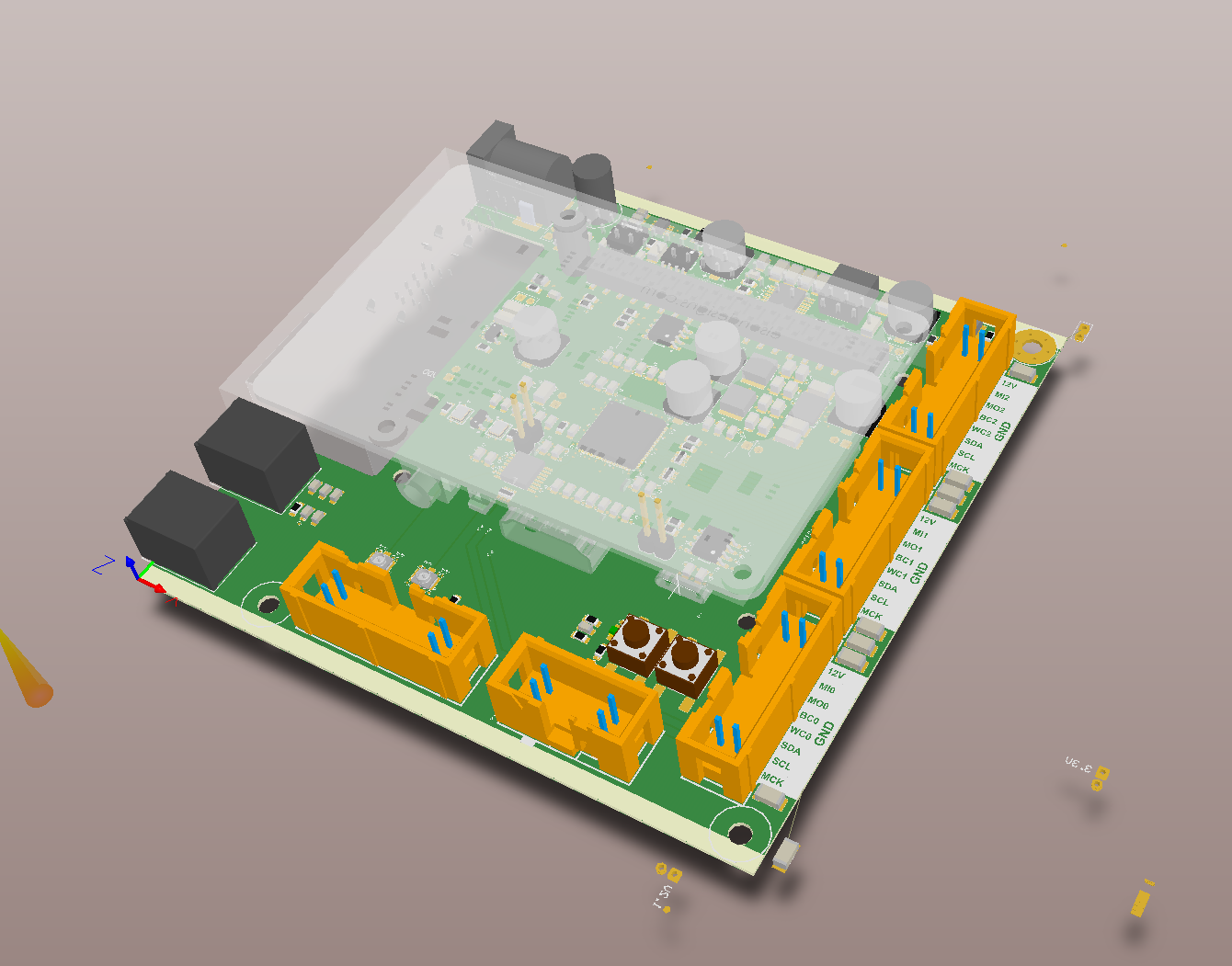

Not dead 🙂
just to let you guys know I'm not dead, and I'm slowly getting there.
Still some routing left. I've managed to squeeze it into 10cmx10cm 🙂.
Bottom-right connector is for USBi programmer, bottom-left are GPIO,adc,power management, i2c from RPI(for lcd) - front panel connector.

hey nice job !!! it looks fantastic ��
I can see a couple of u.fl surface connectors, maybe for an external master clock?.
What do you use for the design ? (eagle,etc). I find really difficult to route the ADAU1701, cannot imagine what is like to route the 1452 with so many pins
