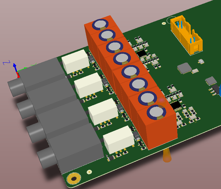

The DSP is alive and well, I've hacked logic analyzer(saleae clone) that got same IC on it as USBi. I can talk to it, program the eeprom and so on. Outptus are nice on scope, I'll try to connect DAC tomorrow. I've found two more mistakes - EEPROM was write protected, SPDIF input was missing coupling cap. Oh, and had to clean up soldering on some places(shorts).
Happy new year!!
Happy new year!!
Excellent work. Is there any carrier present (filtering), or harmonics in the 50kHz -1Mhz range? How well does it reproduce short tone bursts from beginning to end? ie Frequency amplitude and phase frequency distortion, ten cycles per set at 100Hz, 1kHz, 10kHz....At the moment, the first rev:
AD -> DSP -> DA = 0.0006% THD+N single ended 0dBV, differential 0,0004% THD+N.

I'm afraid there is only one clock on the board. I've dropped the second one in order to simplify it. I'm not a software guy, writing a linux driver that could change sampling freqency(and reprogram DSP) on the fly is WAY out of my league. If there is someone who can do it and would be interested in participating on it, please fire me a pm.
At the moment the idea is that RPi will be doing the re-sampling and DSP will run on single frequency(SPDIF is re-sampled anyway). The current version contain a clock multiplexer - so you can change clk to external one. I might keep in the final version, if there's enough interest?
USB input could be provided by plethora of available usb-to-i2s. I'm sorry I do not have plans for USB module at the moment. My goals at the moment are final version of DSP board + 8ch dac. Analog input might come in future, but I make no promises.

Switching MCLK of ADAU will change core frequency 294.912<->293.5296 (for example), this will have influence on system fs as well.
So you need to stop the core (maybe perform a reset), have a new stable clock, reload program compiled at new fs and new PLL settings and change registers in AD/DA as well.
This is a typical job for additional uC on DSP board to simplify the setup. You really have to take care on reset behavior, or mute DA separately by uC.
This will also limit the support for different ICs, because every chip needs a unique initializing config.
Hifiberry has an onboard EEPROM ("Integrated EEPROM for automatic configuration"). If there is an EEPROM, there will be a uC as well.
But the available I2S out is pointing on the fact that no DA register changes are executed? (just a guesswork)
Maybe DA asynchronously?

Small dedicated uC - that is certainly the possibility. I believe it could be done without the uC. If(really big IF) they are using some of the RPi gpio for switching the oscillators, we could use it. The signal would be routed to DSP, I2C switch and a timer/counter. Additionally there is one more eeprom - I2C switch selects which EEPROM is connected to I2C bus. So one EEProm for 44,1kHz, one for 48kHz/96kHz.
If there is a change on the RPi GPIO, the DSP will immediately mute the output(or DACs via I2C if its working already, they had a bug in the I2C) and the I2C switch would connect proper EEPROM to I2C bus(and disconnect the other) and the timer will start. After the defined delay, the proper clock is selected and DSP is restarted. If you are able to talk to your DACs over i2c the delay could be really small, if the DAC is in hw mode, the delay would be a little longer - in order to provide sufficient time to load "muted samples".
Don't get me wrong, small STM32 on the board would be definitely quite handy and the board would by way more universal, the thing is that at the moment there is no one who would program it.
I know a few people who could create the driver for Linux, alas they are all very occupied at the moment🙁. I'll keep bugging them from time to time😀
If I may ask, please measure it. We might discover that they just toggle some GPIO to select right oscillator. Which would be really nice....but I could fire up that driver and measure what comes out if you want.
Yes, please do 🙂, I'm very interested. Or we can skype if you prefer. I wanted to keep it simple mainly because it is "a one man affair", and I feel that I'm probably at the limit of what I can handle on my own(like finishing it in some reasonable(finite😀) time, not loosing interest in it on the way etc.). If you like the design so far and it is compatible with idea of your DSP project, maybe we can work on it to gather. Let's talk 😉.I understand if you want to keep things simple. I'd probably be interested in buying a board anyway, and then save the fancy stuff for a DSP project of my own. I have an idea about how to implement all this, but the changes are quite large compared to your design so I thinks it's out of the question here. I'll draw something up and fire you a PM about it in case you're interested.
Pitrsek, Fio, you've been PM'd
I'll try to do that ASAP. But it occurred to me that it probably won't work unless I have a hifiberry dac+ pro connected. I'll look into buying one if that's the case.
Well if the HifiBerry DAC works the way I think it does, they could start from that. Hell, maybe even I could do that modification. I do enough programing from time to time that it might be within my league (I mean, if it's just about changing how the frequency is signaled).
Hello 🙂
Yes yes, I think this is pretty much the way to go. Unfortunately it's not enough to know the which XTAL to use, we need to know the actual sampling frequency. Unless we can live with integer ratio resampling in the DSP, which would at least be an improvement.
Some questions about the DSP programming. From your post I assume you do this via EEPROM? Or do you use the RPi for that? If the RPi is used, there might be a simple way to do this. First some assumptions:
1. There will be multiple input modules.
2. Some want a fixed fs, some want to change fs (the RPi way be of either sort).
And here is what would take place.
1. An input wishes to change fs, and signals a FCHG event*.
2. The RPi detects this and if the input is currently the active one, it asks the input what frequency it wants**.
3. RPi resets DACs and DSP through I2C.
4. The RPi sets the master clock through GPIO, either to on board clock generator if the second XTAL is reintroduced, or an off board one.
5. RPi reprograms DSP with correct data for selected fs.
6. RPi enables DACs/DSP
*This could be either through a dedicated interrupt pin or I2C. If dedicated pin, they could all be connected open-drain on the DSP board. This mode could make it easier to use of-the-shelf USB boards, but I2C is simpler.
**If the FCHG event is signaled through I2C, this step can be skipped since the request will contain the wanted fs.
We could of course replace RPi in the above with any uC, but it's hard to squeeze in 8 different DSP programs into the non-volatile memory of a typical uC. So using the RPi is preferred i think, except it needs to boot before it can do anything, but a device like this will probably be always on. This is also a lot easier than messing around with multiple EEPROMS. Unless we can somehow change starting address of where the DSP reads in data. Or, use the program start address register in some clever way.
Yes, the plan is to self-boot DSP from eeprom, and use RPI as "dumb source".
I2c and reset will be connected so anyone with enough time and skill can boot DSP from RPI.
Personally I would not worry a bit about integral resampling. Heck my plan is to re-sample it on RPi and use only one clock 😀.
There is quite some board estate in clock area on the new(eurocard format) board. So my proposal is that I would include option to populate 2nd crystal + switching circuitry + provide switch signal(logic 0=osc0, logic 1=osc1 ) from one of RPi GPIOs and I will route the signal also to one of DSP GPIos.
This should not require too much design effort and board estate. Si53360 is actually quite cheap, there is no reason to change it. I can connect two oscillators to one input of Si53360 and switch signal would just enable one whichever you want to use. Or you can reconfigure it via a jumper and switch signal changes between oscillator 1 and external input. Would this work for you? what do you think?
Pitrsek
Pitrsek
That's great. I think I can implement all I want with those changes. Actually, programming from multiple EEPROMS might not be so hard after all, using an I2C switch like you said, if all ROMS are mounted on an addon board. That would be easy if your current EEPROM is in a DIL-8 package, but I guess it's not? Anyway, I'll manage that somehow. But with this option I could implement this either by EEPROM or RPi, options are great 😀
I haven't measured the HifiBerry clock signaling yet, but I've looked at the source code of the linux driver. It looks like clocks are choosen using GPIO. The driver sets either pin 0 or pin 5 of one of the PCM512x GPIO ports. I just have to figure out what RPi pins that correspond to.
