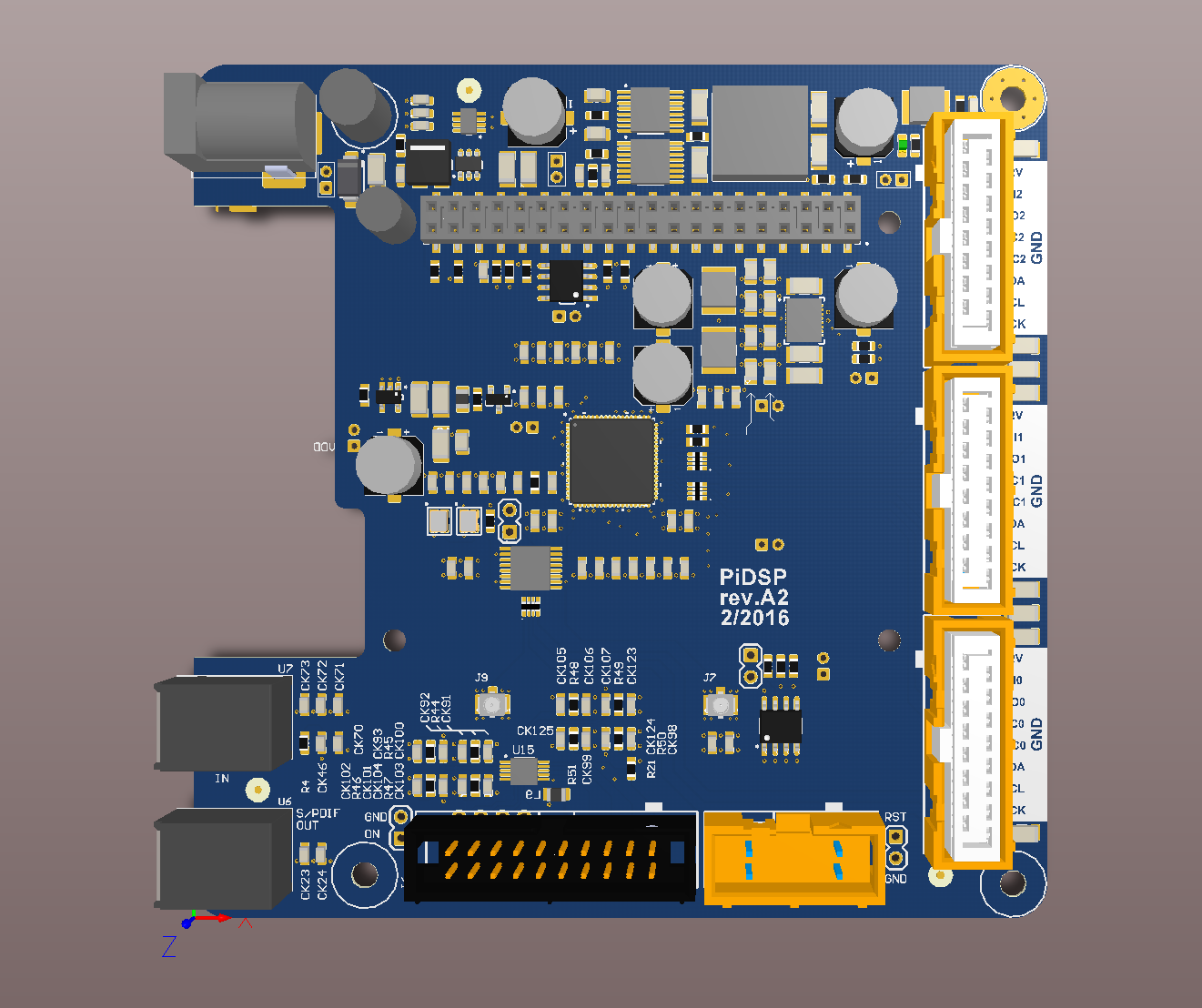

Thx. I'm using Altium Designer.hey nice job !!! it looks fantastic ��
I can see a couple of u.fl surface connectors, maybe for an external master clock?.
What do you use for the design ? (eagle,etc). I find really difficult to route the ADAU1701, cannot imagine what is like to route the 1452 with so many pins
cheers
Pepe
Yes, one U.FL is for external MCLK, one is just MCLK output. It's just an alternative output of MCLK, otherwise MCLK is presented on IDC connectors on back edge.
Yes, routing kinda sux(quite few compromises ). I was tempted to switch to 6L board so many times... I stayed with 4L due to availability.
Yep, single clock, RPI res-sampling. That is where I'm going. I'll do the same for the other input(windows machine with usb soundcard) - re-sample at source.1. DSP board with one fixed clock. R-Pi connected to one of the I2S lines as a music source. The R-Pi resamples to whatever fixed frequency we've set. This is the simplest, out-of-the-box case. The Linux driver can be very simple, basically setting the R-Pi in slave mode. It might be that there is already a generic I2S driver that does this for us.
This would be probably more useful in the short run - the ability to upload firmware through RPI, and when you can talk to the DSP from Rpi, you could control volume at DSP/DAC, instead of in RPi.2. (optional but nice) Possibility to connect the DSP master control bus (now SPI?) to the controller or external EEPROM board.
Actually its i2c again, had to make some space for another wires...
Thx ojg

The PiDSP board is in finishing phase - I've included ESD protection on gpio/adc and changed buck converter to something more powerful(LMxxxx part, current mode with external comp, 4A? dunno the part number from top of my head. ). Layout is not done yet, but I hope It's not that far off.
If you like pcb/electronics design than DAC board is in the making and it needs quite some attention. The design has been thought out quite a bit,but board needs quite some work. It might be "available"(there is a picture of it few pages back) for you to continue if DAC is what interest you. Since I've spent quite some time with it already, I could pass you some notes + design files.
Another pcb project could be the front panel pcb. The connector on the Pidsp carries 4ADC,4GPIO, i2c from rpi for LCD, one pin from RPI for remote control + power management(power button + kill signal). Control panel would make this project really sweet. It would be easier/shorter project than DAC/ADC board and this I did not think about at all(So you would start on green field, with no jabbering about how I would go about it.).
High quality ADC board could be another popular possibility.

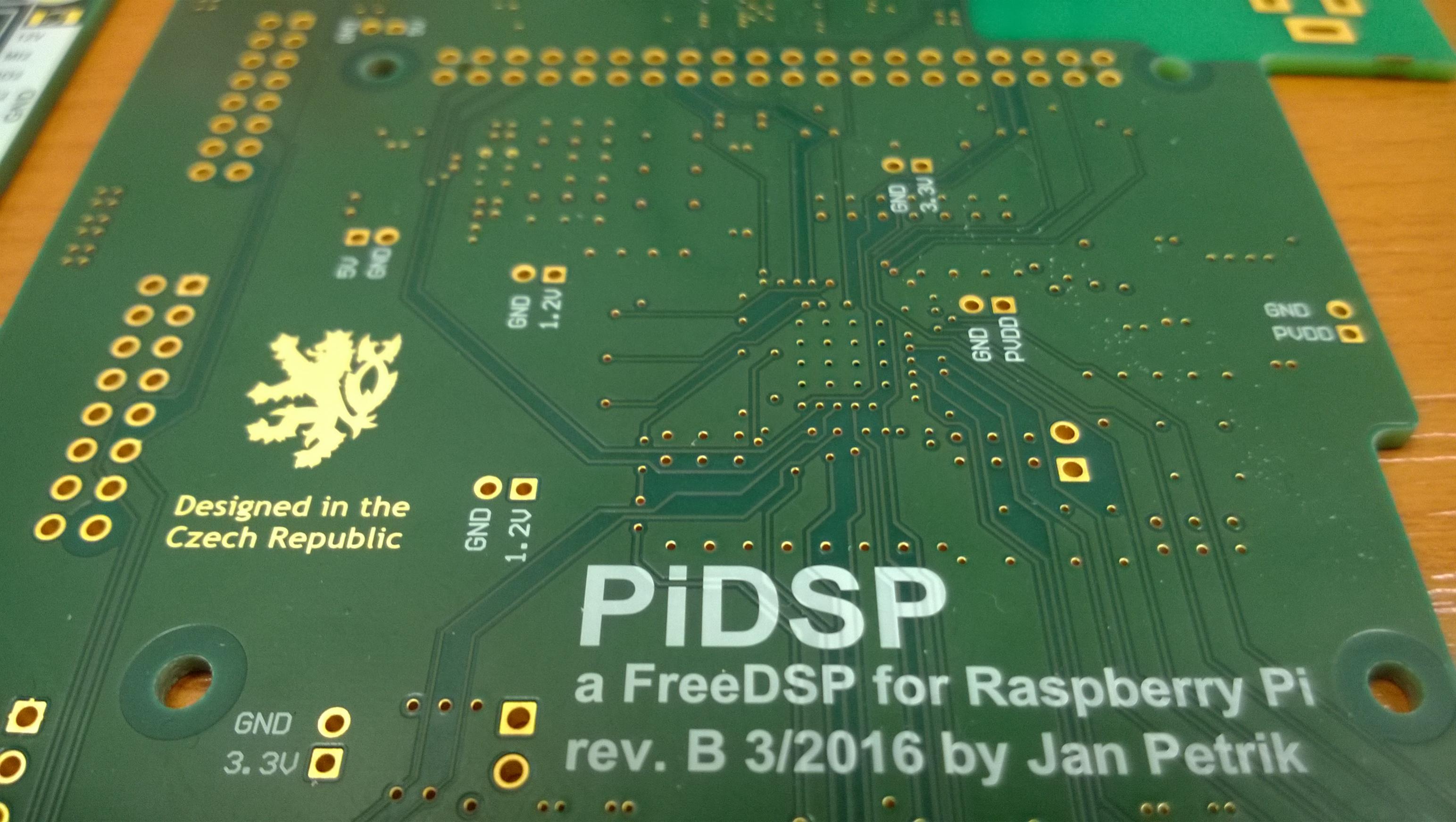

anyway, in the end I've decided to be part of FreeDSP family and release it under same license 😉. It will probably receive it own sub-page at freeDSP page in some time. Something like "PiDSP, a FreeDSP for Raspberry Pi".
So yes, the project is open. It's just that since it's not done yet, I haven't posted source files.

Please have look at the schematics, some values are not final, and will be selected after measurement on populated PCB. If you spot something let me pls. know.

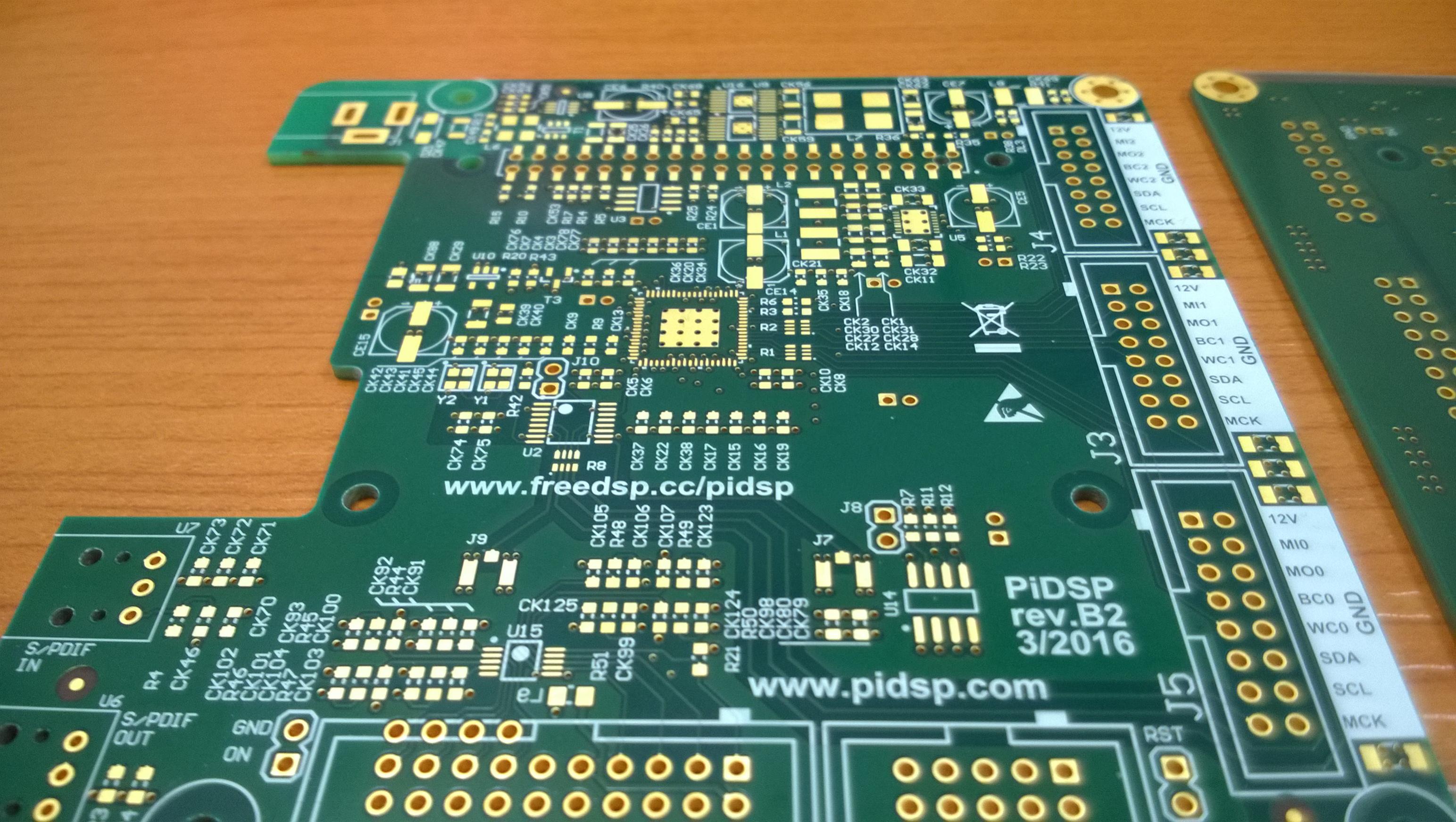

The board needs a little polishing, but it is almost done, I hope I will send it to production sometime during next week.
It turned out that I have one more GPIO from DSP free, i was thinking about beefing it up with external transistor and bringing it out on connector, so you can connect it to SSR and switch off your amplifier when you are not playing.
And it would be probably nice to have +5V on some connector too...
I hate feature creep
I spent some time with DAC too, I've decieded to make the DAC power supply quite straightforward(compared to my original plans). LM1117+TL431 for DAC, LM1117 for opams, LM1117 for 3V3. maybe something smaller if I need the PCB estate. The project is dragging for some time know and I'm getting a bit tired of it. It might happen that I take a pause before finishing the DAC - just FYI.
So, please have look at the schematics + board and let me know🙂

Very nice work Pitrsek! I really like the clean layout with the logical grouping of components. And thank you for publishing the schematic.
Are you planning on selling fully assembled PCBs, or bare PCBs? In the latter case it would be nice if all the components could be hand soldered (by an experienced hand at least). It seems you are very close, only the LM3370 is impossible to hand-solder, would you consider using an alternative with a different package (f.ex. LM26420)?
Thx.
About PCBs dunno, I'd prefer selling populated boards. About packages - if you can solder ADAU1452, you can solder LM3370.You should use hot air soldering/re-flow (yes, you can do without, but it's not really good soldering and not good for the PCB either). I haven't had time(I'd rather spend it by tidying up silkscreen) to look for something similar like LM3370 in different package(this aspect did not occurred to me before you brought it up). LM26420 is way beefier animal, and way more expensive too. If you(or anyone else) suggest similar alternative to lm3370 in better package, I'll surely look into it.

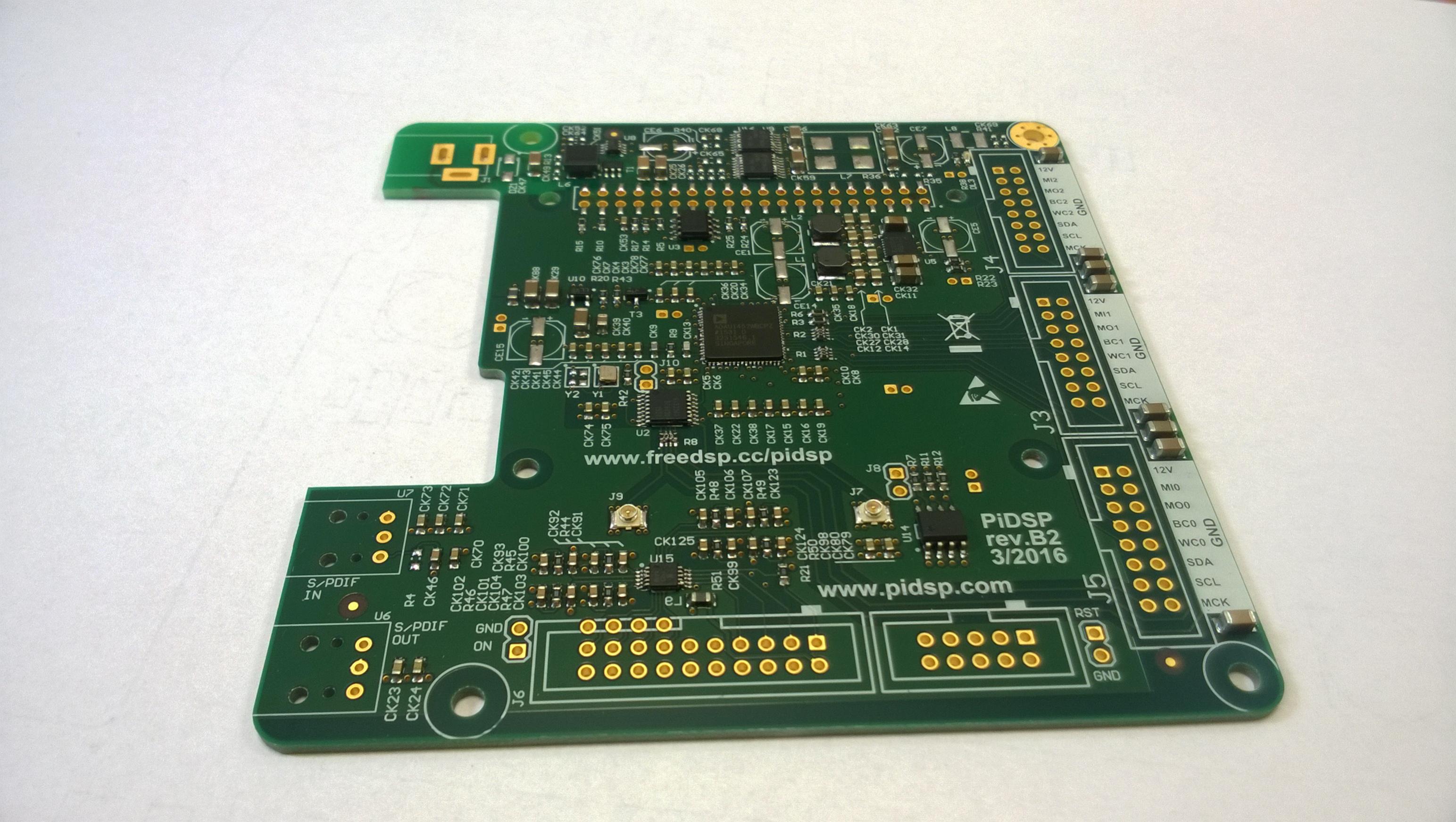

Any idea when we might see a populated PCB available, very excited about this project!
Cheers
ian
If i understand correctly, the DSP is mounted on the RPI header in the same way as my PIDAC. So I would remove the PIDAC, replace with the DSP and use its expansion header to feed the PIDAC now stand alone?
Cheers
ian
Hello Ian,
yes, you understand correctly.
Populated boards availability - that's the tricky question. My guess is around 2 months time. But do not quote me on that. I'm awaiting 2 prototype boards to arrive on Wednesday, then we will see how well it goes.
Jan
