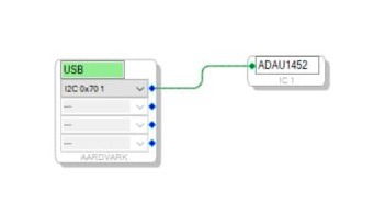

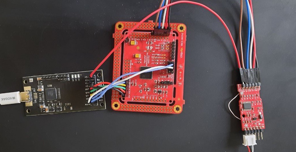

It took a bit more time than I expected to make York work with SigmaStudio. Initially I was thinking of using their TCPIP protocol as I did before, however it is quite buggy and AD does not resolve the issues for years.
So I tried another approach. There is a support of Aardvark devices in SigmaStudio and Aardvark library interface is public, so it is possible to implement Aardvark-like library without need for the reverse-engineering.
I've built a test vehicle with York+ADAU1452+PCM5102 DAC. Works fine :) I only need to work a bit on code related to reading from ADAU.
Now it allows to stream audio and program ADAU at the same time.
And since York basically acts as COM->I2C bridge, it allows to create custom applications to control DSP settings from PC: volume, filters, input selection etc.

Hi Vladislav,
Yeah this TCPIP bug is really annoying. It works as long as you only write stuff into the ADAU but as soon as you read a bigger chunk of data, SigmaStudio crashes.
I also tried with SigmaStudio+. TCPIP works definitly better with it (no crashing on data read; i still had some crashes but I don't know what caused them) but with the new SigmaStudio+ I had issues with SPDIF input only working on ASRC0 and not the other ones...
Also, converting SigmaStudio projects to SigmaStudio+ projects is not working very well, all the Adau settings are lost.
Ludwig
Hello Vladislav-San,
We gonna have various ways to configure the boot ROM. I realized using I2C instead of SPI was the right choice.
It's so nice to work with Audio and I2C communication simultaneously. Many real-time control features will be available. (also the read-out of the Level Indicator)
Now the FreeDSP OCTAVIA board design ver1.1 is York Ready!

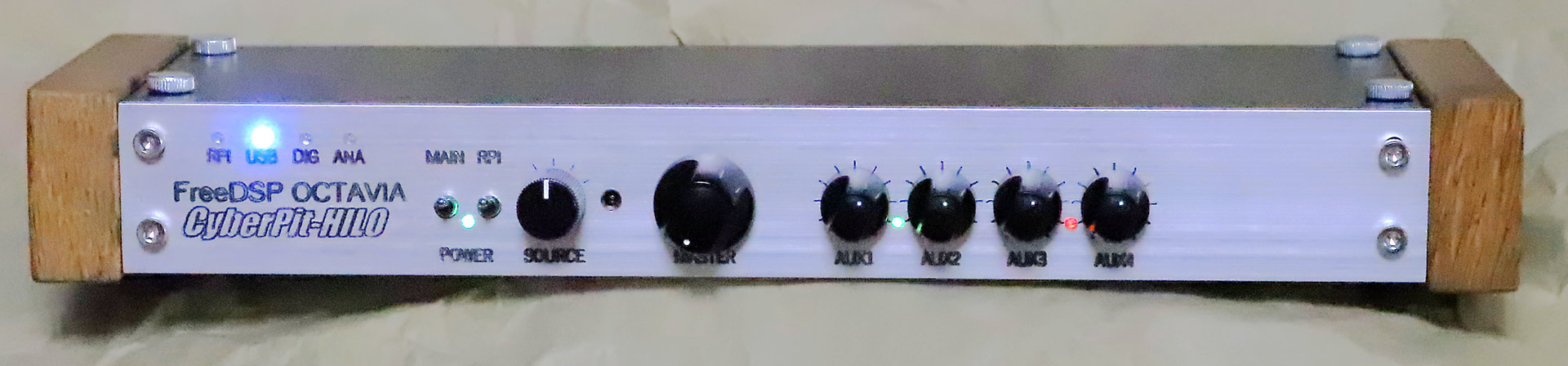

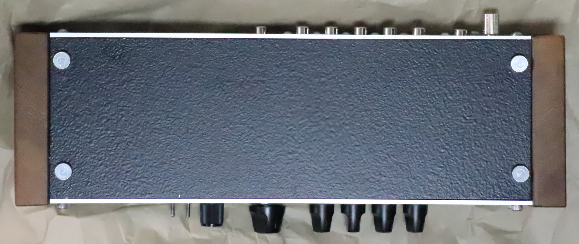

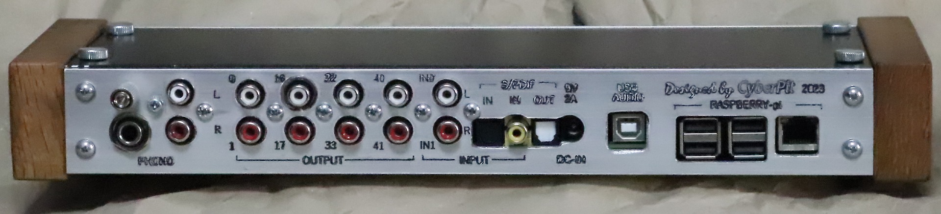

Here is the Silver Panel Version 0.33j FreeDSP OCTAVIA Enclosure.
The power indicator LED had moved from the right.
Add a GND Terminal (Top Right)
Most left 6.5mm Phone-Jack is an Electric Guitar Input. The PHONO input board is not ready yet.
Those panels and Letterings are milled with CNC3018 pro at my residence.
CyberPit

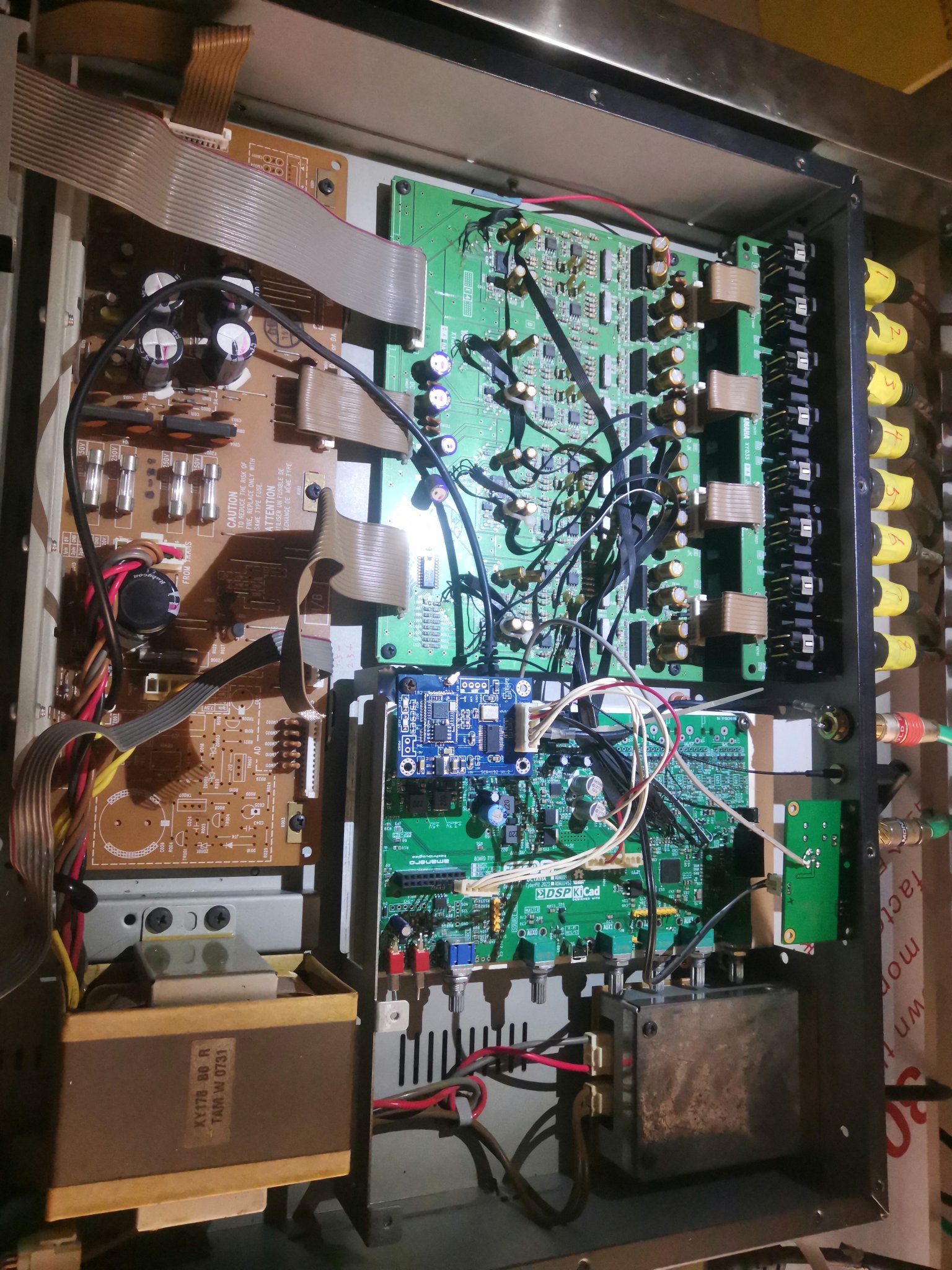

Hello,
I use Octavia to manage DIY hybrid electrostatic loudspeakers.
LR4 filtering + soft frequency correction.
I will have to unsolder 1 or 2 DAC because I need to connect in I2S on external DAC, I do not use the same DAC on the woofer and the panel.
Then a second ADAU1452 will be used for the woofer.
Serge B.
