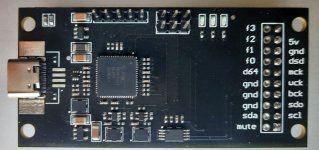

I've been following this thread for a while, there were couple of post mentioning need for 8ch USB input (and maybe output).I understand the current HW limitation of only one I2S input available.
The device also requires USBi for reconfiguration of the DSP. I faced the same issue in my D-class DSP amplifier and found a solution for combining USB-I2S and ADAU configuration from SigmaStudio into one USB interface.
So I'd like to promote my project a bit in this topic since I believe it fits here quite well:
https://www.diyaudio.com/community/threads/audio-transport-module-york.406025/
It replaces Amanero module and in basic configuration (PIC32 only, without BT module and ESP32) can add interface for ADAU reconfiguration. As for USB audio it is capable to input/output 2 channels (up to 8 but not in current hardware - only one I2S is routed), 44.1-384kHz. Can be limited to 192k since ADAU can't take more than that.
I'll need maybe a week to polish FW a bit for this and then I can ship one module to you to try it out. Please DM me if you are interested.

Hello Vladislav,
this looks like a realy nice project.
The ADAU configuration will not work on the octavia though as the I2C bus of the Amanero header is not connected to anything. Nothing that could be changed in the future or with some cables though.

CyberPit,
I will put together couple of pictures, maybe a video for demonstration.
Ludilu,
Indeed, in current hardware it will require 2 wires from the module to USBi connector.
As for USB-C - yes, I found it much more convenient but there is also an option to solder USB-B because many people are used to it.

Hello eclipsevl-San,
Thank you for your support.
I have now started adding a feature for the "York" I2C programming.
The default routing is RPI.
If you want to configure DSP/EEPROM via a York, need to pattern-cut between pin1-2 and make solder jumpers on JP4/JP5 pin2-3.
This York-ready design will be available soon.
CyberPit
