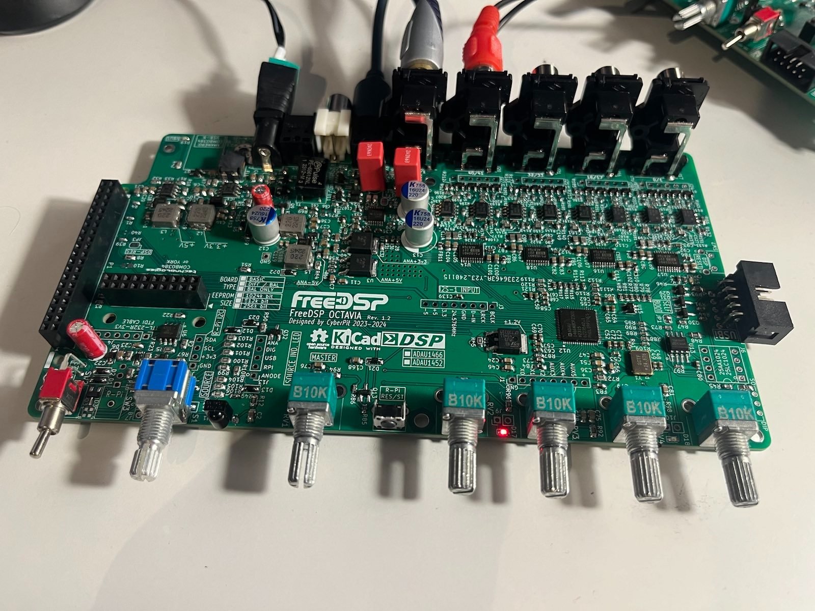

I'm dealing with an interesting issue regarding the stability of AUX_ADC.
In the format 32.0, when set to full volume, I notice that for example:
Is this behavior normal for ADAU1466, or could there be something wrong on the hardware side?
I've checked the pins with an oscilloscope and they seem okay to me. The problem is that this fluctuation is audible in the sound (a kind of crackling).
I've been trying to identify the cause for a while, and eventually, a design where I use a DC block instead of AUXADC pointed to the culprit.
Any ideas please?
Thanks, Tom
- AUX_ADC_0 oscillates between 972 <->1023 without any movement of the potentiometer.
- AUX_ADC_5 (yes resistor source select switch) oscillates from 802 <-> 828 when set to full volume.
Any ideas please?
Thanks, Tom
