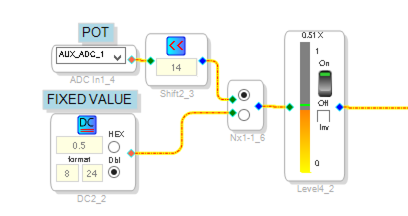

Joined 2018
Maurizio-San,
Here's a selectable example idea of SigmaStudio. The pot at 12 o'clock equals 0.5 DC value.

Good Morning Pit.
Here what i'm using to test the outputs..can you explain me the functions of the blocks you suggested to use?
Joined 2018
Hello Maurizio-San,
Your test project is completely free from AUX ADC. So, you can leave the pot(s) as non-populated.
My suggestion for value-controlled blocks, that usage is as follows ...
1. Select the Nx1 selector equals AUX_ADCx
2. Adjust the pot as you like
3. Read the Level indicator's index value
4. Give the same value to DC2 block
5. Select the Nx1 selector equals DC2 block
After this operation, you don't need the pot anymore.

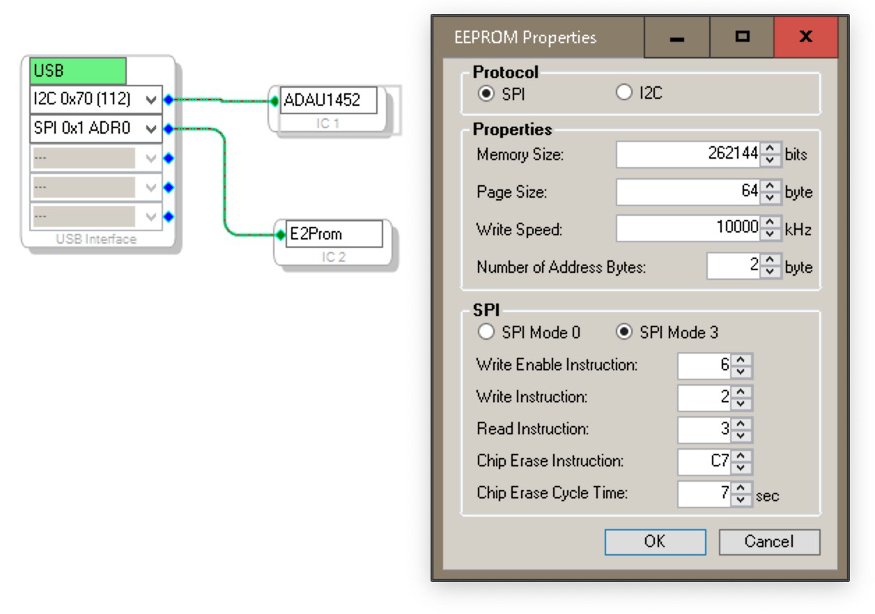

HI Pit.
Thanks for all you support.
I've an issue with the EProm.
I followed the instruction about how to write on the Eprom..seems that the compiled code was downloaded..but as i reset the unit is not loading. To let it work i need to connect to sigma studio.
Any adivise on it? Soemthing i need to check?

Pit. I'd a look to the PCB.
I was thinking to have the AA1024-I/S Eeprom installed, but i've the 95256RT..
I used the setting reated to the first one..maybe is not compatble?
Do you know how i should set the parameters?
Thanks a lot.
Thanks a lot.

Thanks Pit-San.
Thanks a lot. I checked with this configuration and it works.
But..just if i use the ADAU1452 as processor.
If i do the same based on the 1466...everything will work with sigma connected...but won't work on the Eprom.
Do i need to configure the use a different address for the Eprom if i choose the 1466? IS the HW configuration different?
One suggestion about the JP1 connector. Because is very helpful if you are in trouble with Eprom operations..in case of new improvements, i will replace it with a THT in line pin headers.
Would be quite easy then to short the contact using a jumper.
What do you think about?

Joined 2018
The configuration connection chart processor type should choose the right processor that you are using.
It may generate different mapping codes.

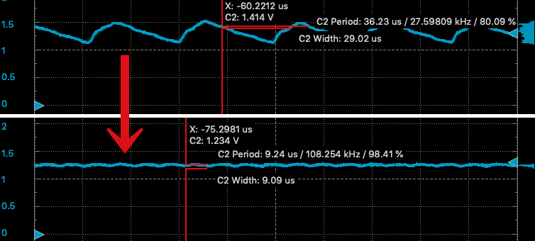

FYI
An improvement for all versions of FreeDSP OCTAVIA boards.
Removing C24 will reduce the ripple voltage contained in DVDD power rail.
More information can be found at the following link.
https://github.com/freeDSP/freeDSP-OCTAVIA/wiki/Errata-and-Workarounds
CyberPit

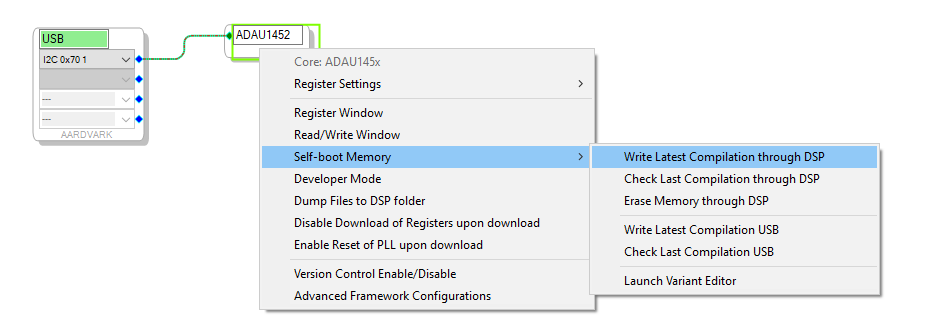

for the users of York with Octavia: there is a known issue with USBi/other programmers when programming/erasing EEPROM thru DSP:
It rarely works, there are many discussions about this issue in other threads.
Today I spend some time trying to debug what goes wrong and found possible reason. I uploaded new communication dll for SigmaStudio which has the fix. If anyone has experienced such issue and wants to try - please get new dll (it is in the config tool package) from the website.
