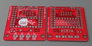

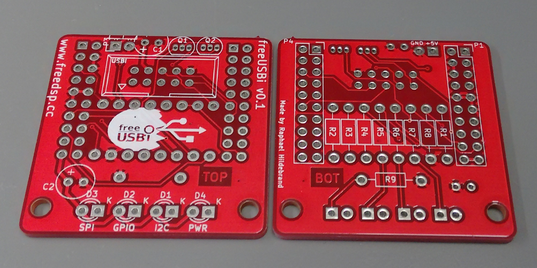

I have a couple of freeUSBi bare PCBs available if anyone needs as I ordered a bunch of them from Elecrow. Usual Elecrow quality, red solder mask. 2 euro per piece plus postage, 2 euros Europe, 2.50 euros elsewhere.
