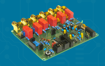

I want to spread the news about freeDSP (freeDSP | An Open-Source Low-Budget Audio DSP)
This is an effort to develop an open-source hardware platform using the ADAU1701 DSP chip that is similar to the miniDSP 2x4. The main differences include:
  • ability to run at 44.1k, 48k, or 96kHz sampling rate
  • publicly available hardware design (I assume the board's Gerber files will be public)
  • programming done using the SigmaStudio interface instead of the miniDSP GUI
  • lower cost (50 Euro per board)
  • board comes as a DIY kit with thru-hole parts. Any SMD parts will already be soldered to the board.
What you get is a kit that requires assembly, that is less expensive than the equivalent miniDSP offereing, and has greater capabilities than the miniDSP offering (the 2x4). This is not only because it can run the board at a 96kHz sampling rate, but also because SigmaStudio offers a much wider range of DSP processing options compared those available via the miniDSP 2x4 GUI. MiniDSP chose the lower sampling rate and limited DSP architechture for the 2x4 so that it would sit at the low end of their product lineup. With the freeDSP board, all the possibilities that can be supported by the ADAU1701 DSP chip are unlocked through SigmaStudio.
This is a very exciting and superior alternative to the miniDSP 2x4, and I am embracing it 100%.
They are currently accepting names for the first run of these boards at the web site. They need only to reach 20 pcs before they place the first order. If you are at all interested in DSP, this is definitely worth trying.

Elektor Electronics magazine has a quite similar board they sell (the cheapest is a bare PCB with the ADAU1701A soldered for €21.95: http://www.elektor.com/adau1701-universal-audio-dsp-board-130232-72 ). It would be nice if the freeDSP project provided the analog measurements first before attempting to sell the board anyway.
Also if they are goin to manufacture the board (using production house with pick'n place machines) it would be better to select the ADAU1452 as DSP with some inexpensive multichannel DAC like WM8766 (2,26€/piece at Farnell - on the other hand something like PCM1690 would offer a little bit better performance for about €7 price). No ADC would be needed, the chip has got SPDIF input (and output as well): http://www.analog.com/en/audiovideo-products/audio-signal-processors/adau1452/products/product.html
Also you don't really need USBi but that's another story (just find what is common with USBi and EZ-USB FX2 boards available on ebay).
One of the rubs with the Mini DSP for me was the low output voltage for single ended applications. Something like .8 volts. Any idea what the output is for this item?
I don't think that the freeDSP board does anything drastically different at the D-to-A end. It's probably limited to 0.9Vrms like the miniDSP 2x4.

I have been playing with and using the Elektor board for a while. It works just fine.
There is some goofy stuff that I wont populate when I build my next one such as zeners clamping IIC (I will just use a 3.3V arduino for programming), some extra headers, op amp buffers on the aux analog inputs, and so on.
The input caps are too small (0.1 uF resulting in -3dB @ 80 Hz) which is easily fixed by replacing or paralleling 1.0 uF caps.
The output circuit is wierd, but works OK. Quick and dirty measurements show flat response (with the input caps fixed), 5KHz square waves just fine, with a hint of ripplie on top. Distortion < 0.01%.
The output clips with 6V PP applied on the input, output is 2V PP at clipping.
All this with Sigma Studio configured for pass - through.
Noise is not a problem with my 96 dB W/M speakers.
No problems here that cannot be solved with a couple of op amps.
