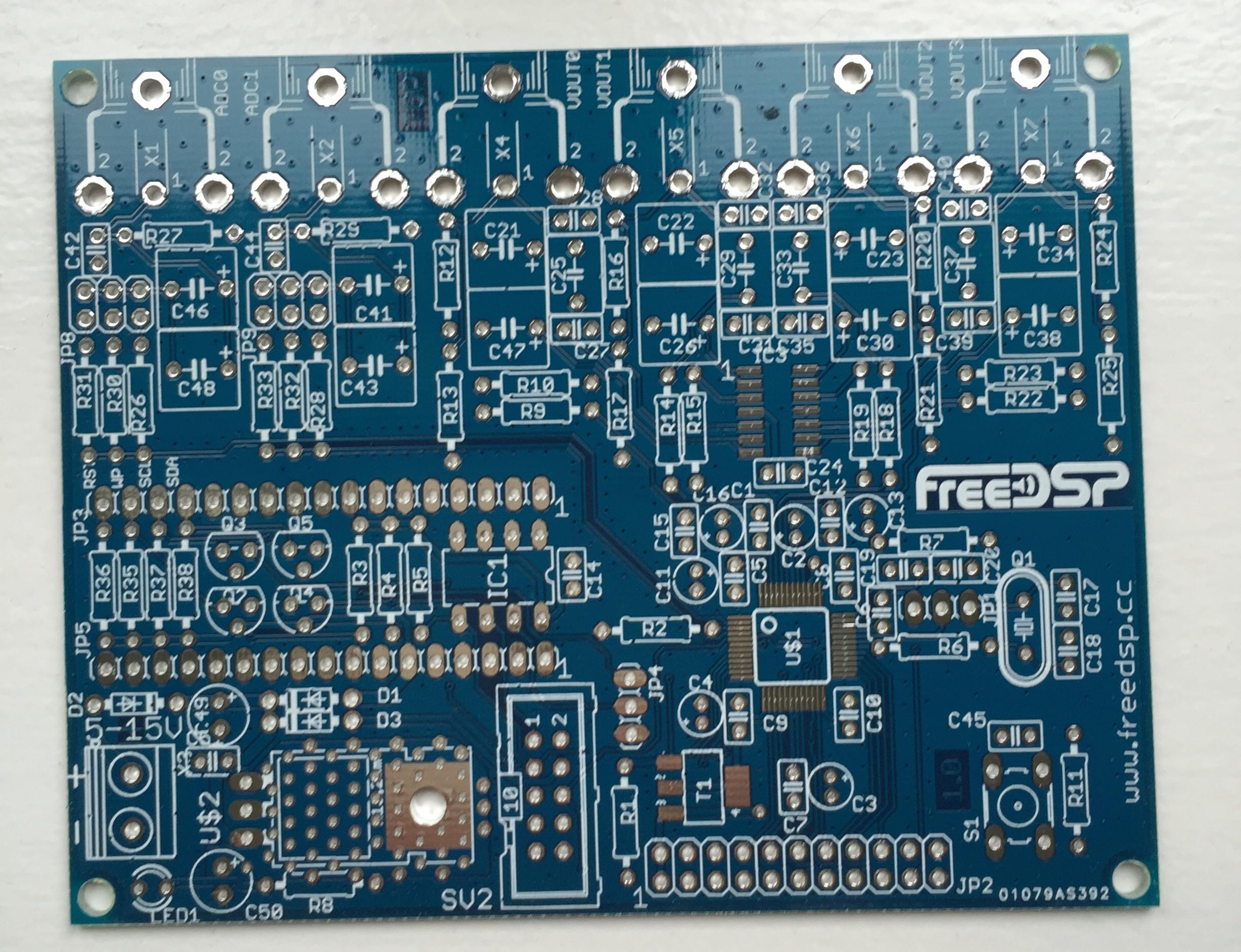

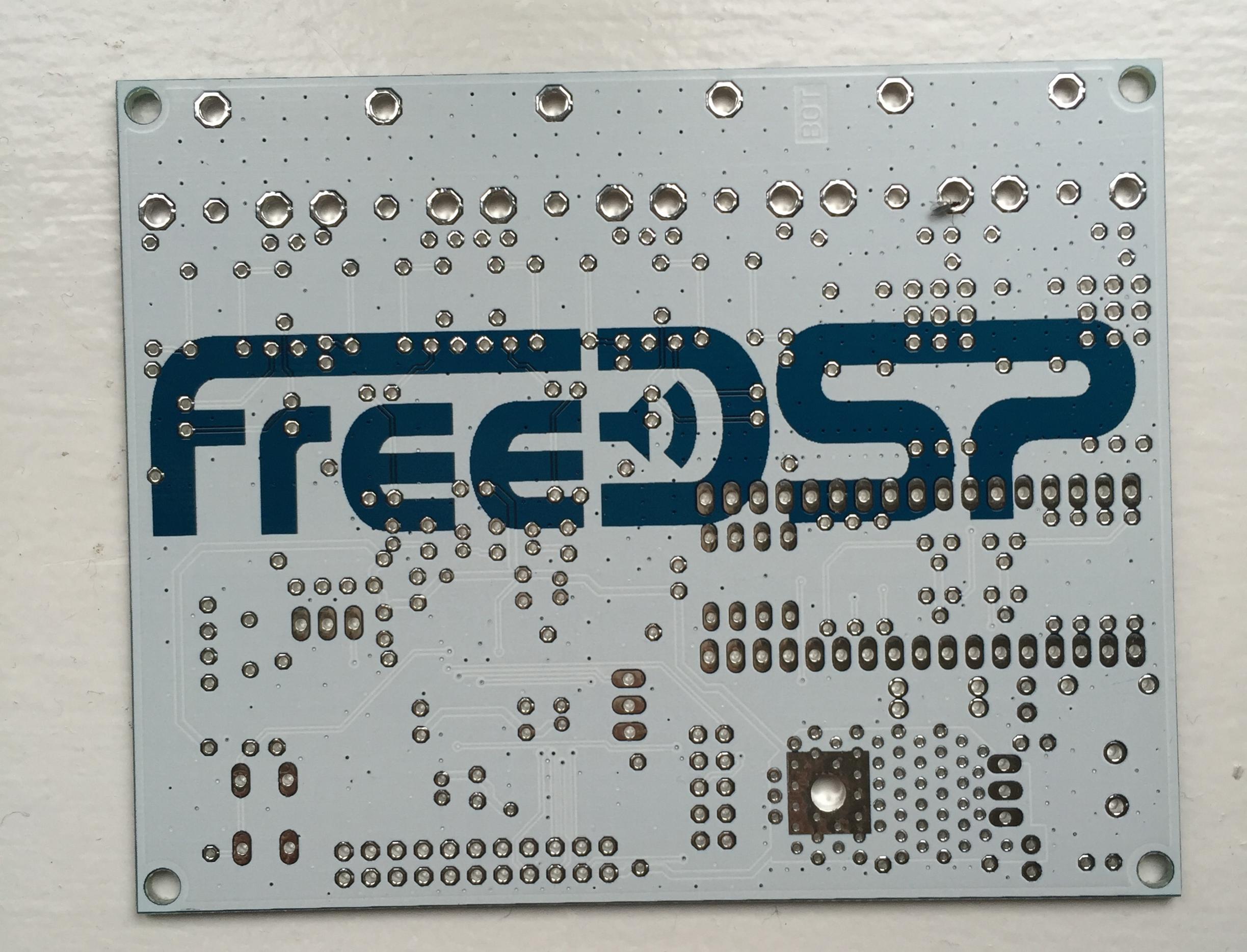

I have added this board on OSHPark. Unfortunately the text on the backside has been messed up for some reason. The price is 62$.
If you prefer HASL, its only 21$ at seedstudio (i have already ordered 10, if anyone from Denmark is interested in a board, let me know!).
https://www.oshpark.com/shared_projects/gNG1unyD

Looks great Rob. I think I will order some pcb's myself. Have you tested yet?
Has anyone assembled the BOM and put together a mouser/digikey cart? I might work on that tonight.
