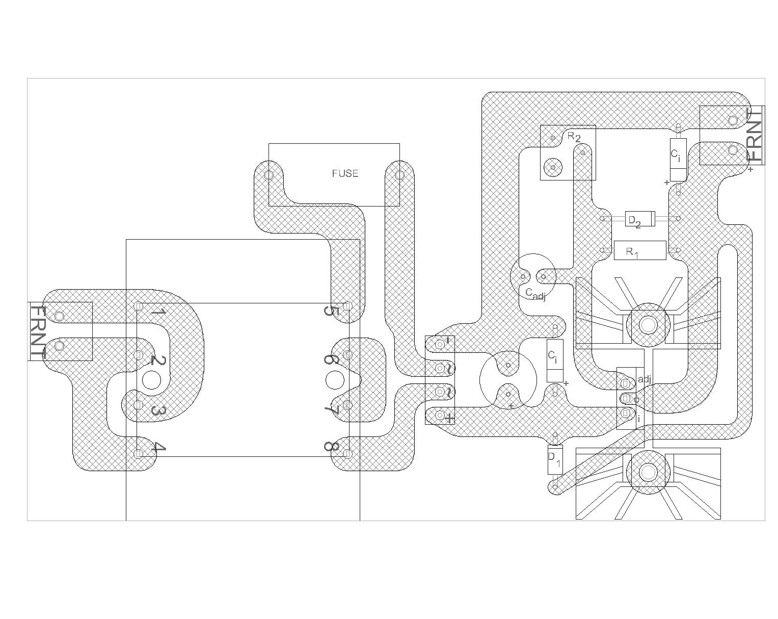

I'm working on a cross reference parts list for Mouser at Mouser.com. It's almost complete. I've attached it in it's current form and will update as I continue on it. Feel free to use it, but please keep in mind that I just based it on my rudimentary understanding of the parts needed. If you see something incorrect, please feel free to let us know. Also, I'm going to be providing alternate parts for connectors as I plan on putting this in an enclosure so some of the connectors will be chassis mount instead of board mount.

Does anyone have a replacement part for the WIMA caps on this board? In the US, these are VERY expensive!!
12 x $2.39 = $$$, considering the cost of the rest of the parts. I think they are 1/4th the price on that German website (though it seems they don't ship to US).
... Does anyone have a replacement part for the WIMA caps on this board? In the US, these are VERY expensive!!
Have you priced them at Mouser??
Yes -- $2.39/ea is the single piece cost. I should have checked the qty10 cost as per the BOM. That is $1.99/ea.
Still, it seems there is a very high markup compared to what they cost in Germany. If there were an alternate capacitor that could be used, it could knock $10-15 off of the BOM.
Get yourself some 1uF MKS/MKT, this is still enough. With 18k in series (+2k internal), you'll have:
1/2*pi*R*C -> 1/2*3.1415926*(18k+2k)*1uF = 7.96Hz low fu(-3dB)
(The original 2*4.7uF results in a 0.87Hz fu.. yeah, sure.. )
So you just need one of those:
MKS2C041001F00JC00 WIMA | Mouser
or
R82DC4100DQ60J Kemet | Mouser
or
R82DC4100AA60J Kemet | Mouser
(The last 2 are identical, just different package from Kemet.)
per channel, or use 2 in parallel.
I use 1uF X7R (flexcap) on our boards.
(Ceramics are not that bad, piezoelectric effects aka noise highly depends on size and layout)
Thanks! I agree that 1uF should be fine and using one of these instead will save $20 on the BOM cost.

For your PSU You could have forgone the LM317 and plumbed the rectified 12v right into the input. It has a LM1117 3.3v reg right there on the front end.
Also the input and output filter caps in the digikey cart I posted aren't the ideal items. And the RCA's are too short so you have to trim and modify the body a bit. They used a 18mm deep RCA, most i've seen so far are ~10. So be aware.
