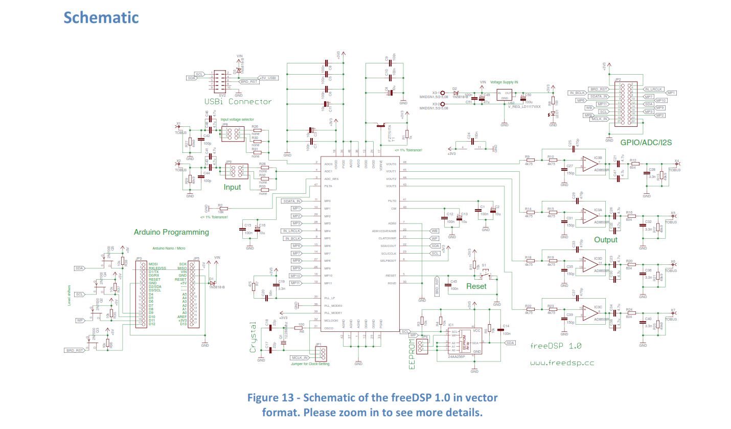

Hi erotavlas,
since I wasn't able to locate hifiberry minidsp schematics, I can't comment on differences. From what I know, you can program freeDSP from arduino, or from RPi - via I2C bus. By program I mean copy your DSP settings to MiniDSP EEPROM. Since you design filters in SigmaStudio, you need windows computer to run SigmaStudio. Then you can upload your design to freeDSP via RPi.
Regarding soldering, I've received my board with SMD parts soldered, but SMD soldering is not that complicated, give it a try on some spare board.
The arduino needed to program the FreeDSP is a $10 part. And the Analog devices USBi looks to have some "alternative"s out there by now.
The Sigma Studio dsp front end is very nice to use and makes setting these critters up a piece of cake. People are doing very complicated systems with that front end - check out the SS user forums.

Has anyone here worked out the details of changing setpoints in 'real time' via I2C using the onboard Arduino NANO processor? I am about to jump into that and would like to save some time. I would appreciate someone sharing if they've already worked out the details.

Hey,
if you take a look at the data sheet of ADAU1701, this is definitely possible, control the whole DSP via i2c.
But when you take a look at the schematic, the freeDSP is wired to be in "self boot"-mode, so it will always load it's program from the EEPROM on startup.
I'm not Sure if you can still control it via i2c afterwards, didn't try it yet 🙂
best regards
Ludwig & Sebastian
ps: we still have some bare PCBs, remaining from our last order, if anyone is interested. (Only PCB, no other parts, nothing soldered)

Hey,
Supposed to work, as from the AD-EZ-forums and app.notes.
Correct. I know someone who actually does this with a miniDSP - they wait for some short time until the EEPROM data is loaded and then they take over via i2c.
