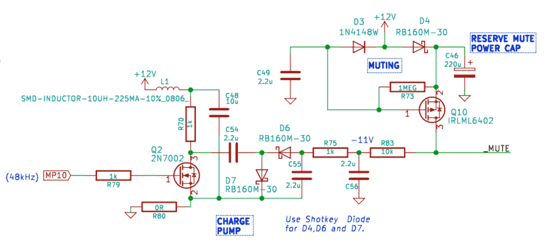

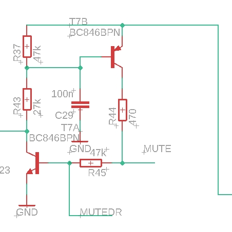

nice, here is an example of turn-on mute. the PNP emitter net is connected to the input voltage before the regulator. upon connection of the supply, the PNP -NPN pair acts as a triac and latches on, until the line MUTEDRIVE is pulled low.
the mutedrive net can be driven by the MPx port, when programmed as a timer delay when the DSP starts executing. monitoring the voltage across the regulator could also warn for turn-off and trigger the mute again.
for example by monitoring a voltage generated by a pnp transistor across the regulator and converted by the AUX adc..

New Muting Tr. Driver Circuit
Hi basreflex-San,
Thanks a lot.
Well, there are many ways to detect the power issues.
My DSP code is not so reliable, so I would go with HW solution rather than SW.
Additionally reason is keeping free limited ADAU1701HW(MPxx) resources .
Here is my current muting driver circuit.

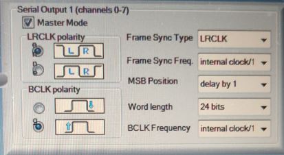

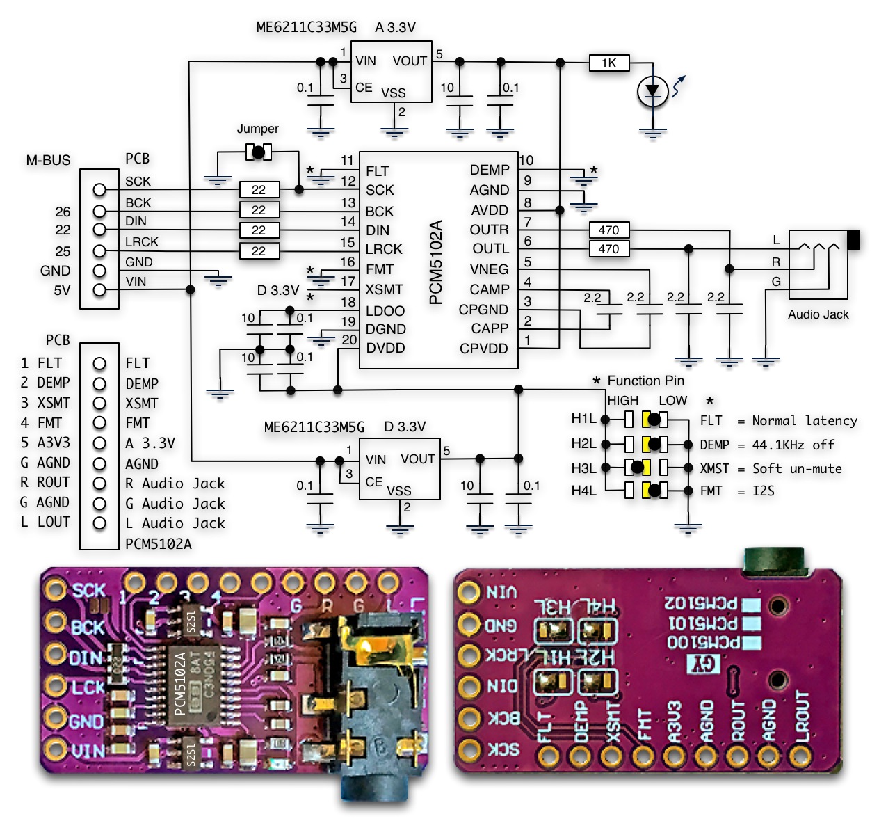

external DAC PCM5102A
Decided to extend the FreeDSP with an external DAC. Advantage is the increased voltage output capabilities and dynamic range of the PCM5102A.
Note that you have to change the polarity of the I2S bitclock.
The bitclock polarity is set from negative to positive.
Hi Piersma-San,
I agree with you, It's an important point using with embedded DAC with external DACs...
Well, most of ADAU1701 based FreeDSP board has phase inverted 0.9V output except my designs.
FreeDSP Classic SMD A/B and the FreeDSP Classic SMD A/B plus II has 2V phase corrected outputs.
They don't need to care those things.😀
