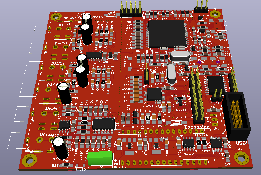

I am finishing next version of awdsp board, which will have two additional output channels instead of adc inputs, based on wm8740 Wolfson DACs. That will also allow for comparison between Wolfson and built in DACs, which are already quite good IMHO. With this board, one could drive 6 channel amp and pair of two way speakers with subs, which should be the shortest and most transparent path from digital material to analog reproduction.

Any renderings of the board?

I believe my board should be able to do up to 12 channels, but I'll have to doublecheck. 6 DACs are onboard, and the rest is available through expansion I2S pins.
My board is done, works great! I need to finish my sub now so that I can do some proper listening to a full blown stereo 3-way crossover. I also have rotary encoder volume control working on GPIO expansion ports. Programming works through USBi and Arduino Nano.
Next step is to do volume control, IR remote and LCD volume display with Arduino on already board.
