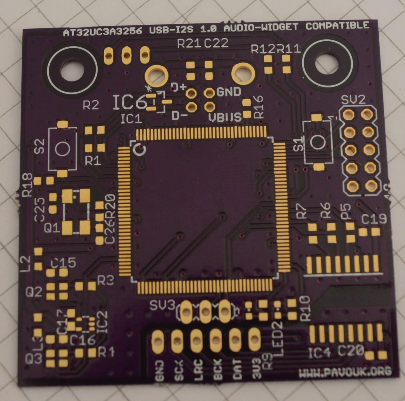

Thanks. I guess pavouk's site has the complete schematics that could work out of the box with FDSP:
http://www.pavouk.org/hw/audiosystem20/en_at32uc3a3256usbi2s.html#pcb
Yeah his schematic includes the clocks, clock switching, and clock divider functions onboard. That's a great link - thanks for sharing. 🙂

I sent the .brd file for that board to oshpark the other day.
Also ordered most of the parts from mouser.
Currently trying to get the software side working on my Linux pc. Not an expert, I learn as I go.
Atm, the sw doesn't compile/build all the way through, I'm trying to find the cause and hopefully fix it.
If unable to do so myself, I'll contact my cousin who works with Linux all day at his job.
Would be nice to have done it myself though.
I'll have atleast one of the PCB's over as I ordered 3pcs from osh. I went with the "double-thick-Cu-layers" 0.8mm PCB's.

Nice. Can't wait to hear about your experience with this. Are you doing to use a stencil for the solder paste or wing it? Or... drag solder?
Yes it's exciting to try this MCU-based solution 🙂
I have tried stencil once on QFN20 package, but I honestly prefer to apply solder paste manually, probably because I'm not that skilled at using stencils yet.

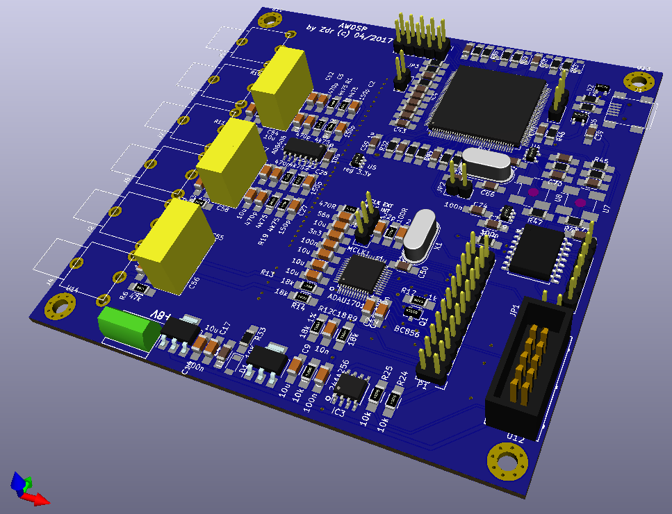

My Widget based FDSP board is almost finished 😉
Looking good 🙂
Using the ADAU1701? I've looked into doing something similar myself, don't think I'm good enough at using EDA's yet though, but use a newer/more powerful/flexible DSP IC.
I have two fully populated FreeDSP Classic boards that I haven't gotten around to putting to use yet so...a project for when I'm more adept at using KiCad and more read up on DSP in general.

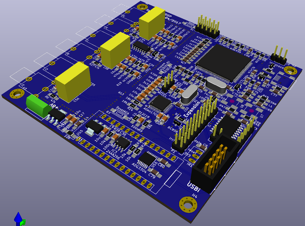

Here's the latest version, I added back Arduino Nano. Yes, it's ADAU1701. I am thinking about adding two more DACs, so that I can get 6 analog outputs from single ADAU1701.

I have to admit, you are way ahead of me (using an EDA etc) 🙂
What D/A's are you using?
I was thinking along the lines of ADAU1452, in fact I started a looong-term project using that in KiCad this morning.

Still no standalone DACs on board, just the ones inside ADAU1701. It's on a roadmap, but not sure if it will fit the 10x10cm pcb. It might be AD1955 or PCM1794.
