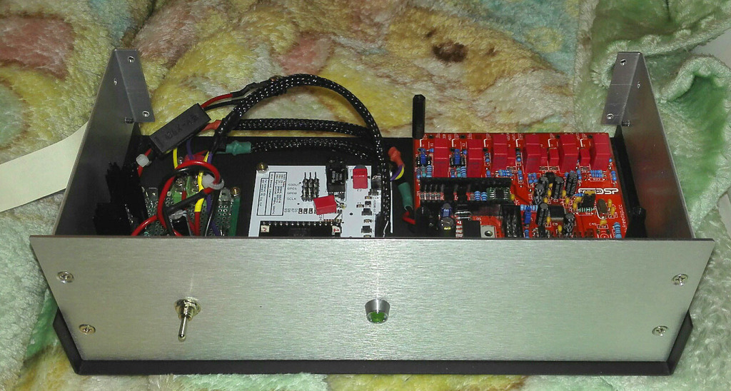

I've started putting the first FreeDSP board in to its enclosure.
I went with external PS (smps) for now as I don't know how much space will be left once all boards are in there.
The, ugly, perf board build is an AC or DC vreg set for +5Vdc. The white PCB is one of a few different versions of my WM8805 board, this one with datasheet input, apart from the PE65612.
I am not sure if I should use the PCB-mount RCA connectors or not. I'm leaning towards using "regular" panel mount connectors.
For the WM8805 SPDIF in, I'll use BNC.
I use one 1000uF before the vreg on the PS board, will that cause any issues with the smps?
IIRC, I've read that they are not always happy with large caps (I don't remember what the definition of large was in this case). I have two power supplies in mind, one 3A and one 5A, both 12Vdc.
The 3A one should be enough, if not I'll have to swap the vreg for an LT1083 based one (capable of 7A IIRC).

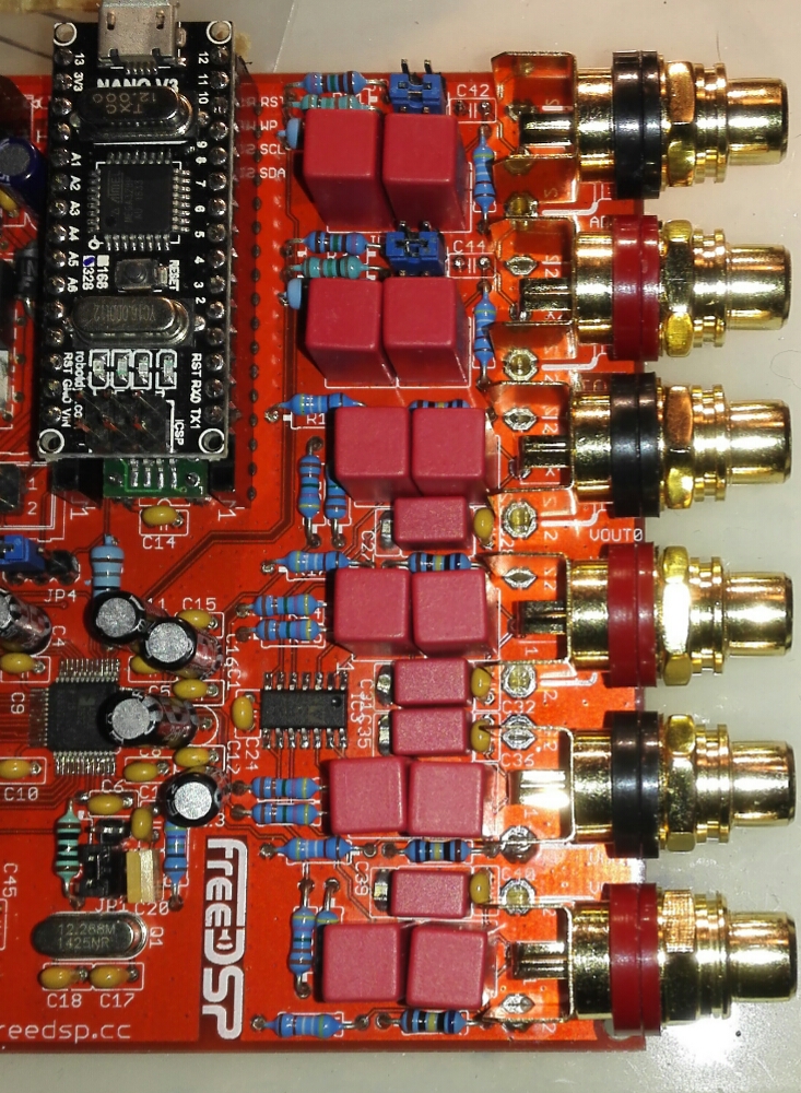

Got the second board done yesterday. The RCA jacks did have to be massaged gently with the Dremel to fit.

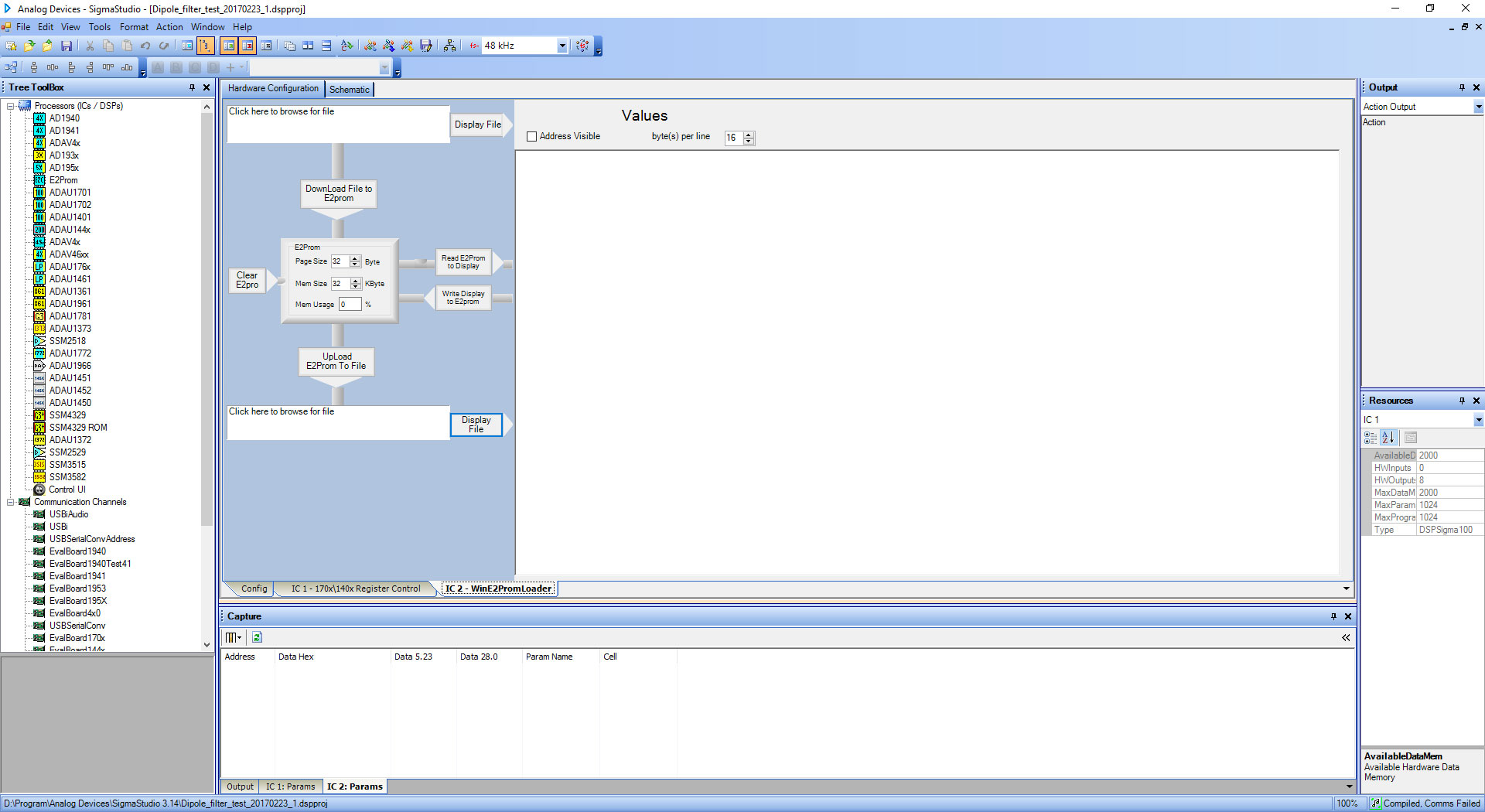

Compiled, Comms Failed?
So,
I finally got the thumb out and hooked the FreeUSBi and FreeDSP up to my main PC(only one I have running win).

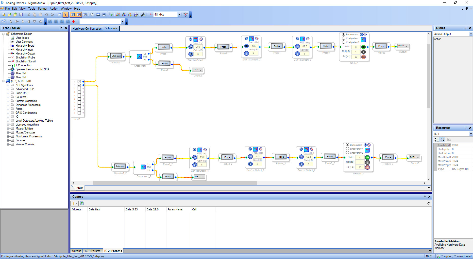

I did a first test schematic of a crossover that'll (hopefully) send an untouched signal to mid-highs of my dipole speakers and send a dipole compensated signal to the dipole woofers.
I intend to use external D/A's and WM8805 or maybe PCM2706 for I2S in, with the intentent to get better performance then with the onboard A/D and D/A, plus it would eliminate the A/D conversion completely.
But for this test-run I have it hooked up as I think it's supposed to be for using the onboard devices.
As I'm still waiting for some parts to finish building my WM-61A measuring mic/amp (directly as done on Mr. Linkwitz site), I was doing this as a test-run.

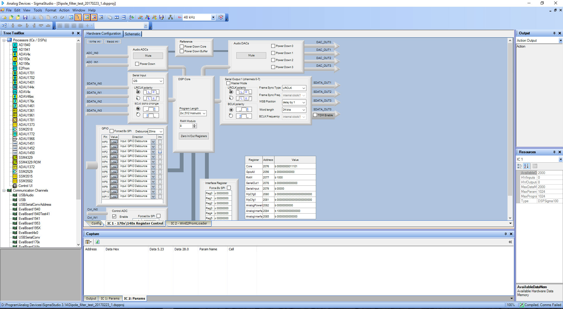

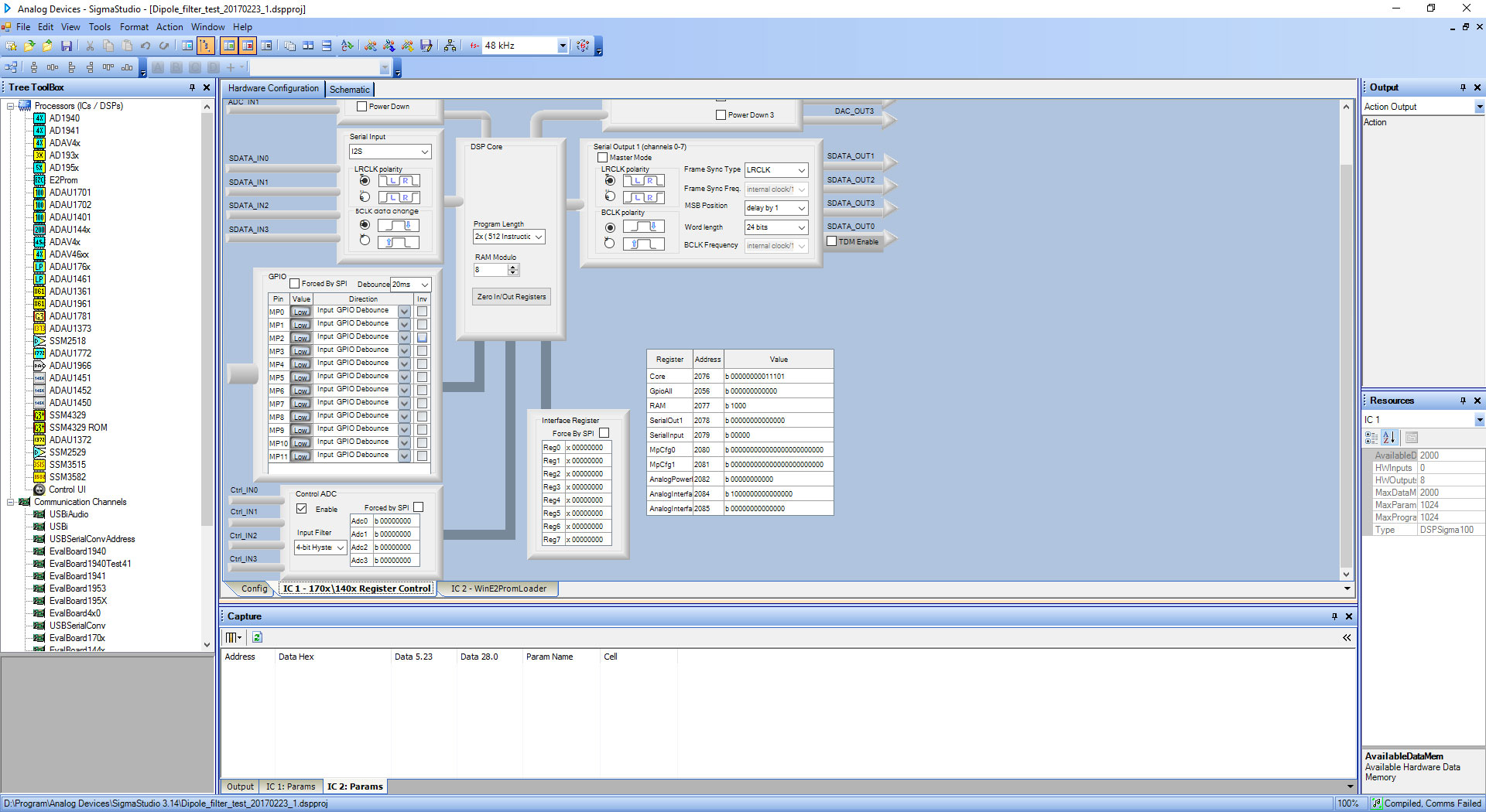

Now, all seem fine until I hit "Link Compile Download".
See attached pics.

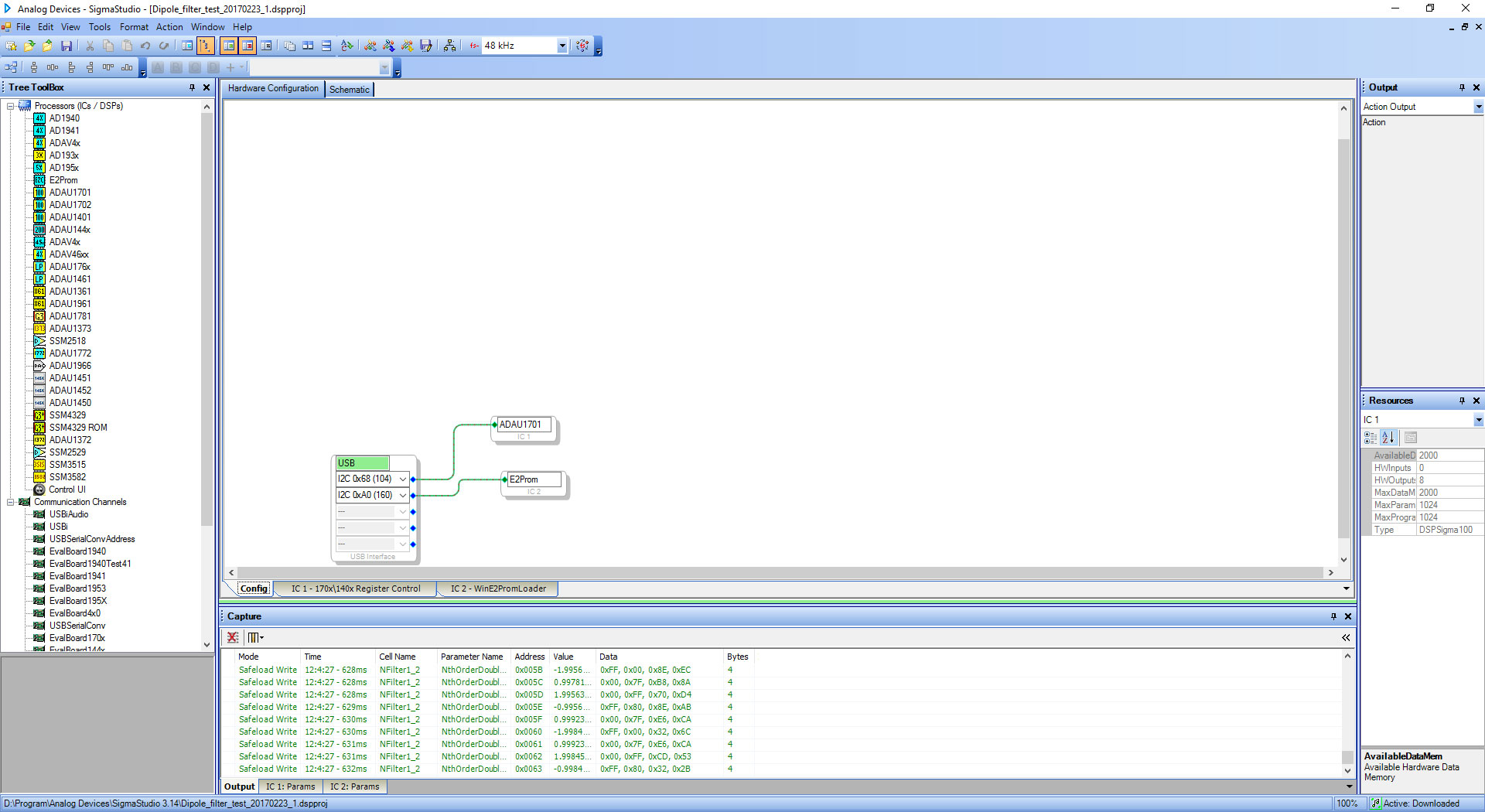

It seemed to work with my second FreeDSP board, Will have to look at the first one.
Attached image of second board in Sigma Studio after compiling it.
It now says "Active: Downloaded"
Well, that seem to have been a embarrasing rookie move on my part. I had only soldered in the "corner pins" of the IDC connector. I was waiting on the cable connectors and wanted to make sure they fit before doing the rest of the pins. Somehow I forgot all about that lol.
About to try again with a fully connected board lol
