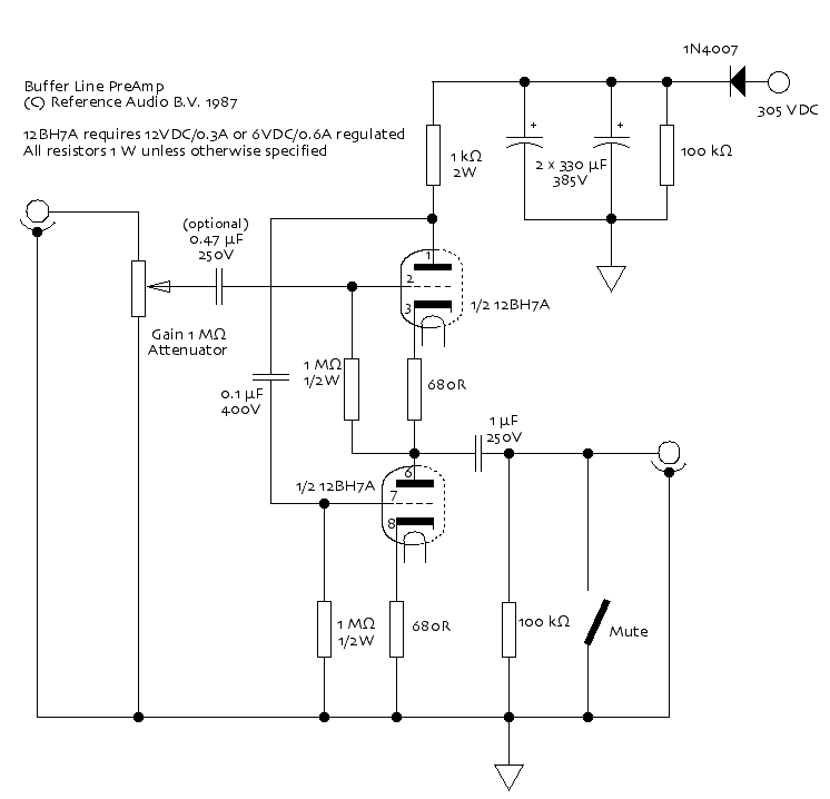

My version was built using the attached schematics. Duplicate power supplies. All built on one chassis with the preamp section physically separated. I have a large piece of copper sheet (~4X12") which is the star ground for all. I'm using Nichicon KX audio electrolytics for the 330uF caps. The .47uF in the PS I'm using a Clarity SA cap. The 1uF in the preamp is a Russian PIO cap. The 0.1uF in the preamp is two Russian teflon 0.22uF caps in series. Almost all of the resistors are Vischay-Dale military grade. I've rolled several different 6CW5's, 12AX7's, 12AU7(A)'s, and 12BH7A's. The tube rolling resulted in minor improvements here and there...but like I said the biggest tube rolling gain came from the Mullard gold plated 5651's. Lastly...I have a Goldpoint 500k attenuator using 0.1% IRC resistors. I recently purchased a bunch of 70uF, 22uF and 1uF film in oil caps...not sure if these are of use here? I tried to keep lead lengths as short and equal as possible...
Posts #324 and #327 have external and internal pics. If you have any further suggestions for improvement...I'm willing to try them!
You're just using the buffer + volcontrol, right?
How's the Goldpoint attenuator wired up? Ladder? PCB?
I admit to have no idea what the ruskie teflon caps sound like so we'll leave them in for the time being.
How about silver solid core wire? Any objection?
Tube sockets?
No electrolytics past the regs?

You're just using the buffer + volcontrol, right? CORRECT
How's the Goldpoint attenuator wired up? Ladder? PCB? I'M NOT SURE. IT'S NOT A LADDER OR SHUNT ACCORDING TO THEIR WEBSITE...BUT EACH STEP ADDS TO THE PREVIOUS RESISTOR VALUES. AND THERE IS AN AUDIBLE CLICK...WHICH THEY SAY DOESN'T HAPPEN BECAUSE OF THE MAKE BEFORE BREAK.
I admit to have no idea what the ruskie teflon caps sound like so we'll leave them in for the time being. THESE SOUND EXCELLENT FOR THE MONEY.. UNFORTUNATELY, I HAVEN'T SEEN ANYONE COMPARE THEM TO THE HIGH DOLLAR TYPES.
How about silver solid core wire? Any objection? ACTUALLY, I USED ALL MILITARY GRADE SILVER PLATED WIRE.
Tube sockets? GOLD PLATED
No electrolytics past the regs? THE 2 330uF CAPS LEADING TO THE PLATE OF THE 12BH7A ARE THE ONLY ELECTROLYTICS AFTER THE REG.

First of all, that Goldpoint attenuator sound like a ladder type of some sorts.
Personally I'm more favourable to the voltage divider type where you just have two resistors in series with the signal at any given position.
Forget about military grade, they're OK for the military but that's about it.
ISo of using silver plated stuff which often sounds shrill and anemic you might want to try solid core silver wire. 0.6mm or 0.4mm should be fine.
Insulation isn't that important, PTFE or polyamide should do.
Solid core is what's important sonically.
As for the sockets, gold plating is secundary to having a good contact.

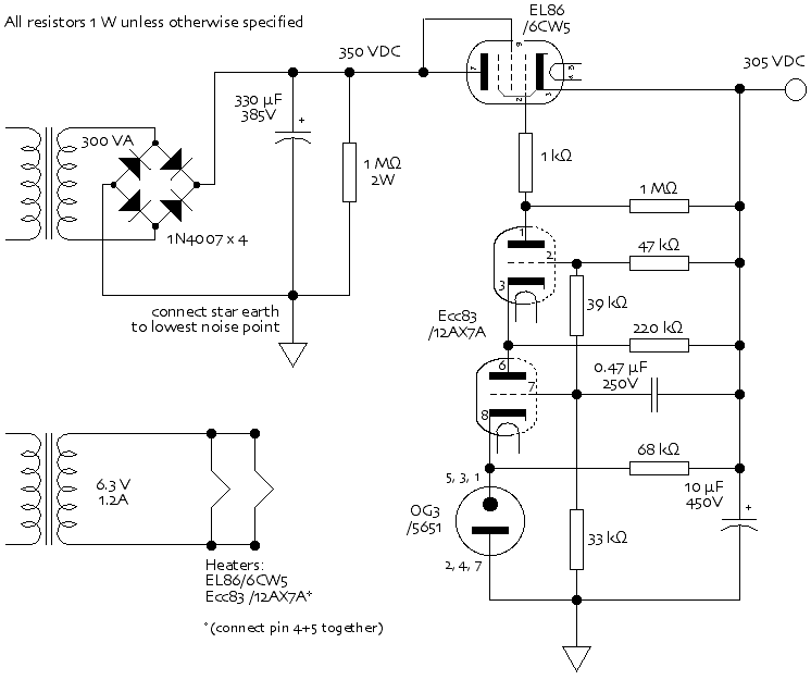

I just replaced the Amperex 0G3's with some Mullard gold pin 5651's. I'm noticing a significant improvement...is that possible? I would have thought rolling these tubes would have the least effect on sound quality.
I would be willing to bet the sonics, if indeed improved or changed from the rolling of this tube, are due to the difference in the actual voltage referenced across the OG3 type. Probably the entire B+ has changed ever so slightly which would have significant changes on the operating points of the preamp tubes. Just my take on it. I could not otherwise see how this could possibly afffect the sound of the preamp stage. Have you checked the B+ with each of the different types of tubes placed in this position? I would be very curious to know if the B+ is slightly different with each tube type.
It is interesting b/c I actually purchased one of each Amperex and Mullard OG3 about 5 mins before reading this post. I intended to try each of them to see if this made any adjustment on the B+ final voltage, which is my point above.
If anybody else could offer another explaination on how the OG3 tube rolling could affect the sonics of this preamp I would love to hear their take on this interesting observation.

Several other possibilities:
Differences in noise spectrum?
Effect of pulling tubes in and out on socket-to-pin contact integrity?
Effect of plating on contact integrity?
Propensity of VR tubes to have reference voltage wander?
Maybe there's no real difference?
The last will be controversial, but one must admit the possibility.

Oh, I certainly am willing to accept that there could be a sonic difference, in fact I would argue that in the case of a swap between tubes that had slightly (or even grossly) different reference voltages there would neccessarily be a sonic difference. Any significant change in the B+ would change the sonics for sure and I think a variance in reference voltages between the tubes would change the B+ some. In fact that is why I think the biggest audible difference would occur in swaping this tube when compared to others.
My arguement is that aside from a change in B+ due to the OG3 swap, I can't see how a sonic difference could be heard (not saying it can't, just that I can't figure out why)
Seems the aruguements you make are similar, for instance poor contact on the pins might alter the referencce voltage....

Well, there are two very nonideal properties of reference tubes that vary from tube to tube. First, they're noisy. The amount and nature of that noise could certainly cause variations in the noise on the power supply rail. The power supply rejection of that circuit is OK, but not outstanding... The second property is wander. If you monitor the voltage across a VR tube, it will make sudden jumps of a few volts in an erratic manner. Again, that varies from tube to tube in amount, severity, and frequency. VR tubes are pretty, but they are not very good references.
Change in operating conditions CAN be audible, but it's a pretty big leap to say that it's certainly audible. That's why it's important to qualify these analyses with the possibility that it's not a change in the sound, it's a change in the listener.

It would be interesting if you could confirm audible differences among the various brands of OG3s.
IME they all vary a little in that there's a difference in noise and reference voltage.
I did find sonic differences but only from OG3s that were suspect to begin with...
You should however be able to detect an audible difference between an OG3 and a 5651. They're not quite one and the same tube.
The exact voltage of the B+ for the line stage is very stable, changing various OG3s could make for a change of roughly 5VDC.
I doubt you'd hear it other than perhaps a slight imbalance between channels.
You could handpick OG3s for voltage stability although I can't say I've ever witnessed any sudden voltage jumps from the lot I had.
Either way, with that much capacitance sitting behind them, most voltage variations within the PS should remain invisible to the output stage.
Again, if you notice it happening, check the VR tubes as I do not consider this normal behaviour.

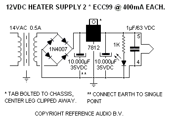

Use one of these...(a separate transformer is used, actually I used two, one for each channel)
I used the 14V transformer version.
Preamp is dead quiet.
Both of those heater supplies are overstressing the transformers because you are rectifying the AC and then trying to pull the rated current. The rated current is at rated voltage. Once you recitfy the voltage, you must derate current by a factor of 1/1.414 to remain within the manufacturer's power specifications.
In the case of the 12.6 1A transformer driving two 0.4A heaters you only have 1A/1.414 = 0.707 A available for driving 0.8A load.
In the case of the 14V 0.5A transformer driving one 0.4A heater you only have 0.5A/1.414 = 0.3535A driving a 0.4A load.
I would recommend upgrading your transformers.
if i correctlly understood you the problem is this way:
i can connect in series those 6.3v 2.5a each ang get 12.6v and 2.5a
the producer says the current drawn by each 6h8c is 600ma (1.2a for 2 of them) and there still remains 1.3amps(this is if u use regulated ps for filament and cc)
if i`ll use ac i`ll connect each 6h8c to each of 6.3v 2.5a rail
you didn`t said how u use yours on cc or ca?
