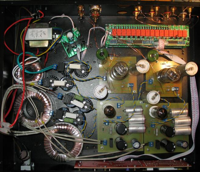

I built Frank's preamp, according to this schematic
using this power supply
http://www.the-planet.org/6GV8.html

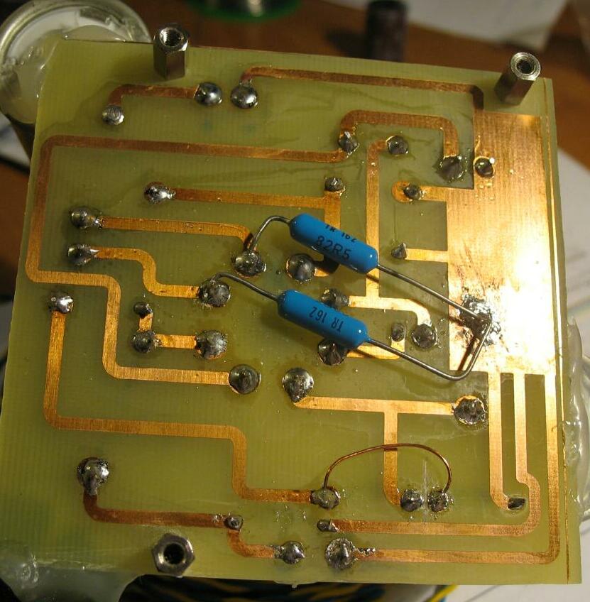

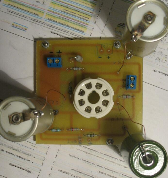

I used PCB for this preamp and also tried peer2peer version, but I have problems, both versions have hum, a lot of hum! Has anyone build it?

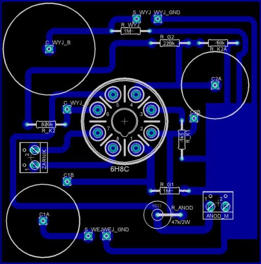

buble_corp said:I used PCB for this preamp and also tried peer2peer version, but I have problems, both versions have hum, a lot of hum! Has anyone build it?
I see you're using 6H8C. Did you use AC heaters? I'm not 100% sure, but I think AC is a no-no for that tube, it's given me tons of problems with hum on another project.

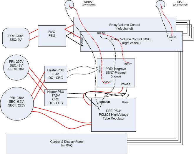

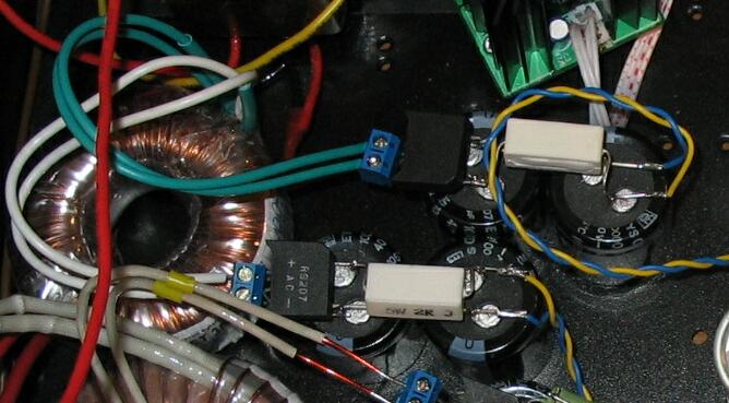

I'm still fighting with humm. Here it is a logical diagram of my pre. Currently, for debuging, I'm using one PSU and PRE board (single channel) as shown on diagram. I tried different ground setups, but without success. What is optimal grounding solution here?
Well, let's see. You have twisted your DC heater wires, but not the AC from the transformers. You have used toroids which will couple mains-borne noise rather well. You have DC on your heaters, but I'm not clear if you have a regulator. You have ECL85 as your HT regulator, but it might have a heater/cathode problem. No mention of how you've done your earthing.
There's plenty of scope for hum here. If you haven't already done so, start by making a star earth at the input of the 6SN7 boards, and make sure there are no loops. Check that the 6SN7 heaters are referenced to 0V (even better, +40V). Is it 50Hz hum (electromagnetic induction), 100Hz (power supply hum), slightly buzzy 100Hz (capacitor ripple currents where they shouldn't be), or very buzzy 100Hz (transformer saturation)?
-> EC8010
Thanks for reply! Heaters are referenced to B+ ground by 82Ohm resistors on both pre and regulator board. Heaters are DC and filtered with CRC (C=10,000uF) not regulated. I will try to move main ground point from tube regulator to 6SN7 preamp input in evening. Thanks for suggestions. There are some symptoms that suggest ground wiring problem, i.e. when I close my hand to "hot" wire between output of RVC(volume attenuator) and input of 6SN7 pre humm is increasing, when I touch it humm(buzz) is loud. Humm/buzz slightly decreases when I touch case.
Considering sound, I think it isn't humm it's rather buzz (like ground loop buzz) I think that I should check if there is any connection between ground and case.
