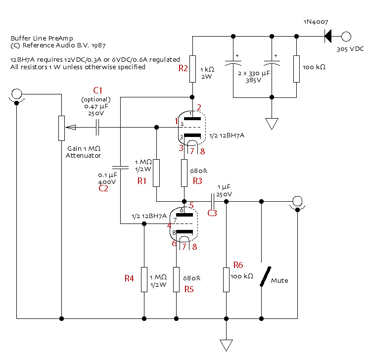

Do I understand correctly that the only problem can be resistor R1?
If there is no “mute” switch, the signal at the output (if the power is not turned on) will weaken by a factor of about 10 (the ratio of resistors R1/R6), right? But if resistor R1 is faulty and has a lower resistance, the signal will be stronger, correct? There is no other way for the signal (if the power is off), am I right? I just want to understand where else I could be wrong and where to look for the source of the problem.

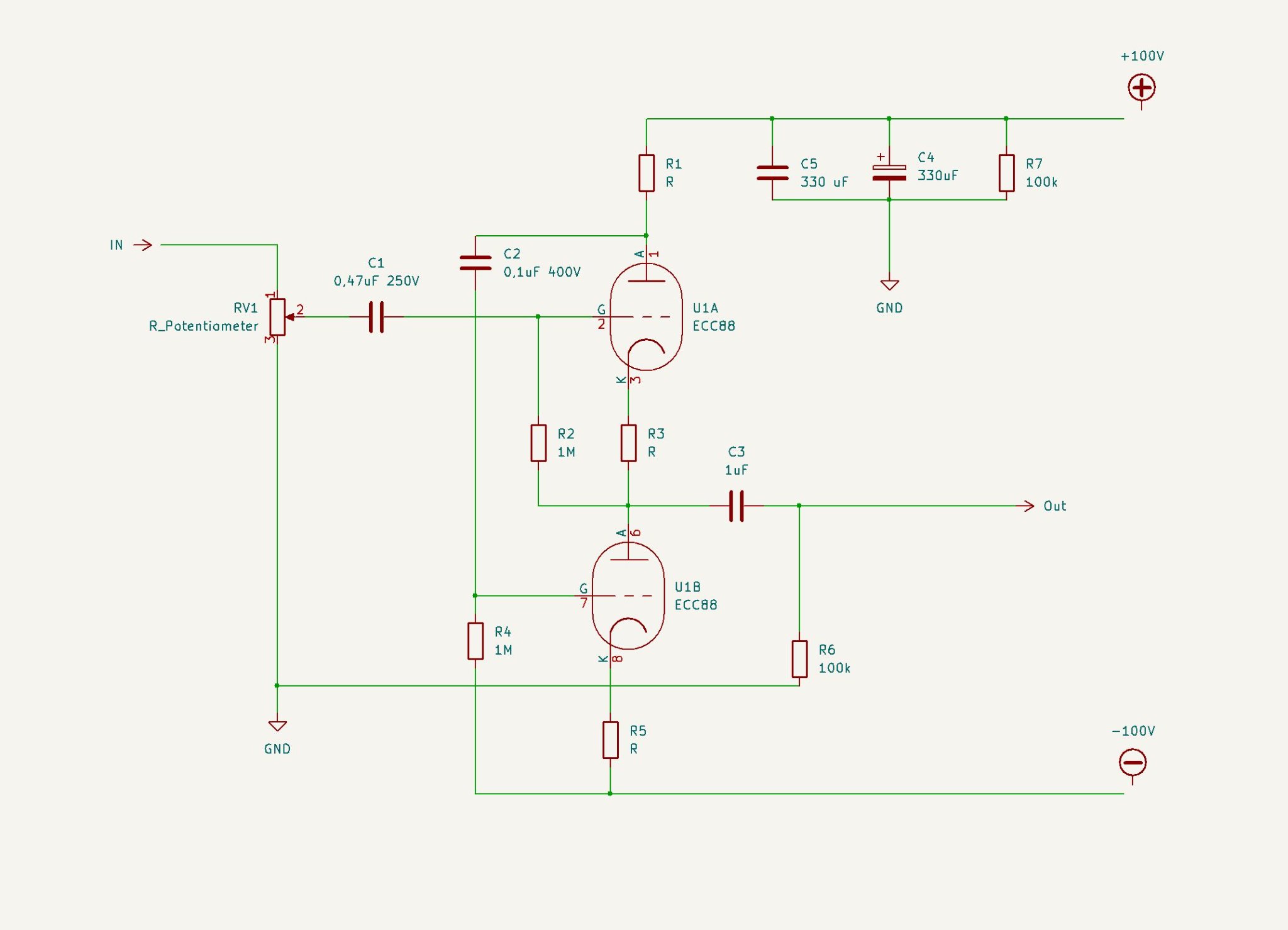

Dear Frank, I really like the sound of your preamp. My friend is also delighted with how it neatly ennobles the sound of his inexpensive DAC. So I want to try to make a second version as a buffer for his amplifier and use lower anode voltage and bi-polar power supply. I was guided by thoughts from here https://www.tubecad.com/2019/04/blog0462.htm. Could you please check if I have drawn your schematic correctly for the bi-polar variant?
At first glance the B+ should be roughly 200VDC.
By bi-polar you refer to using a B+ and B- rail I suppose.
Calculations should done to define the R values that are missing . I think formulas can be found on Tubecad's site.
