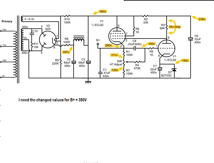

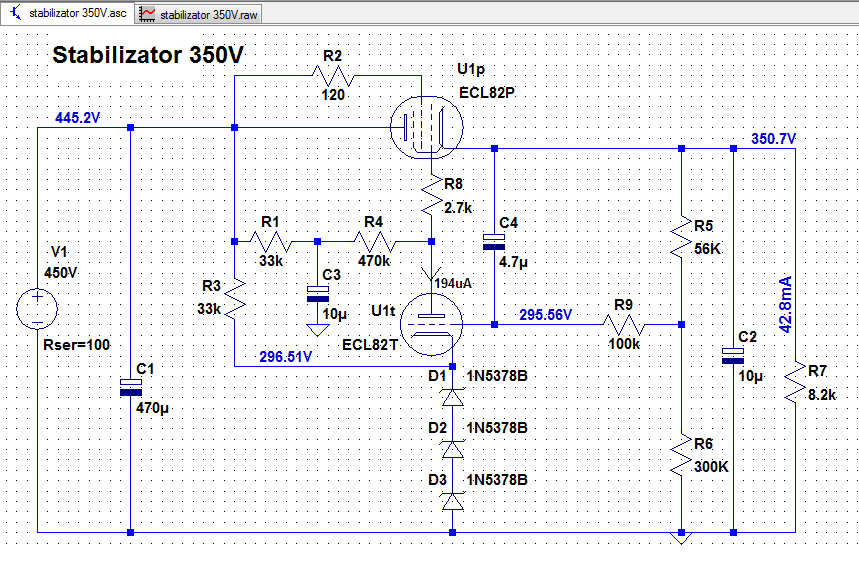

I hope I am not late on that thrad, tring to find the best PSU for my SRPP preamplifier (the anzai tiplogy)
At the moment I use a el86 driven by 1/2 ecc83 but I think ecl82 can do more and I need some advice.
I have several atempts for a decent ecl82 HT psu as follows:
A suitable PS.
I used one for each channel.
The 4K7 trimpot allows to set the output of the regulator to output 350VDC.
The heater and biasing scheme isn't included in the drawing.
Basically I'd use 2*15VAC, each of which bridge rectified, filtered and regulated using 7812s of sufficient current rating.
Cheers,😉
