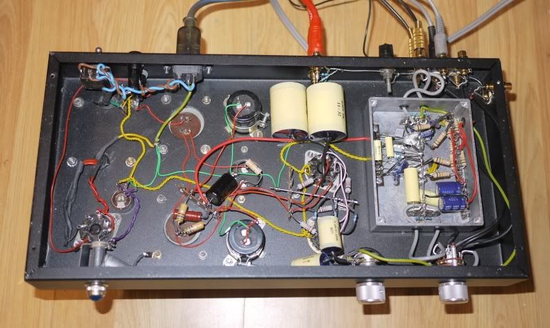

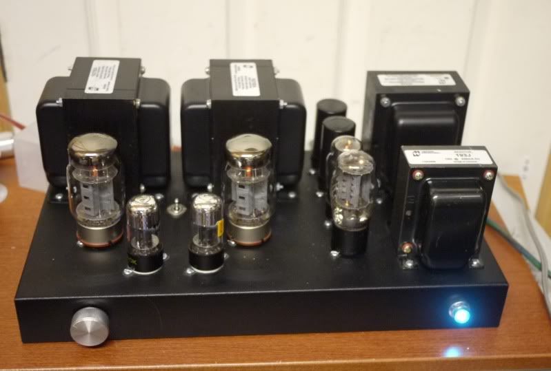

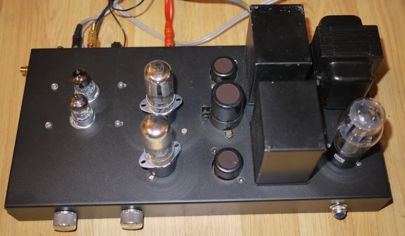

I have just built this for use with my home made stereo KT88 SE amp. see pic.
I have added this ECC88 phono stage to one input and I am amazed how good it sounds.
http://phonoclone.com/diy-pho3.html
I used AC heaters throughout and there is no hum at all. The phono stage is seperately screened which allowed me to route the heaters outside of the can.
The power transformer came from a 50's amp chassis I got off eBay and the two chokes came from an old regulated HT PSU.
I am using 7N7 valves with home made 6SN7 Octal to 7N7 Loctal adapters.
The side Phono sockets are now tape out( just fed via 2 x10k resistors from the top of the volume control). I have used these to record LPs on my Mac with excellent results.
My thanks to Frank for a great and simple design.

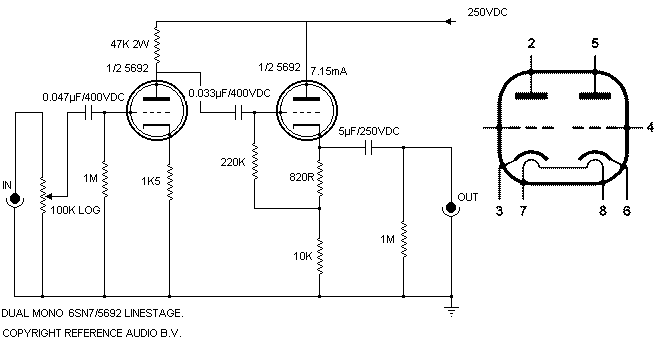

hello, I build this preamp. big problem. huge hum when input is disconnect. sound like oscillate. and gain way too high. already full volume with volume pot turned just a little from 0. and hum increase with volume pot. middle loudest. I build dc coupled 6sn7 version. help!

hello,
output level 4.4v. homebuilt dac.
this my first ever tube project. a lot could (and did) go wrong 😀
wiring seem ok. but maybe this wrong? I go straight from sshv2 to 2nd triode b+ on both. no post filtering. so pin 2 of both tubes connect to one point where salas shunt feed...
also, my b+ 190v.

I see two problems:
1/ The output of the DAC is way too healthy
2/ Using a B+ of 190VDC for a circuit designed for 250VDC is a sure way to ask for trouble.
I've no idea how many volts the Salas shunt reg drops but it should be able to output 250V given the correct input voltage.
Secondly, is there no way to take the output from the DAC at a lower amplification level?
Thirdly, with any regular/standard DAC output a simple volume control and a buffer is all you'll ever need.

hi frank,
I will go 250v and report back.
I can drop dac output yes. 🙂
even from defectiveness, it still best preamp I have ever ever hear 🙂 better than $5000 upwards stuff 😀

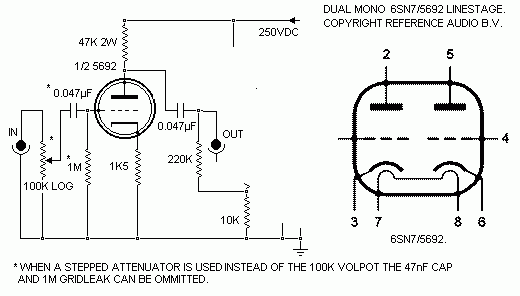

Sorry but I don't remember the exact figures. Maybe these were mentioned in the thread?
The first schematic is crippled in that you need a 1M resistor at the output and not what is shown in the drawing which is actually part of the second one.
Gain and especially output impedance of the second schematic will both be lower than the top one though.
There's also a version that direct couples the output of the first section of the valve to the second one which theoretically should sound slightly more transparent.
Cheers, 😉
