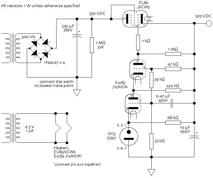

Is the power supply schematic correct? Where does the ECC83 pin 1 plate current go?

The one meg resistor. Yes, rather starved, which is often an interesting technique. The other tube has its own plate load as well as the stacked cathode load.
EL86/6CW5 is just an audio output pentode, like EL84/6BQ5 but lower impedance. I doubt if it is that critical. Line output valves (sweep tubes) are often used in PSUs.
Nope. Twisted, slow start heater, low noise, low distortion, low microphony and... All the 7XXX series of tubes were designed with audio use in mind.

You'd end up with a totally different regulator alltogether.
The EL86 plays a major part due to it's high perveance, the voltage reference tubes should not be changed either even though some type may strike up.
That diagram belongs to a different preamp, I think.
The phono preamp uses a Brimar ECC807 as a diff amp.
As for the 1M resistor, it's there for a reason. It makes the error amp last like for ever and still do its job....
Cheers, 😉
Is it possible to use something in place of the 6cw5 and 5651?
I have some Oc2 and Ob2's. I don't know what I could sub the 6CW5 with.
I wanted to use something I have on hand before buying something new.

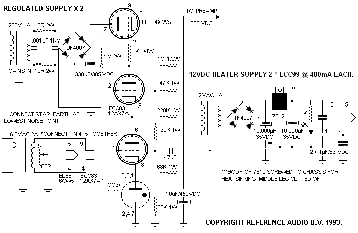

Is this the correct power supply for the tube phono preamp?
No, it is not. That is for a line preamp feeding a ECC99. (Variation a theme preamp for CD/Line use I think)
Cheers, 😉
