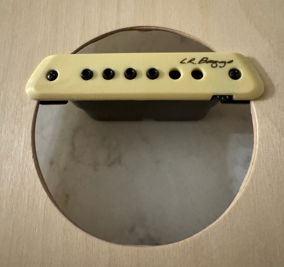

As you recently experienced the inverse distance effect on magnetic pickup proximity to the strings, you should understand it's effect on the microphone better now. Since your loudspeaker exit is so much closer than a PA loudspeaker or monitor, and it's frequency response is quite peaky, gain before feedback is limited.
That said, the "Silo" mic housing design and parametric EQ certainly could improve your FHAG gain before feedback.

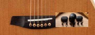

The AEG-1's two "HiFi" peel and stick transducers are located on the bridge plate under the bridge, on either side of the "Silo" microphone. Piezo transducers don't use magnets.Is the Baggs pickup system all under the saddle and soundboard? If so, it shouldnt care about strings' effect on magnetic fields.
There are no magnetic pickups in the AEG-1 to effect strings in any way.
Yep, no problem for nylon strings if you like them, they have a nice tone.
JJ you may want to get more used to a steel string guitar. It rocks way more, and has way more power, just acoustically, but that is just my personal preference!
Art , have you ever experienced any issues with this type of piezo losing mounting strength due to the peel and stick design?
The mic and magnetic pickups will require separate equalization, and the mic won't add much positive to the horn sound, since your horns don't do much above ~2kHz.I am very interested in trying his mic, especially with my mag pickups closer, boy are they rocking, I would love to experiment with a mic and mag combo.
Baggs' M1 humbucking magnetic pickup has adjustable pole pieces, which would help balance string output compared to what you are using now.

No experience with taping pickups since the 1990's with the Barcus Berry "C-ducer", which didn't stick well after a few install/removal cycles. Should have got new tape for it after each piano installation, but being ignorant rock and roll heathens, we just used gaffer's tape.Art , have you ever experienced any issues with this type of piezo losing mounting strength due to the peel and stick design?
https://forum.lrbaggs.com/forum/main-category/main-forum/1004-adhesive-problems-with-lyric
Not surprisingly, sounds like the 3M 4952 tape sticks better to a filled, smooth surface.

Holy ****, I did not see the M1A has adjustable poles before, just bought it!

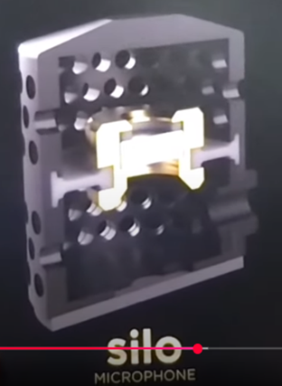

Specifically, "mounted in a special housing that places the mic capsule a mere three millimeters from the bridge plate’s surface, the mic is designed to sense only the sound coming from the top of the guitar. The Tru-Mic is designed to cancel reflections from the guitar’s back. ... Much of the Lyric’s success is due to its patent-pending preamp technology. Built into an endpin-mounted circuit board and powered by a nine-volt battery, the design uses specific preset EQ curves and frequency-specific compression and limiting to eliminate problem areas that often plague internal mics."
That's a lot. The "Anthem" is similar, except it combines the output of an ordinary saddle piezo - but only for frequencies below 250 Hz. Who know's what else specific preset EQ curves and frequency-specific compression he's got going on in that one.
Then, from his Silo mic description "Leveraging our acclaimed TRU•MIC technology, Silo employs a new microphone capsule and tuned suspension for enhanced ambience and dimension. It excels in providing isolation and feedback resistance". And, who knows what electronic tuning he's got going along with that one in addition to the "tuned suspension".
So "one does not simply" stick an electret microphone inside a guitar, clamped to the preamp box via a little gooseneck. I'd be inclined to trust Bagg's designs as not having feedback problems, as one would expect from just "a microphone". You'll pay him for that, of course, but I'd expect his designs to work much, much better than the usual dregs.
Looking at the Silo construction and reading it's leveraged from the TRU•MIC, which is arranged to cancel sound from inside the guitar that's not soundboard sound, I'll guess he's got two back to back capsules wired out of phase, an operating principle sorta like the old Grateful Dead wall of sound mics, just from the symmetry of it. Plus whatever electronic tuning on each, plus the tuned mechanical suspension.
From my own recent experience attempting to mic the outside soundboard of a guitar via a guitar attached microphone the "tuned suspension" part makes or breaks the whole idea. In other words, you dont simply attach a mic capsule hard and fast to the side of the guitar and expect it to sound anything like if it was held as close, but on a separate floor referenced mic stand. Where you perform like your guitar is held in a vise...

Looking at the Silo Reflection Cancelling Boundary Microphone's construction and patent, I'd be inclined to think it is a single capsule, tuned by the housing inlets and the shape of the top and bottom of the Silo.Looking at the Silo construction and reading it's leveraged from the TRU•MIC, which is arranged to cancel sound from inside the guitar that's not soundboard sound, I'll guess he's got two back to back capsules wired out of phase, an operating principle sorta like the old Grateful Dead wall of sound mics, just from the symmetry of it. Plus whatever electronic tuning on each, plus the tuned mechanical suspension.
The response of the RCBM without the compensating electronics would be unacceptable.
https://patentimages.storage.googleapis.com/fe/40/26/77b5488e6ae61c/US8989399.pdf
Using a pair of reversed polarity omni microphones (as the Dead used) in the central position of the Silo would cancel virtually all the good and bad sound present within the guitar.
As Baggs patent says:
"When an RCBM is used in an acoustic guitar, a close
proximity between the microphone capsule and the bridge
plate area of the acoustic guitar energizes the microphone
strongly enabling a very high Sound pressure level to be used
in live stage environments. The cancellation of reflections by
the RCBM eliminates the honky boxy sound typical of inter
nal microphones, because the boxy sound which typically
inhabits the 400 Hz-1.5 kHz range is significantly reduced.
Therefore, the frequency range of the microphone can be
extended downward into this range, greatly enhancing the
realism of the sound. The use of an RCBM in this manner
nicely mimics the response of a studio microphone placed in
the traditional recording manner outside of an instrument,
such as an acoustic guitar."

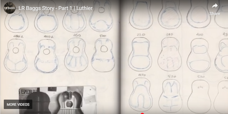

He knows inside out what works starting with his modal analysis of them:
