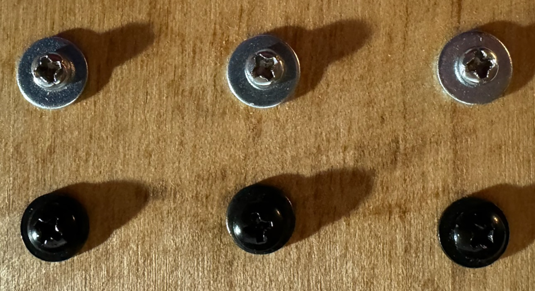

I think black screws look better than stainless steel, but still dicey at best!

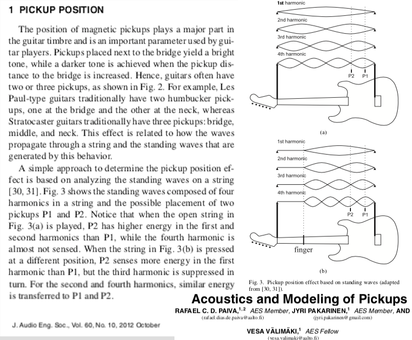

Piezos pick up the sound of the wood resonance, obviously an important part of the "acoustic sound", and is preferred by most players of amplified acoustic instruments who want that sound but need more gain before feedback than a microphone can provide. The piezo pickup needs proper placement, equalization and impedance matching/buffering to sound like a real acoustic instrument, so is more difficult (takes more skill and $$) to implement than a magnetic pickup.Ever since Art turned me on to the Helpinstill piano magnetic pickup, and I actually heard it live on a grand piano, I am a magnetic pickup man for sure. My only beef is if it starts to sound less acoustic, and more electric. I will try tonight, with two of them. I would absolutely love to ditch the piezo pickup, I can't stand those damn things. I know they have their place, but everybody I talk to uses them because the need to, not because they like them.
Magnetic pickups pick up the sound of the string at their specific placement, the harmonics (overtones) they pick up determined by that placement. The placement is as important as the pickup type. The material used to make the instrument has little effect on what the magnetic pickup picks up.
The reason a Les Paul bridge pickup sounds more "beefy" than an SG is simply because it is located closer to the 22nd fret- the double cutaway of the SG requires it to be located further from the neck and closer to the bridge.
Your sound hole mounted magnetic pickups limit their placement to what I would consider non-optimal positions for the "best" sound, as the nearer to the bridge, the more attenuated the first harmonic (the fundamental note) becomes.
If you support the pickup above the strings and move it back and fourth in relation to the bridge you will probably find you prefer the more mellow and balanced tone with it as close to the fretboard as possible, while the closer to the bridge the more "twangy" the sound is. The usual electric guitar two pickup placement can optimize between the two, while your sound hole placement limits the harmonic range available.
Art

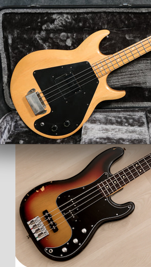

I remember when it came out. My friend, an avid P-bass player and much better musician than me, poo-poo'd the idea...

The moving pickup idea is good, but compared to the Precision's staggered split neck pickup and bridge pickup combo, offered less harmonic diversity.I remember when it came out. My friend, an avid P-bass player and much better musician than me, poo-poo'd the idea...

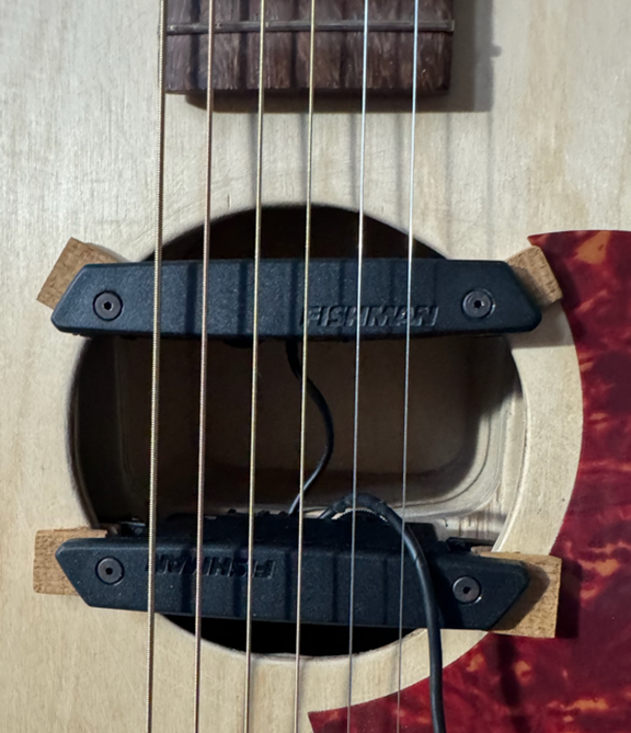

Moving the pickup closer to the strings improves the signal to noise ratio considerably- an inverse square relationship.Right now my pickups are too far away from the strings, so moving closer to the strings will provide even more power, at a lower amp volume setting.
You should be able to shim the pickup closer to the strings, might need longer mounting screws.
Yeah closer to strings will be a great experiment for now. Screws are an unusual size: #4-48, but I found some 1/4" longer, so got lucky. Plus I checked my Cedar I bought some time ago, not quarter sawn, can't use for a soundboard, will need to buy something else.

I have been thinking about moving the pickups closer to the strings for some time. They were .340" away from pickup to bottom of low E string, too far.
I cut that in half with shims and longer screws, now they are .170" away from pickup to bottom of low E string.
I am playing on volume 7, and getting the same general results (by ear) with previous volume on 9. Sounds wonderful, with just one pickup, even compared to a mag and piezo together.

The shims are pretty crude, but a start. More power at less volume, cleaner sound, more headroom. Tomorrow I will crank it up even further, to see what happens!

Art - talk about more "twangy" as you get closer to the bridge, man you are not kidding. I used two pickups as shown above, and the pickup only 2-3/8" closer to the bride is well on its way to "twangy town", I can't believe how much different they sound. Of course I love the pickup further from the bridge with a beautiful warm sound.
Now I am thinking: cut two frets off the fingerboard, and put two mag pickups as far away from the bridge as possible. Plus keep a piezo for many options.
I mean really, my guitar was screaming with power when I used the new mag by itself, or with a second mag, or with the piezo, GAME CHANGER!
