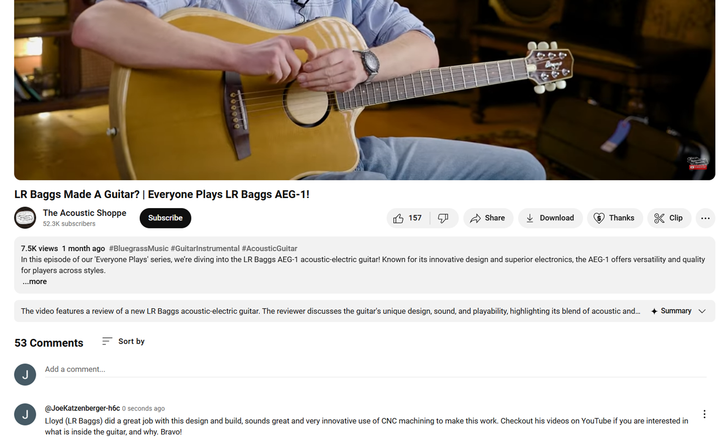

So Lloyd was killing it even back then, showing Martin (probably with racks of electronics) a thing or two, sweet. I just bought the LR Baggs HiFi Duet pickup system also. Testing will happen, can it be done on my guitar?? BTW there is new YouTube video from NAMM this week with LR Baggs company interviews. I really wish they would stop calling that beautiful body plywood, just asking for ridicule from people that might not fully understand. Engineered Lamination!

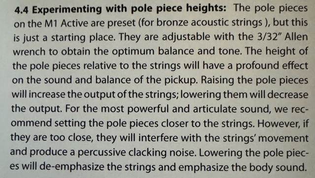

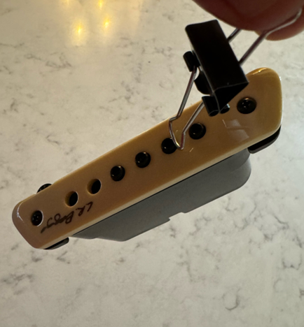

The LR Baggs M1 mag pickup has very strong magnets, can lift it with ease shown below, not sure about the tone yet. The Fishman magnets are not near as strong.

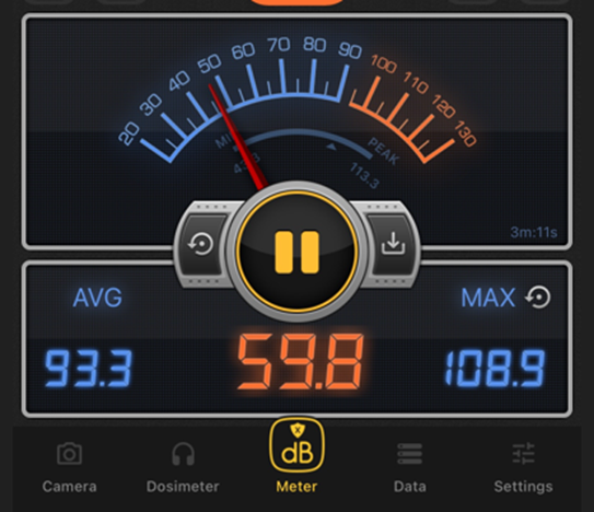

I like how Lloyd says the acoustic guitar is not meant to be played at 130 dB, you got that right. I can get maybe 115 dB max, and that is pretty much as loud as I can stand, even just from my guitar vs. a PA system. The dB shown below is from my iPhone inside the grand piano, banging out chords as hard as possible. 109 dB is plenty of power for a large room.
He says walking down Broadway in Nashville you can hear these loud (130 dB through PA?) acoustic guitars with under saddle Piezo's I believe, and they sound like chewing tinfoil. CORRECT! Man how can people live with that sound! I don't get it. I even hear this on the radio from a very popular station, the guitar sounds horrible.

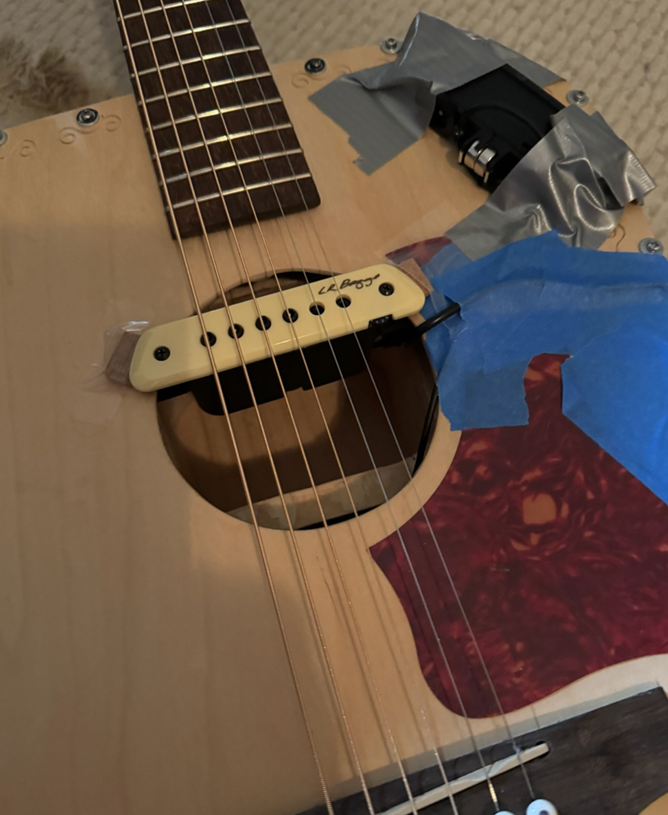

This is one fugly setup, but I don't have the time and want to test tonight!
This will be next and will require soundboard removal. Everything I get from L.R. Baggs is sturdy, looks easy to install and use, and I believe will be very effective. What's not to like?

So the L.R. Baggs M1 Active does not seem to be a good match for my guitar. Great pickup, I really like it, I think it is more of an issue with my guitar. My light yet strong soundboard really vibrates, so I think it is putting a little too much into the pickup, per below. It will feedback at a lower volume, and the warm tone is just not there. I need to adjust poles and try again. For some reason the Fishman mag closer to the strings sound is by far the best, so I am sticking with that for now, with the Fishman piezo.
