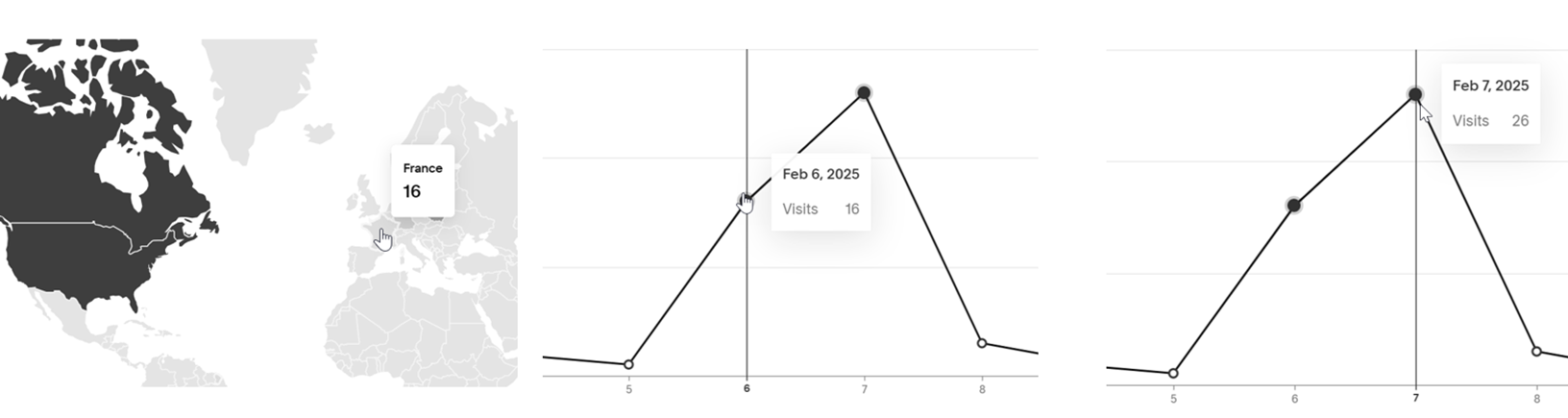

I usually get low daily visits on my Website/YouTube, but then spikes. (16) visits on 2-6-25 were all from Paris France, then (26) visits on 2-7-25 were all from Canada. Hoping AGM will give me many more spikes, can't hurt!

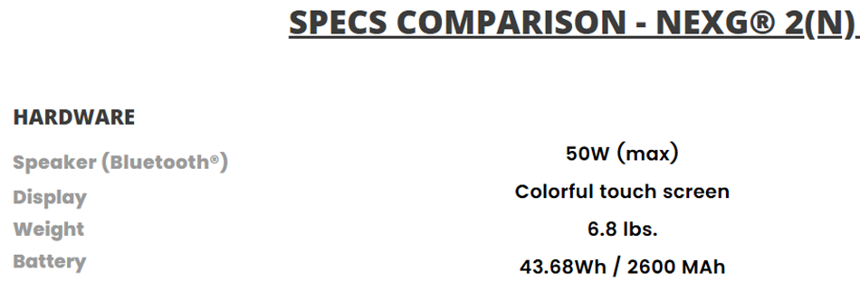

What impresses me the most, as you mentioned JJ, is the electronics, especially the battery in a small space. The damn thing costs less than the LR Baggs pickup, I may need to buy one and tear it apart, and yes this is one expensive hobby. I look at it as my alternative to buying a used Dodge Challenger 800 HP Hellcat!
That said, I am a sound before beauty guy every day of the week, and if they can get a great sound, more power to them. I will find some YouTube videos tonight. My guess is speakers in a small enclosure on an electric guitar (that is already a great sounding powerful instrument), nothing to write home about, but we shall see (hear).

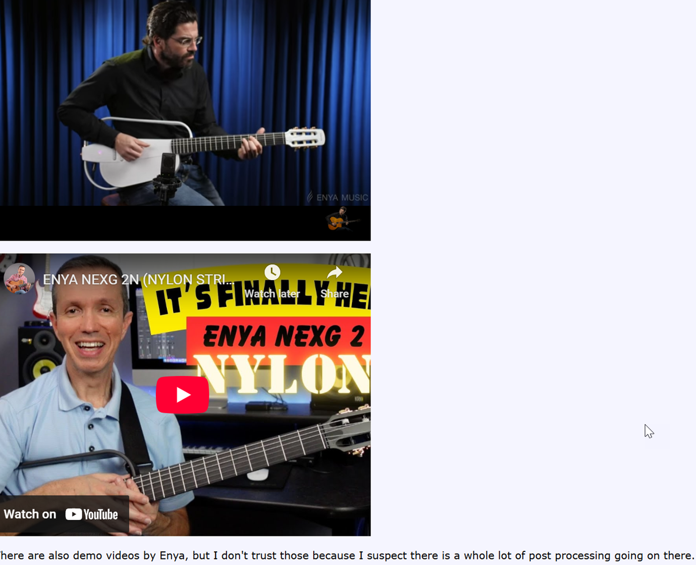

I agree with the comment at the bottom of this pic, and also people saying they sound more electric than acoustic. I thought the guy at the top playing "Over The Rainbow" on the white Enya sounded really great! I think it is encouraging to see innovative guitars like this. One of the down sides is if you are not electronic with this guitar, you get pretty much nothing, my guitar does not have that problem.
Another guy that commented on this thread had a huge list of nice guitars in his collection, all great guitars, and the LR Baggs AEG-1 was at the top of the list, likely most recent purchase. 😎 👍
Yeah. The way the guy plays in the bottom video makes me want to cry - not in this incarnation for me. Anyway, just wanted to draw your attention to their instrument and electronics within. Which I feel would be the frosting on the cake if the same were built into yours. It's entirely doable. Beware however, that "Asian" manufactury would love to steal your idea, but they'd make the horn section out of molded plastic with a carbon fiber top.
