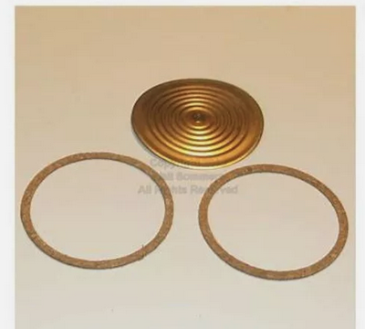

I had one in my late 20's, that had the oak box. I replaced the original mica diaphragm with a plastic one from the top of a Pringles can, for more "compliance". It worked as a "mod" to make it "sound better"; less honky.a wind-up Edison C-250 acoustic phonograph
Got it at a yard sale in Littleton, MA, long gone from my life today. I think I lost interest after I accidentally stepped on my Tommy Dorsey and his Clambake Seven disc, though none of the 21 selections I see on-line ring a bell for song titles.
It, and the few discs I had to play on it were a fun time back then - I even took it to a DEC audio meetup. I wonder how it would sound if you took two players, two of the same discs and flanged them for a phony stereo effect? I bet someone did it...
Funny, our C-250 playing speed limits were way off, they were supposed to be adjusted so the end stop was around 80 RPM, but I realized about 40 years later we had been playing records way faster than that.
Recordings of adult singers sounded about the pitch we kids could sing!
You'd have to be a really good mechanic and DJ to get two of those machines to sync up, spring drive, governor friction pad control..
With no electronics, the trade off between record surface noise and actual high frequency is pretty critical, no doubt the plastic top from a Pringles can would cut the top end and upper mid "honk".
From what I gather, in later iterations, the mica diaphragms were replaced with copper.
With the advances in diaphragm materials and surrounds, probably room for improvement!

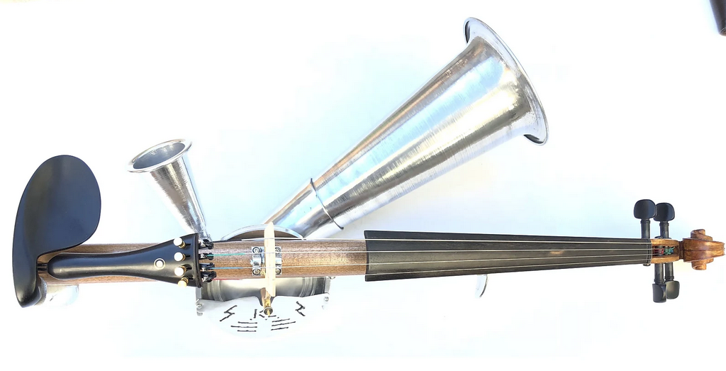

Over 100 years ago Stroh made acoustic horn violins and violas:
With modern diaphragms and materials using both folded and straight horns, a non-electric "Folded Horn Acoustic Guitar" could be made that could compete in volume to Joe's electric FHAG and weigh less in a similar sized instrument.

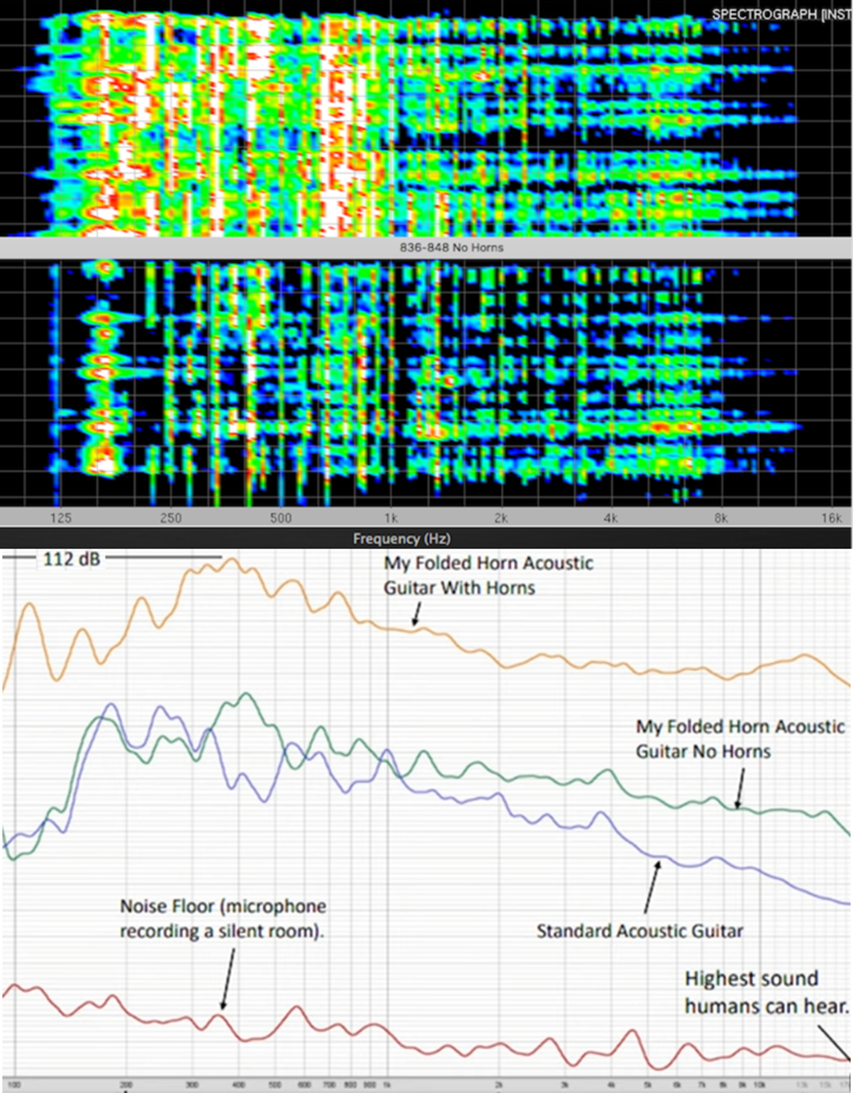

So Art, I think our data lines up pretty well, not perfect. My data gets stronger above 10k, which I do not trust, not sure what is happening there. I think yours is more accurate overall.
My harmonics do drop off as expected, but not as much as a standard acoustic guitar, which I find encouraging, and I can hear the brilliant but not tinny tone.
I like it when Casey is playing from 4:05-5:23, very balanced, wonderful strong low E sting bass, strong mids, and very nice sound up the fretboard and on string 1 and 2, love it. My playing can't come close to the Casey's, so I focus on his of course. Plus listen to Casey's playing in the background as I talk, no question brilliant highs that sound great.
Now this is with my Baltic Birch soundboard first guitar, an unusual soundboard material to say the least (except for Harps). I fully expect that my second guitar with a standard Sitka Spruce soundboard will sound even better, I hope!
Your screen captures of a single point in time while playing different guitars don't "line up" with the spectrograph of you playing approximately the same riffs with and without amplification.So Art, I think our data lines up pretty well, not perfect.
Yes, your FHAG appears to have more acoustically produced upper response than your Taylor.My harmonics do drop off as expected, but not as much as a standard acoustic guitar, which I find encouraging, and I can hear the brilliant but not tinny tone.
Casey has considerably more dynamic control than you, I don't hear the amp clipping when he's playing.I like it when Casey is playing from 4:05-5:23, very balanced...
Yes, your FHAG sounds good when the amp isn't clipping, but no question the horn output doesn't contribute to the brilliant highs that sound great.Plus listen to Casey's playing in the background as I talk, no question brilliant highs that sound great.
Adding a horn tweeter could reproduce the guitar's upper harmonics at a similar level to the horn amplification.
Using a softer Sitka Spruce soundboard will attenuate the higher frequencies and harmonics, reducing the "brilliant highs" your guitar produces acoustically.
Should sound "warmer" or "more dull", depending on your point of view and how much amplification is used.

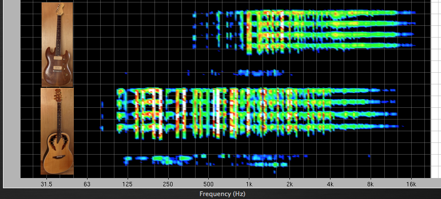

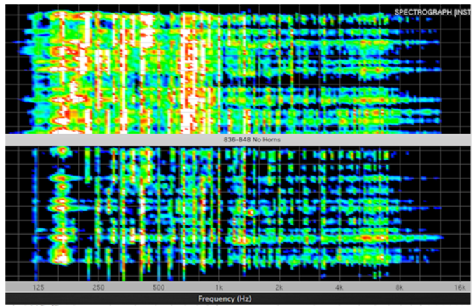

Here is a spectrograph of two guitars hanging on a wall ~ 2 meters from the mic, all 6 open strings strummed acoustically:
The upper solid body guitar (my own, built ~1974) has a walnut top backed with maple, above 4kHz it's harmonics are louder than the sitka spruce top Ovation Elite, but has very little fundamental output- "thin". The low E fundamental (82Hz) of the Ovation is ~ the level of the 10kHz harmonic.
A Honduran mahogany electric (with thinner strings) has less upper harmonic output than either the walnut or spruce:
Obviously, the electric guitars would need to be amplified to balance their fundamentals with their harmonics.

So Art, your spectrograph data is very intriguing, I need to dig into this in REW. I agree my horns are not putting out much above approx. 1k, but I am seeing about maybe 10-20% more.
Below 1k Wow, stunning! So how does this actually help my guitar sound very good and balanced? I have a theory, see next post - and JJ jump in if you want to brother!

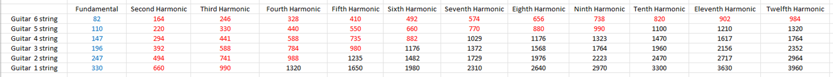

Even under 1,000 Hz I am getting half of the harmonics (red) up to the twelfth harmonic, and the others are not gone, just about 10-20% as mentioned before. I think this is a very nice way to get the sound that I love, a standard for me? Yes! Others? We shall see!
