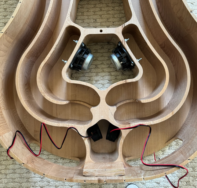

I will consider two tweeters in the horns, would not be difficult to do. If they work, great. If they **** up the tone, I will not be surprised!

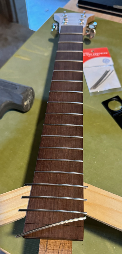

Finishing second guitar neck fretting, you can smell the Rosewood aroma even when you barely file down a sharp edge...

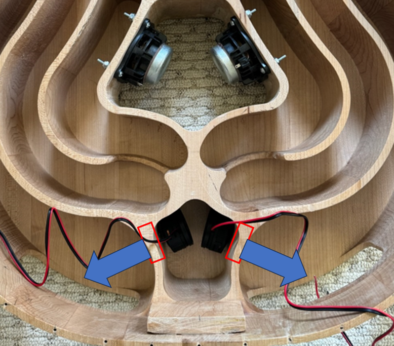

The nice thing about tweeters is you can fit the little bastards just about anywhere. Personally I think they will make the guitar too bright for me, but you never know, worth a try. 4 ohms, 35 watts RMS, 5k-20k...we shall see!
How about at the horn's end? That would keep the sound's phase alignment a little better with the original speakers. Of course, who knows what sound you'll get where depicted and it could be OK. Stranger things have happened in acoustics...The nice thing about tweeters is you can fit the little bastards just about anywhere.
Yes JJ, If it works I might mount with a through hole facing the horn end/mouth on each side, but need to test first, will be interesting to see how it sounds!

JJ - if the tweeters work, I am thinking about this type of mounting and through hole into the horn mouth...
Oh, got it now. Ideally, you'd want to compensate for the time delay between the drivers. That's "easily" done with modern electronics, but would require a separate amplifier for the tweeters, as the delayed signal to them would need its own channel.I am thinking about this type of mounting and through hole into the horn mouth...
Or, you can just connect them through a crossover (capacitor at minimum) to the same amp driving the main speakers and you...get what you get. Perhaps you and others hearing this guitars sound fall in love with the high frequencies "appearing" to be far "ahead" or "leading" the rest of the sound; I dunno. Anything can happen.
In a normal HiFi speaker, the opposite is often the case; the tweeter is kicked back in space and therefore "time" relative to the woofer.
The baffle can take a physical step back where the tweeter mounts, the board can be slanted backward or the high frequency driver of a horn is set backward from the woofer cone by the horn length, both mounted to the same baffle plane. You rarely see a speaker design where the tweeter is mounted on a stick, that juts out 5' into the room, in front of the woofer's baffle board, while driven by the same electrical signal origin. Again, that's HiFi - not a musical instrument in search of a unique tonal character.
