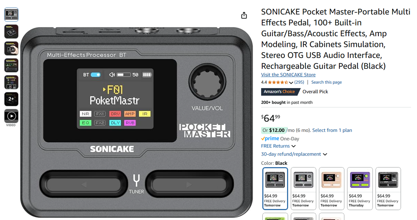

I cant say enough about the value of that Pocket Master device, for ~$50. Barely begun to explore; just been using its compressor effect and reverb on my voice. Some of the stuff I practice to, this thing has a better sounding reverb than the studio did for the original singer.I just got a "Sonicake" "Pocket Master". A ~$50 effects box for guitar; pickup in, stereo effects out. It can do a Tremolo in stereo; wonder what that would sound like through your two horns?

Also, the Pocket Master can do Cab IRs, with 5 user slots for IR effect. Hoping to make use of that one day to, well, I wont say just yet. You could use that function to play around with the sound of your horns, possibly making your guitar sound like the proverbial "anything" amp and speaker modelling can do.
I bought a second one. I'm actually going to use one for voice (compression and luscious ambient; I like "church") and one for guitar (compression and ambient and whatever else I can dial up that sounds good).I can see why you like it JJ, big bang for the bucks.
