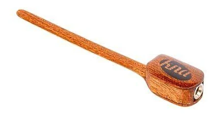

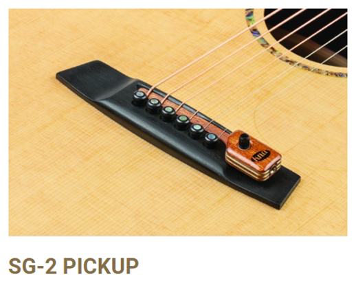

One guy had this tonight - pretty nice sound from his acoustic! I think its the SG-1 from KNA. Another way to skin the piezo cat.
That piezo looks pretty handy JJ, plus they have one with a volume control also:

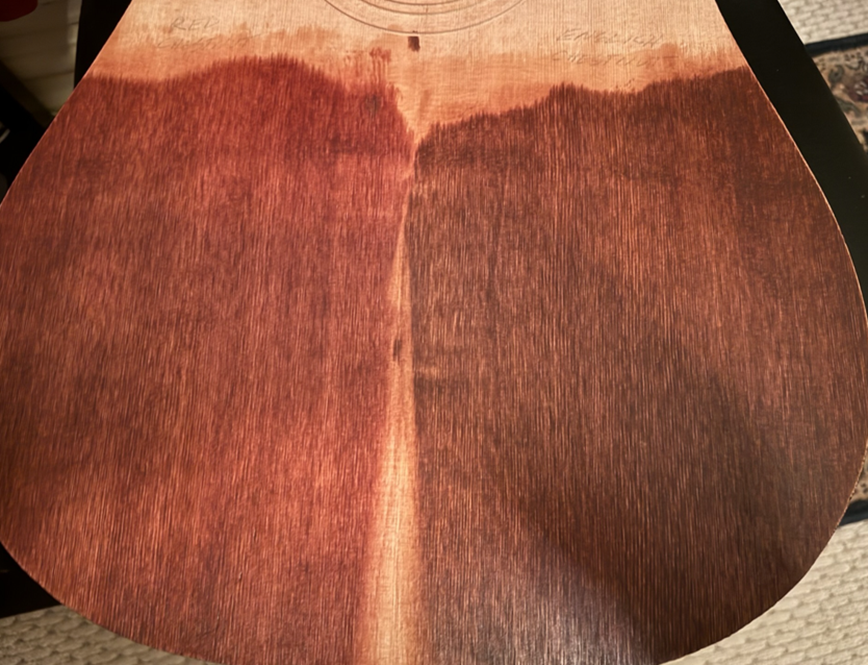

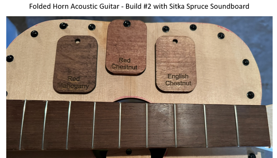

JJ- I have black screws and washers on my new Sitka Spruce soundboard, which will be stained (many options). I hope it looks better. What do you think? Still fugly? An improvement? Any comments on the stain options shown?
The Sitka Spruce soundboard tap test (installed on the body) is LOUD. I mean really loud compared to other tap tests on standard soundboards, and louder than the first Baltic Birch soundboard. Plus the tap tone is obviously deeper, not as bright.
The braces are not glued on, all cut from solid by hand, no CNC, man that took some time, but great fun in the shop! Plus it is still the light yet strong design. We shall see how it compares to the first Baltic Birch soundboard. Stay tuned!
