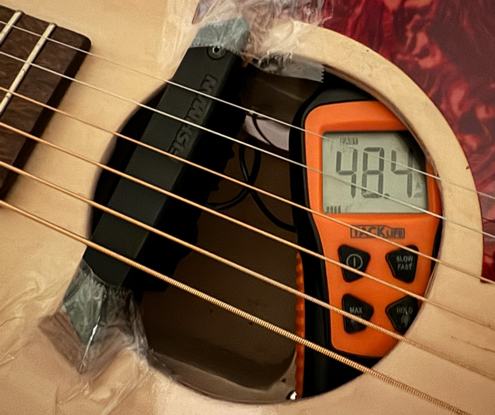

OK don't laugh at my crude setup below. Day off tomorrow, so I have time to experiment tonight.

JJ and Art:
Per above setup, I strummed my guitar at the same level ("medium") for horns off and horns on. Of course I would get different dB levels as I go, the meter was pretty much up and down by +/-10 dB depending on if it was directly during strum, or slightly after strum and sustaining.
That said, I focused on the max dB for both, so I have some consistent data:
Without horns max = 106 dB
With Horns max = 122 dB
One meter away would never sound this loud, with just a "medium" strum, so the dB meter in the guitar would be misleading by itself, but for an apples to apples comparison I think not bad. Thoughts?
A dB meter won't tell you anything regarding frequency content, other than the difference seen when weighting is changed from none to "A" or "C". "A" rolls off the response below 1kHz.JJ and Art - you guys have never let me down, thanks for all the good comments, I need to revisit my theory, I know I do not have enough evidence, just observation. I am going to tape a dB meter to the top of the chamber divider so I can see the output reading through the sound hole, that will tell a story with horns off and horns on.
Using REW's pink noise through the amp/speakers, you could get a baseline frequency and level at various position near the horn exit. Identify each, and save them.
Move the mic to other positions you hypothesize are contributing to the horn's output.
Then dampen the movement of the sound board by hand or with foam pillows to determine it's influence.
Cover the sound hole, etc.
Save each for comparison.
Any small air gap can leak sound waves directly through them.JJ- the chamber divider is screwed on with (12) screws, that way I can remove it easily.
Vibration you feel with your feet would probably be much lower than frequencies that contributes to guitar output.I can't image the chamber divider does not provide anything, it must, it is vibrating. I know this because back in the day (before my first guitar was complete) I would play a standard acoustic guitar through my horn body. I could literally stand on the chamber divider and body, and feel a pretty damn good amount of vibration through my feet.
Using pink noise, you can see the relative output in various locations.
Substituting a piezo transducer for the test mic, you could measure the wood vibrations at different locations independent of air transmission.
You have not used accurate measurements of the horn's output before, but they would be interesting to see.I am interested in this so I can understand of course, but I also want to use this for marketing, if I can prove what is happening, needs to be accurate.
Do you expect the 1/2" chamber divider is leaking much output from the horn channels?If I am not getting as much power from the chamber divider as I think, then maybe my horns are working better than I expected.
I still think "data" that varies by two orders of magnitude with the signal used to produce it is useless.Of course I would get different dB levels as I go, the meter was pretty much up and down by +/-10 dB depending on if it was directly during strum, or slightly after strum and sustaining.

Thank you for the good feedback Art, I still think seeing a higher dB level with the horns tells a story, not frequency data I agree, but the power is there, I can hear it, I knew it. I am finally going back to my second guitar build. I have been limping along on that one because we finally put our house on the market Saturday, moving back to Chicago. That was a good three months of repairs and updates on a big old house build in the 1880's, but still in mint condition.
A few weeks ago I had some time to fit my new Sitka spruce soundboard, and my neck to the body, and my custom nut, everything was going great. The neck was dead nuts on, but I put my hand on the headstock and felt it move, I was like what the **** is that? Found a crack from the bottom of the nut pocket into the neck. Wouldn't you know it, one of the few places I have a sharp corner in the wood. Rookie mistake, happened when I was fitting the nut with a tight press fit, then gradually into a slip fit, all on me. The F bombs were flying! 🤣 Thankfully I can repair it with glue and clamping. I actually saw a video of a guy that glued on a headstock that was completely snapped off the neck. That is pretty dicey!
Your comment about not using accurate data: I am not going into that again, we had this argument before, I just don't agree with you, let's leave it at that.

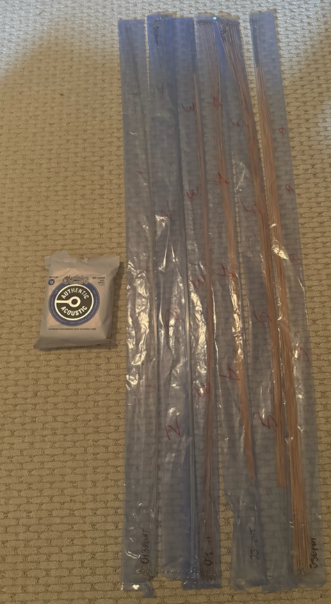

I say buy your strings in bulk, they are every bit as good, and much less expense. I have never had a problem with them. Especially important for people that like to change strings often, as I do. You just can't clean off the finger oil and sweat, degrades sound!
But, you didnt say where to get them. Are they Martins? Martin direct? Can you get any of their string "models" this way, or only the "Authentic Acoustics"?I say buy your strings in bulk, they are every bit as good, and much less expense.
JJ - I bought mine from JustStrings.com, pretty happy with them. I have seen reviews good and bad, so buyer beware. Shown below are (12) packs, but mine still have about (15) strings of each left, so I bet I bought approx. (25) in a pack, but I can' t find that many now.
I like Martin strings also, you can get these in bulk from Sweetwater. Plus I just saw the Ernie Ball Earthwood strings that John Mayer is backing this morning when I was browsing through AGM, looks interesting, I might try these. I am kind of a John Mayer nut, so that got my eye, boy is he one hell of a fantastic musician. Not only is he a great singer/songwriter, he plays a seriously mean guitar! No wonder chicks dig him!
