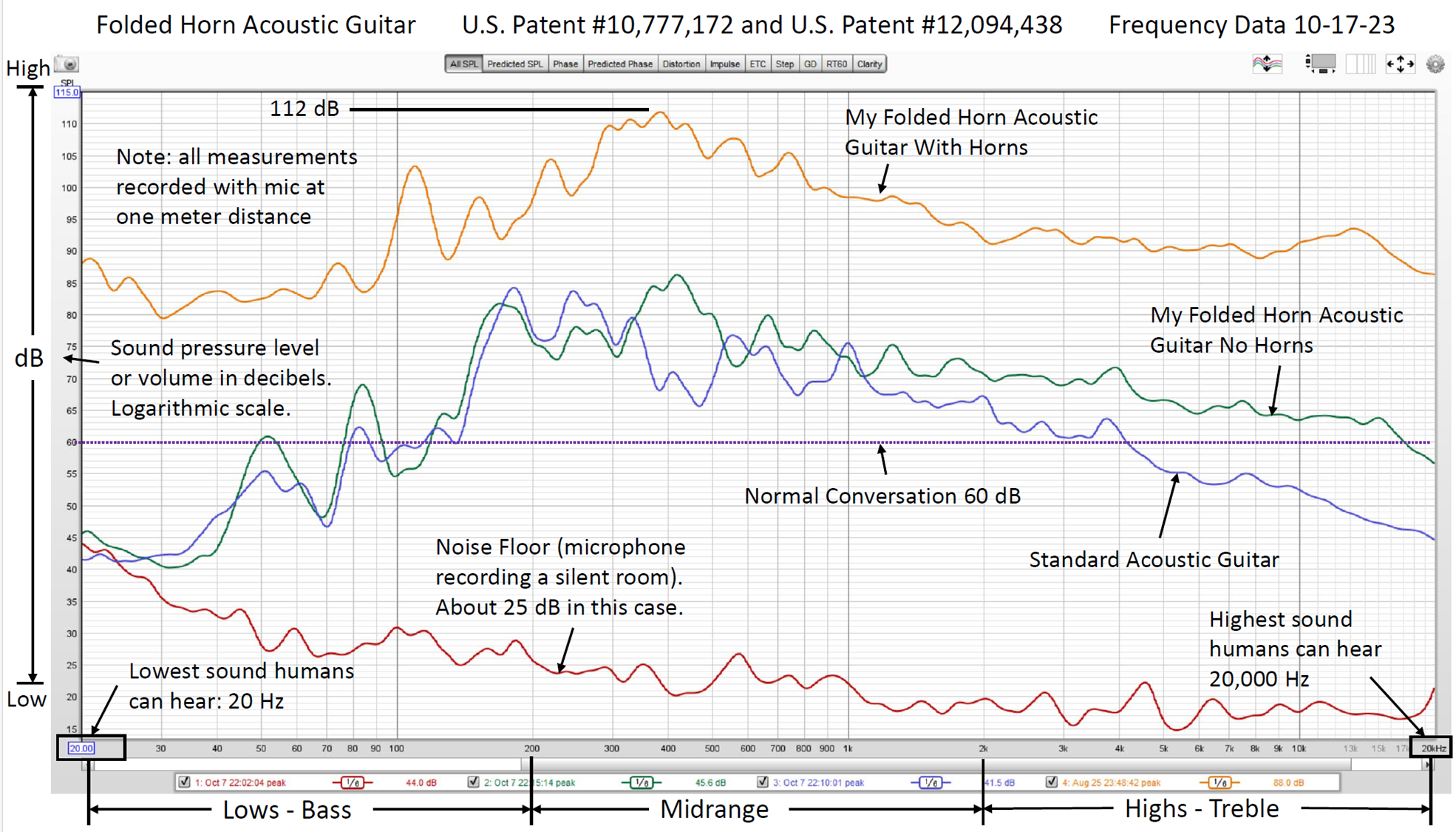

Art - new "Frequency Data" attached, what do you think? Let me have it!

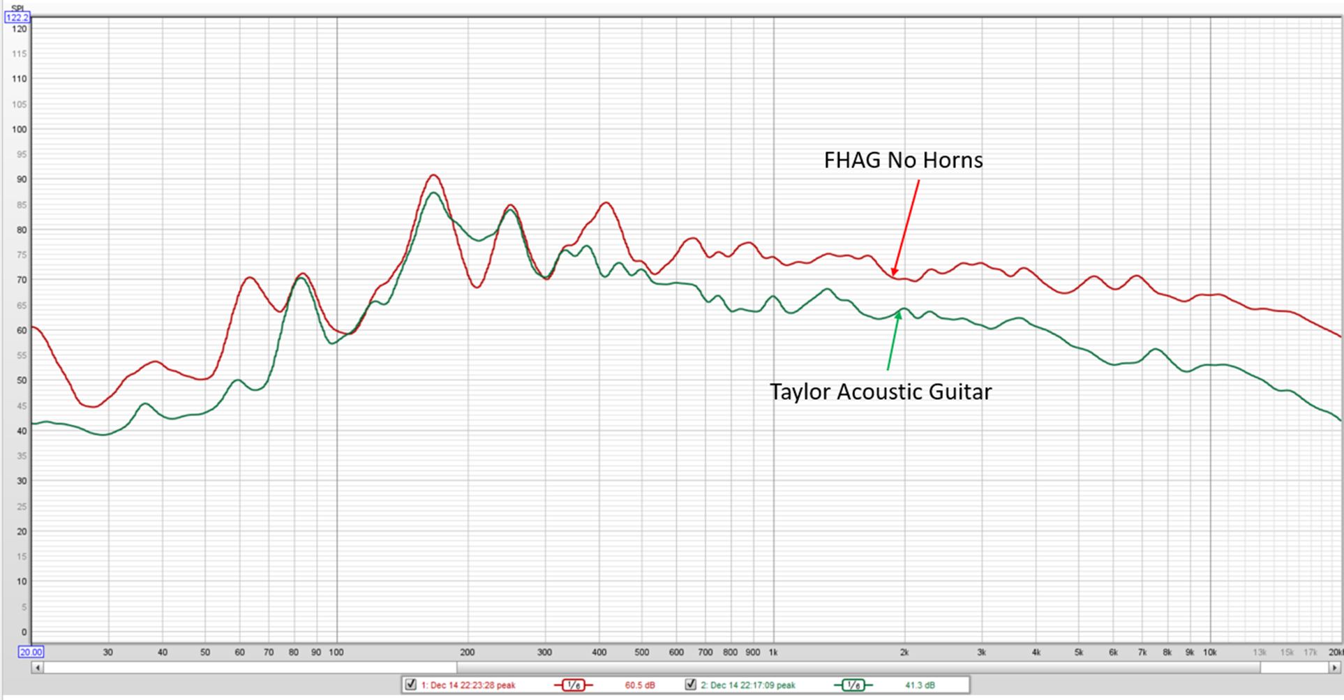

Joe,Art - new "Frequency Data" attached, what do you think? Let me have it!
So your FHAG still has +5dB more output at 20Hz than the 81Hz low E 😉 ?
Looks like the same random screen captures you have been posting since you got REW running.
Still think the same as when you have posted them before, they don't provide useful or realistic information.
Art
Thank you Art for the honest feedback. Yes it is the same screen captures, not sure what you mean about random. I just added more written notes to explain to people not familiar with dB and frequency chart info. Do you think Frequency Data is a better chart description than Frequency Response?
I can get different results of course, depending on what song I am playing, and how much emphasis I put on different strings and at different frets.
I definitely play differently with the horns on and the horns off, because there is so much power with them on, you are going to handle the instrument differently. I know it is not a 100% apples to apples comparison, but it is for standard guitar vs. horns off, and you can generally see that.
Every time I measure the guitar with horns on, I get generally the same result, depending on the song. The mids are about 25 dB higher, and the lows to the left rise at a greater magnitude, and the highs to the right rise at a greater magnitude, every time. This is what I want, and I can hear it very easily. This is what I am trying to show.
I think most people who see this will think OK I get that, pretty cool. Now you of course are going to dig deeper. I am not sure why the 20 Hz is so strong, undertones? Plus the noise floor is rising at 20 Hz, something going on there, not sure what it might be.
Anyway I find this data to be both useful and realistic, I can hear it very easily when I play, especially when I turn the horns off, wow what a difference.

Yes, but the data is from a random (or cherry-picked) time event.Thank you Art for the honest feedback. Yes it is the same screen captures, not sure what you mean about random. I just added more written notes to explain to people not familiar with dB and frequency chart info. Do you think Frequency Data is a better chart description than Frequency Response?
From what you have written, you still have not mixed the separately equalized magnetic pickup and piezo transducer output through both channels of the Carvin. You also have not used any pre-amp compression.JJ - I tried the Carvin with two mag pickups, and man it sure has power, although my drivers can not support it up to 50 watts per channel. The size is wonderful, but man I can not for the life of me get a good tone from the high E #1 string and B #2 string. It is way too much tinny town for me.
A good amp will amplify everything put into it equally. You need to control the harmonic balance of what you are amplifying with the frequency response of your speakers in combination with the acoustic sound of the guitar to get out of "tinny town".

One 1/4 note is a different time event, you don't need to wait for a different date for it to look and sound different..I see what you are saying Art, the FHAG data is from a different date, that is correct.
I'd guess there should be no, zero acoustic emissions at 20 Hz from any acoustic guitar, or bass for that matter. 20 Hz is really, really low; if present, it's more likely coming from some other source within the environment the recording is made in. I think Art is pointing out that the level you're seeing is a distraction from what you're trying to show, being at a greater level than the frequencies that "make sense" coming from an acoustic guitar. Which shouldnt be anything less than ~80 - unless you're doing a drop D tuning or something.also still not sure about the 20 Hz signal strength...
Now pounding on the soundboard, perhaps as you strum, can generate "thumps" which can contain in an analysis low frequencies. But you're not trying to show what soundboard thumps sound like, you're trying to show what the horns sound like - amplitude wise. By design length, their output will fall off well above 20 Hz. They cant contribute anything at that frequency one could almost say by definition, so why show it?
What I meant is any RTA screen capture only represents that particular real time, not what was played 1/4 note or second or hour or day before or after.Not sure what you mean by this Art, also still not sure about the 20 Hz signal strength...
We can speculate that the 20-70Hz output was from a passing or parked truck or something else not related to the FHAG, but it's presence just casts doubt on the noise floor of the entire spectrum at the time of capture.
Thank you gents, I think I will try a new REW capture, it has been some time. Same song, same timeframe, standard quality acoustic guitar, folded horns off, folded horns on, likely cut the bottom end off at 30 or 40 Hz, and just note 20 Hz being lowest sound humans can hear.

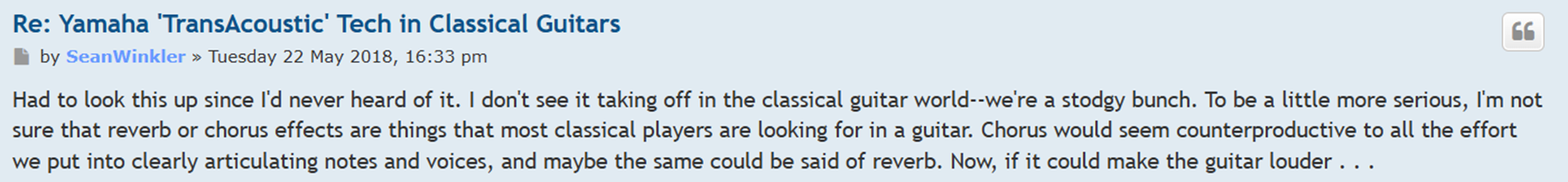

The post below is from 2018, and I know it is from a nylon string classical guitarist, but it captures how I feel about steel string acoustic guitars, effects, and more power needed. I love the last line in the comment!

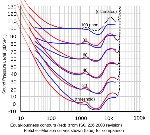

As far as 20Hz being the "lowest sound humans can hear", that's simply not true.
Extending the equal loudness contours downward from the usual 16 or 20Hz, it's easy to see that very low frequencies simply need more level to hear.
By comparison, the upper range is a far more steep curve, most average adults high frequency reaches a "brick wall" within ~1/3 octave, somewhere between 16-20kHz.
Back around 1933 when Fletcher and Munson investigated equal loudness by comparing tones at different frequencies to 1000Hz, the headphones could not reproduce much below 30Hz without the harmonics being louder than the fundamentals, nor did they provide much level above 10kHz or so.
Before any harmonic distortion is present at an audible level, I can easily hear ~10 Hz through Sony MD-7506 headphones, though some "humans" may not.
It is interesting to test your own hearing and see how it compares to the "average".
This test makes it easy to chart:
https://newt.phys.unsw.edu.au/jw/hearing.html

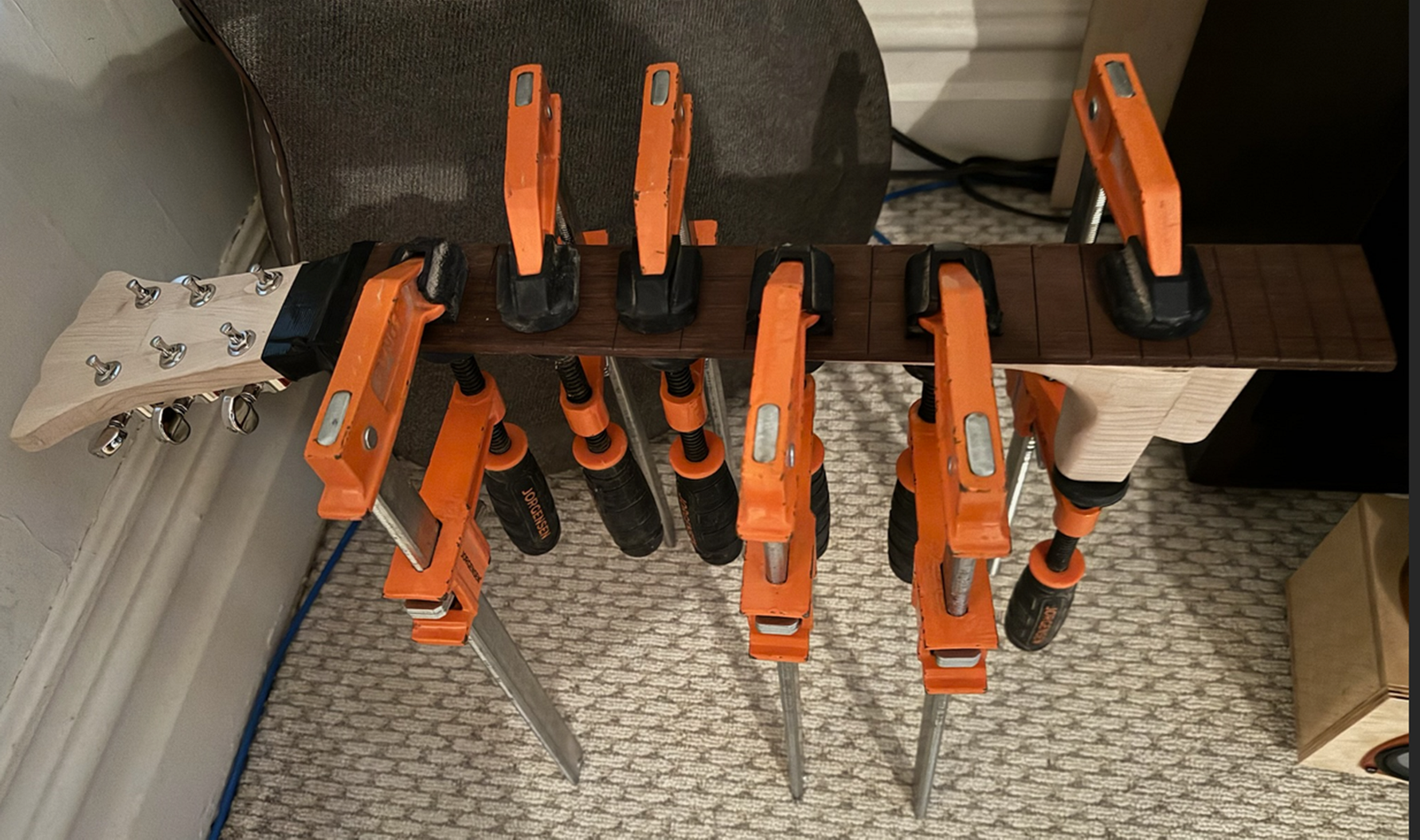

Snapshot below of neck for guitar #2, maple neck, rosewood fingerboard, Martin 25.34 scale, 16" radius frets, what could go wrong? 😉

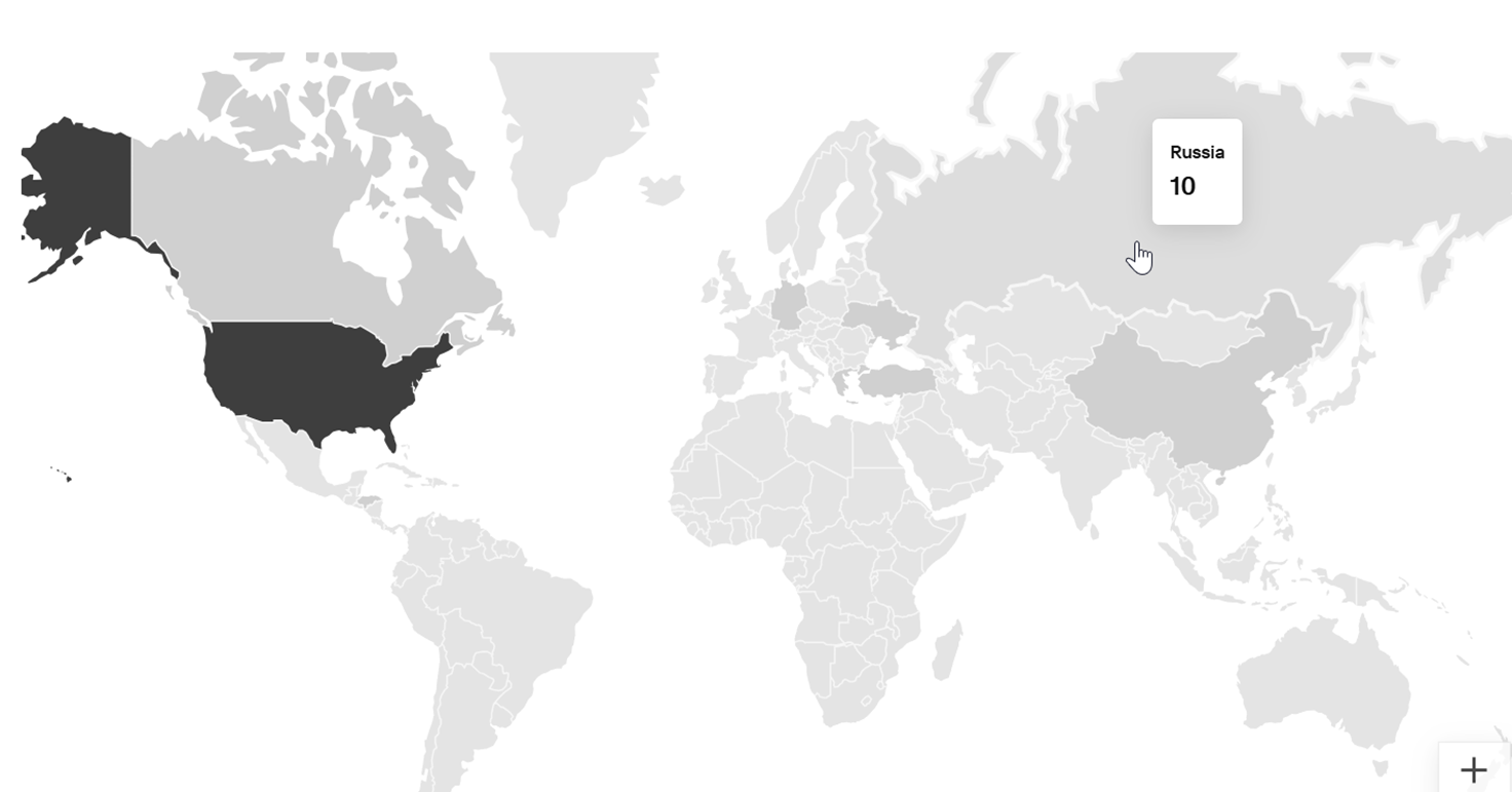

Website notes: I have (10) hits from Russia, a few from China, Turkey, Ukraine, Germany, Greece, and of course many from U.S. - fun!
