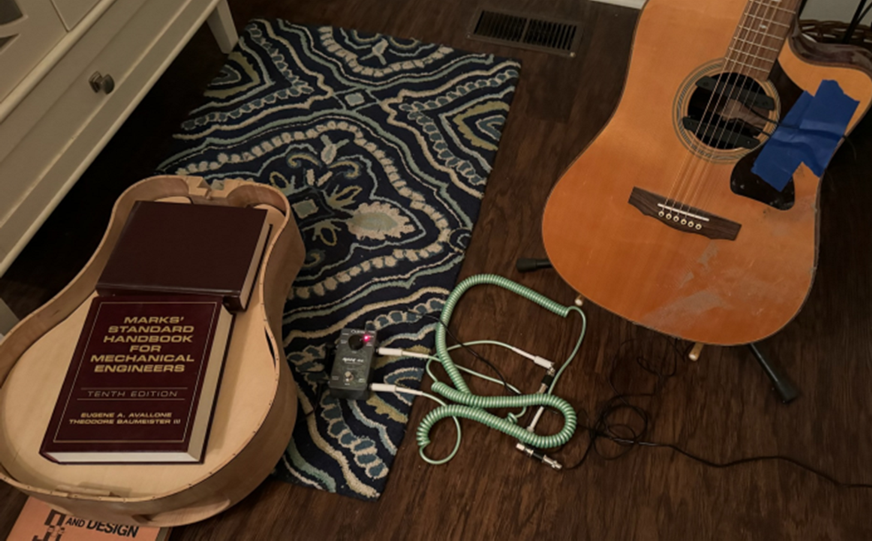

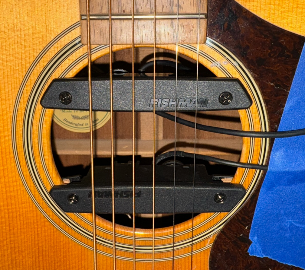

JJ- I tried everything, there is an impedance mismatch between the piezo and the Carvin electric guitar amp that will not work. Since the mag pickup sounds so good, I figure let's try two mag pickups into the Carvin. Standard for an electric guitar of course, may work well. Will it have the good tone, I think yes it might. Will it have the power, not sure. Trying it this weekend, I need to get this powerful little amp to work in my setup, stay tuned!
JJ- the Carvin lives! Two mag pickups, but with the old method, Guild through horns in other guitar. Tone was pretty damn great, after I got rid of the piezo mess. I thought why not as much power? One pickup through one driver works, the other is dead. Not sure why, but easy fix (not tonight), get them both working and power should be pretty damn great! Stay tuned!

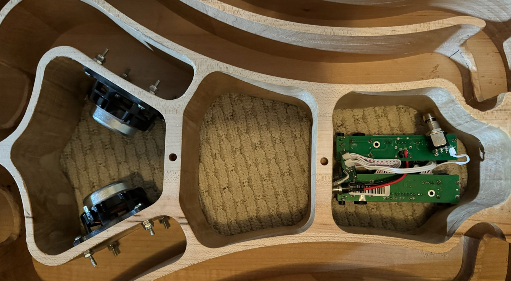

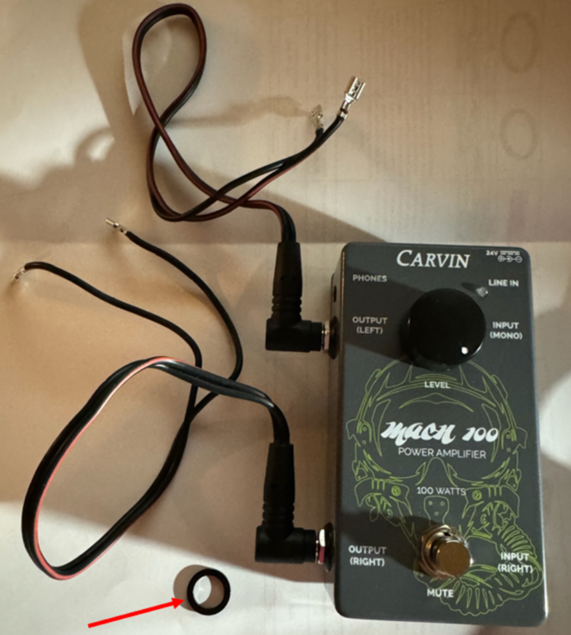

Found the problem. Both of my drivers are working. Carvin right channel works in both drivers, left channel dead in both.
Loose piece shown below, likely an assembly problem that maybe puts the connector in the wrong position. I am ripping
this baby apart to see how well it fits in my guitar, without the housing.
Just bought a new Carvin for $150 (50 watts per channel). Not bad really, seeing how Roland is getting about $600 at Sweetwater
(15 watts per channel).
So Carvin is a buck and a half per watt, and Roland is 20 bucks per watt, talk about efficiency in size and cost!

100 watts of ******* power fits well in this small area, very impressive (thank you JJ). Now I just need to figure out a small battery pack that will work with this setup.

You're welcome. You'll still need a heatsink for it, which could be a piece of metal sheet embedded in the dividing board, or a dividing board made of metal. There's an amplifier chip in that circuit board that needs to be attached to something that can conduct the heat away. Probably the metal box in the stock configuration. Surprised at Carvin's QC problems with this little amp -100 watts of ******* power fits well in this small area, very impressive (thank you JJ).
