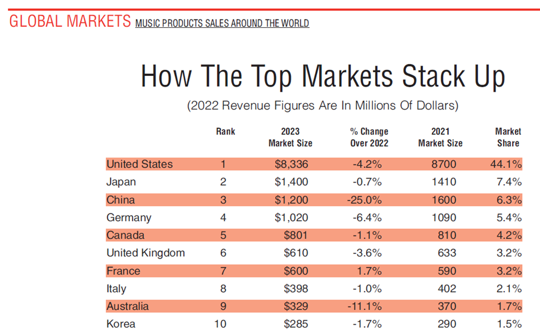

Some music industry analytics just for fun. Really great to see the U.S being so strong in music as we all know, but Japan is very strong, look how huge Yamaha is, they will not stop! Per capita Japan is very strong, and China is moving fast. India, the largest country in the world by population now, not so much, will this change? Innovation is critical!!

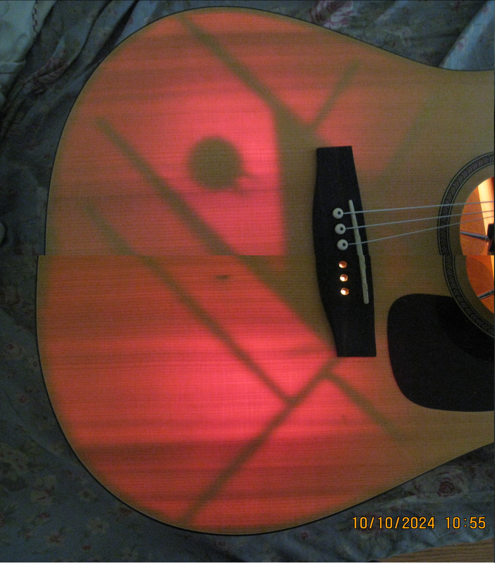

My soundboard vibrates great of course, as all do, but it also moves. I can move my soundboard 1/4" with my finger, like a drum skin or banjo skin, and man are they both loud. I am thinking not only do I get great vibration at every frequency as usual, but also greater amplitude for each frequency due to greater amount of movement. Am I correct about this? I bet the Godfather can school me on this issue, let me know what you think Art and thanks!
I've certainly no idea how soundboards on a guitar actually work. Like any "tympanic membrane" I know they have resonance and resonant modes. One is where the whole thing is moving up and down like a trampoline. A second is where portions - say left and right - sections are moving up and down, but out of phase with one another; when one is moving upward, the opposite is moving downward.Am I correct about this?
My Seagull has asymetrical bracing; the pattern under the upward half of the soundboard is different than the bottom half; yes, that's a transducer stuck to the soundboard underneath. It "works"; other performers commented it sounded okay, one remarking the guitar sounds different than with it miked. Well, of course.

Yes JJ, so most acoustic guitar soundboards are very stiff, great for vibration. But at what point is it too stiff? It will become a dampener eventually, taken too far for example, a concrete wall. At what point does having it move just a little bit "more like trampoline" help, and how much movement helps, before it gets to the other extreme, a piece of rubber, that has no stiffness and also becomes a dampener, yes? Any advise from people in the know would be greatly appreciated.

Most drums are built to be tunable. Acoustic guitars are not; you get what you get and hopefully the person building it knows what they're doing. For some reason the acoustic guitar soundboard has a high "q", which means it resonates fairly strongly at a frequency. I assume that helps with "projection"; how far out into an audience it can reach in its own. That was a concern before the vacuum tube was invented.
Now, for an acoustic guitar to sound like one, it needs this top resonance. It also needs the "air" resonance of the port and body cavity volume. We've been trained over the last few hundred years on this particular sound and it all started with this need to project; the better guitar to play being the one people could actually hear, even if that was centered around a boom on f# or g. A loudspeaker would never pass muster behaving that way.
I believe you can get a nice complex response out of the top by arranging the type of wood, its thickness and the pattern of bracing one ordinarily places underneath. This art is at quite the high level. Fan bracing / ladder bracing and all the permutations in between. It's a tough art to master and I'm sure many beings have lived and died for their beliefs of what's the right way to go in that particular art form.
Hell, it's all I can do just to find a good spot on the soundboard to put a pickup. They sell sets with two and three elements; I notice a difference in sound just moving the one I'm using 1/4" inch. Cant imagine the patience needed to place 3. to get the best possible sound.
I like your removable top; I wish all acoustic guitars were made that way, except with removable backs. Welts on my forearm from reaching in there through the sound hole trying to put in place something precisely. If the )&^ back just came off with screws...

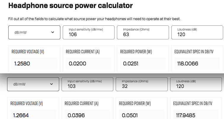

My best headphone setup through my laptop is low impedance (32 Ohm): "Meze 99 Classics POWER EFFICIENT WITH ANY DEVICE due to low impedance (32 Ohm). No need for amplification".
Really like it, great sound, low distortion and great tone for listening to my YouTube video and others. Most other higher impedance headphones through my laptop of course do not have near as much power. When I use a headphone amp they do have more power, but with MUCH distortion, total horseshit, at least for the clean acoustic sound I am going for...anybody have any headphone favs out there for laptop use?

I've been using Sony MD 7506 for ages, they are +3dB more sensitive than the Meze 99 (106dB/mW vs 103dB/mW):My best headphone setup through my laptop is low impedance (32 Ohm): "Meze 99 Classics POWER EFFICIENT WITH ANY DEVICE due to low impedance (32 Ohm). No need for amplification".
Using a Macintosh headphone output capable of 1.25v, both head phones would have around the same level, though the 7506 is rated for up to 1000mW (one watt, ouch!) while the Meze 99 are rated for 50mW maximum input, maxing out at ~120dB using twice the power.
PC headphone output may only be .3 to .5v output, which would reduce the maximum output to around 109-112 dB.
