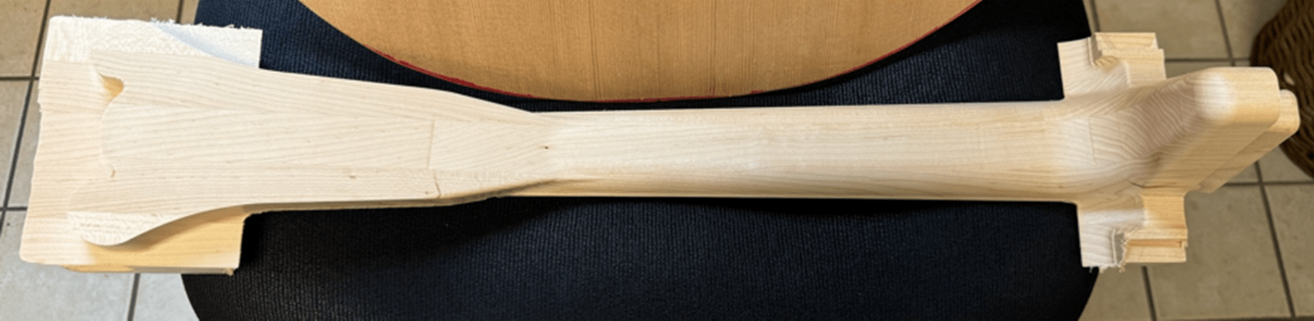

Neck finally off the CNC machine, was a long wait...already sawed off the extra wood, time to get serious about second guitar build.

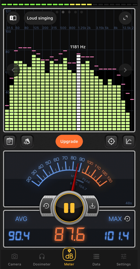

One would think the app would tell you what's on; guess you need to push the "Upgrade" button to get that...who is this?

App? this is FM radio...

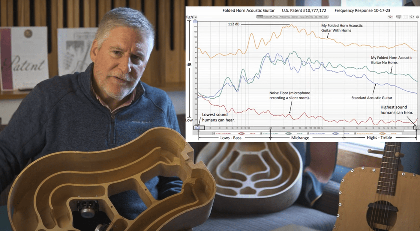

JJ did you by chance get a dB measurement at a given distance? Now that I am starting to build guitar #2, I am very much thinking about your ideas for horn lengths, ports...

Musicians arent going to know what 25 db of "sound power" actually is, so I think it's a fair term to use to promote the fact that "it's much louder" than a standard acoustic.
I believe its fair to mention the necessity of an amplifier, to make it work and get the claimed benefits. "Emanating" is a tough word; even this text editor didnt know it to correct my initial mis-spelling. But emanating or "coming from" the guitar itself is what needs to be clear to the reader.

Many of the comments from diyAudio people two years ago were over my head, but I learned, and quite frankly, I am very thankful for the group of people on this great site that have helped me, OK enough *** kissing, but it is true!

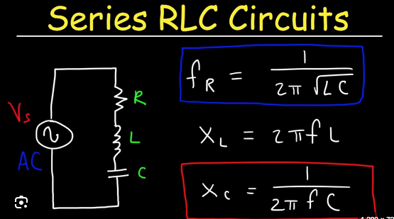

Different guitar cables have different capacitance, which changes the resonance in the pickup/cable resistor/capacitor/inductor circuit.They only thing I know about guitar cords is I need a 1/4" jack. I bought some "heavy duty" cords that are the old "curly" type like we always used in the late 70's early 80's, I wonder, could this be the difference? My straight cords are made in China I am sure, I would not be surprised if this makes a difference. thoughts?
Curly cables often have more capacitance (some have 10 times more) per length, which can roll off high end and/or shift the pickup resonance to a lower frequency.
The same cord will have a different effect on the higher impedance piezo than the lower impedance magnetic coil pickup.
Passive EQ circuits can be very tricky.
