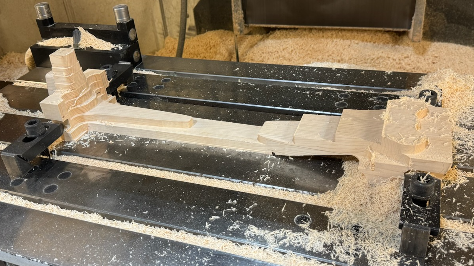

My necks are squared up flat to less than .001" (less than 1/5 the thickness of a human hair) before they are machined, can't trust flatness from a wood supplier. I don't care how good their wood is, it must be machined correctly BEFORE it goes on the CNC machine, then the CNC does its "magic" - OK good engineering - and the neck comes off the machine perfect, zero bow, zero fret buzz, perfect intonation (if the bridge is set correctly). This neck is in process now, hope to have off the machine next week (depending on shop work schedule).
