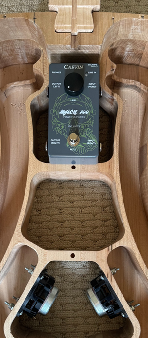

JJ - my Carvin Mach 100 arrived and this little amp looks great, can't believe they put 100 watts of power into an amp that is about 3" x 5". I used it with my Meze headphones for a quick test, and they sound even louder, and stay clean up to about 50% volume. I don't need it that high, so plenty of headroom. Thank you!
I should have some "wife gone" time tomorrow, so I will play my guitar through the Carvin without horns into my JBL's, will be another good test.

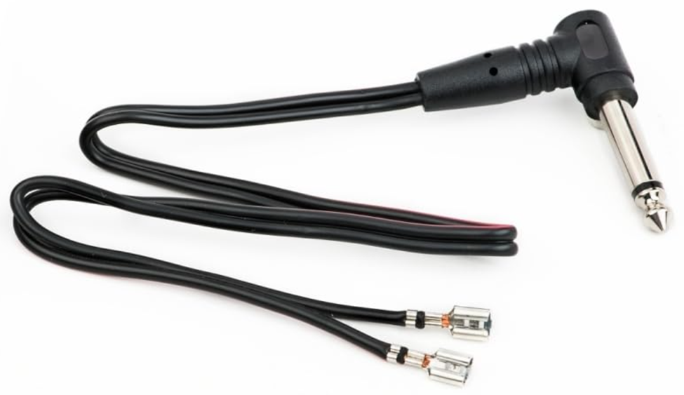

I just ordered some 1/4" to speaker "snap on terminal connectors" so I will be able to test the Carvin with guitar #1 but run them through the horns on guitar #2, that will be a great test, kind of like I used to do before the guitar was built. Then get some REW info and compare to guitar #1 FR output that I already have posted in the YouTube video.
The goal will be to put this amp into the guitar #2 build (if all goes well), just need to cut out a little more wood, plenty of room for a tight mounting, but there may be some creativity with the connectors. Now I just need to find a battery pack that can run this long term, or something similar, and everything can be self contained.

You're welcome. I'm seeing cells of Li-Ion battery within that middle cavity! Careful with how heavy the guitar is getting with all the additional materials inside. Mass is probably good, but up to a point. Remembering my Hagstrom Swede bass, almost to heavy for my back to hold.
As I mentioned previously, there's still a need for some kind of preamp to buffer your pickups, if not add some amp crush 'n color, ambience to your guitar's sound. I'm sure there's dozens of "acoustic" preamps to choose from, also in pedal board format.
Li-Ion battery within that middle cavity indeed! One of the great thing about acoustic guitars is people sit down to play them, so weight is not an issue there, but of course the buskers are a concern, hmm...the pickups are both active and have a preamp, so I think maybe not required, but I am open to ideas, what do you think JJ?

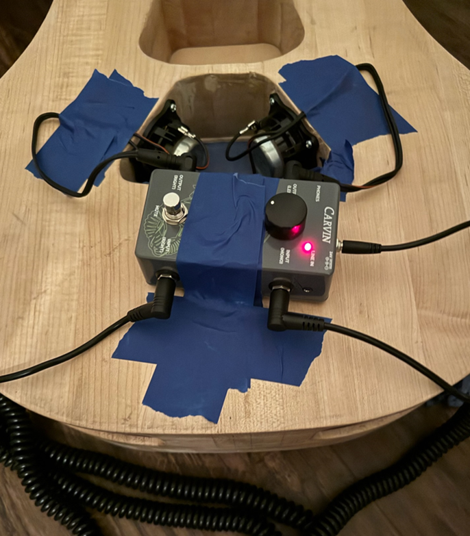

JJ - everything with the Carvin looked good, started up with the Mag pickup only, sounded good, but not much power. Then I kicked in the piezo pickup, and power like crazy, 100 watts you are not kidding, but the tone was just awful, even at much lower levels. Not sure what is going on with all these small amps, but they always have horrible tone. Made for electric guitar? Maybe they shred there, but with an acoustic guitar, no dice. Thanks for the recommendation brother, really thought we had something.
Quaky sound, yeah I guess, but it also sounded like I was playing through a tin can, just terrible, almost zero lows, and zero warm sound. I do not understand it! Thoughts? I switched back to my Roland and all the great sound is back. I am very grateful for the sound I have now, but I do not mind testing other options, you never know!
I'll guess that this pedal-amp was designed to be driven by a "line" input, that is, the buffered output (low Z) of some upstream device.
If your Roland amp has an effects loop, you can take the "send" from that and connect it to this amp. That way the Roland will "buffer" your pickups, while this amp will power the speakers. Or get a "acoustic guitar preamp" and place it between your guitar and this amp.
Maybe you're still within the window of being able to send it back? I understand your pickups are buffered, but like yourself, dont understand the results you're getting. Do just the tone control circuits in the Roland do that much?
Your picture of the amp's connection shows no speaker cover, which could reduce bass and change the response compared to a sealed back chamber.
Try swapping the spade lugs on one driver.
That description sounds like the result of drivers wired with reverse polarity.but it also sounded like I was playing through a tin can, just terrible, almost zero lows, and zero warm sound. I do not understand it! Thoughts?
Thanks Art - I will check the polarity. The speakers are covered at the front of the drivers of course, and always uncovered at the back of the drivers. I like to feel the sound in my body when I play, and it sounds and measures great this way. For this Carvin setup I will cover them front and back and and see what happens.

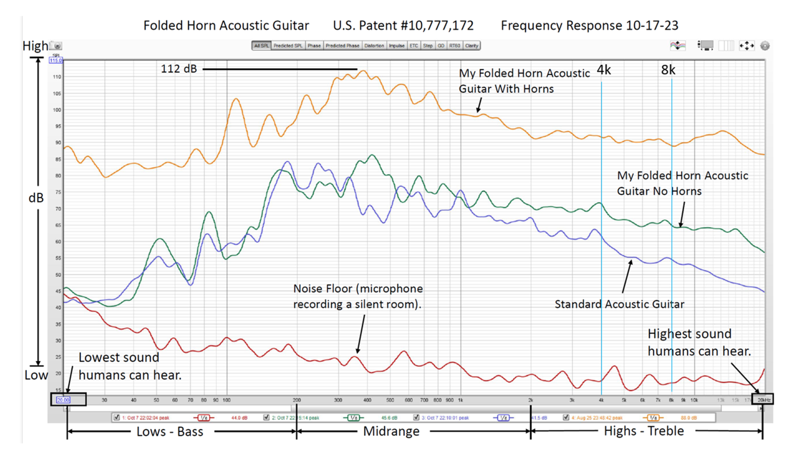

https://drive.google.com/file/d/1B_l0oouoINPuiOxNpbbJKd--4RYQvFmb/view?usp=sharing
YouTube video attached again, a few thoughts from my end, comments welcome!
I hope these specific times in the video show what I am trying to achieve:
4:17 Rich Lows
4:26 Beautiful Highs
4:48 Lows and Highs
6:32 Harmonic Power and Sustain
Note: Mids are strong everywhere, I hope.
7:28 Sparkle
9:16 Resonance and Sustain
11:15 Great Tone
11:36 Great Power
12:00 FUN!

Ok I tried the Carvin again with standard hookups, same result of course. Then I tried reverse polarity on one speaker only, and pretty much the same result. The mag pickup by itself sounded pretty good, but still major lack of power. Then I added the piezo and BAM, way more power, but still sounded like ****!
It did not sound as much like a tin can, but man I finally heard the piezo quacky sound that I never understood before. It was quacking like a duck! And the louder I made it, the worse it sounded, just terrible. I still think it is a very cool small and powerful amp, but just for an electric guitar.
Oh well, a good test. No such thing as a bad test, you always learn something! I am going back to my Roland, drivers and horns now, love that sound and will jam for two hours tonight.
I finally grew the melons' to ask the Berklee Professor how his students and colleagues liked my guitar, just a few hours ago. Maybe I will get some good news, and maybe I will get shafted, we shall see, stay tuned! 😎
Something is wrong if reversing the polarity of one speaker results in "pretty much the same result", there should be either an increase or reduction of the low end.Ok I tried the Carvin again with standard hookups, same result of course. Then I tried reverse polarity on one speaker only, and pretty much the same result. The mag pickup by itself sounded pretty good, but still major lack of power. Then I added the piezo and BAM, way more power, but still sounded like ****!
If you are sending one pickup right and the other left, reversing speaker polarity may not have much effect.
Have you verified both amp sides and speakers are working?
The Carvin has no pre-amp. What are you using as a pre-amp and mixer to get both pickups through both speakers?
Good timing Art, was just about to post a somewhat different question for you. I should say pretty much the same for the mag pickup only, that is what I tried first, and for some reason it is really under powered, so I am likely not hearing what is happening, and I did not measure anything last night, to busy jamming and drinking beer. 🤣
I did verify both amp sides and speakers are working, and yes for this amp only, one pickup is going to a speaker, and the other pickup to the other speaker. Both pickups have a preamp, so that is all I ever use for my preamp.
For whatever reason the piezo has much more power with this amp (not true for my usual Roland). So when I say the piezo sounded very very quaky, that could be a result of the low end being reduced and I hear much more high quaky end? I am not giving up on this amp, I just love the power and size, I will keep trying.

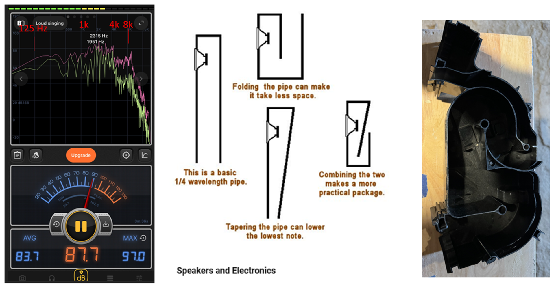

Art - so what gives with the "reverse horn" supposedly lowering the lowest note? The Bose Waveguide Radio is like this. The iPhone measurement to the left measures good lows/mids and sounds like good lows/mids, measured directly in front of the Bose at one meter distance. I heard and also measure the highs taking a nosedive at 8k. There was a lack of my dreaded "tinny tone" but there was not any sparkle either. This was a Bonnie Raitt song, so plenty of great talent.
When I note Casey is playing with plenty of sparkle on my YouTube video at 7:28 time frame, you can sure hear it, and the harmonics at 4k, 8k and above measure very strong.
So the question is: does a "reverse horn" really increase the lows, and then also kill the harmonics above about 8k? If they do, why would you use it? Two out of three just does not cut it, as we all know. Thoughts? Thanks Art!
