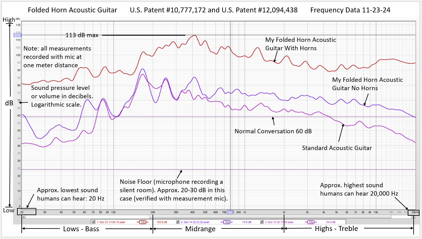

Updated REW data attached, very similar as always, but not exactly the same. I am sure my playing has something to do with the differences. I always play the same song, at the same volume, in the same room, with the same mic distance and direction. Generally shows the same dB increase in mids, and the lows and highs always improve, I like it. I found some time to do the final measurement today, and man did it sound great!
I know the low mids are always the strongest, pretty much the same with a Taylor. Why the 82 Hz does not record as high as the approx. 400 Hz I don't know, but man you can hear it at 4:00 minutes on the YouTube video, 82 Hz is very strong with just finger picking, not weak in any way. Plus at 11:13 minutes on the YouTube video, all strings sound very even on the power scale. Plus I am pretty sure my soundboard is contributing to the lows, based on tapping comparisons.
The highest note I am fretting on a string is 440 Hz A (tenth fret, second string), not sure if this contributes to the slightly lower that 440 Hz highest dB level. Plus I wonder how the frequency combinations of six strings might affect the measurement?
Yamaha is strongest at the low mids, but they are showing an improvement being strongest at 82 Hz with scalloped bracing, nice trick if you can pull it off!

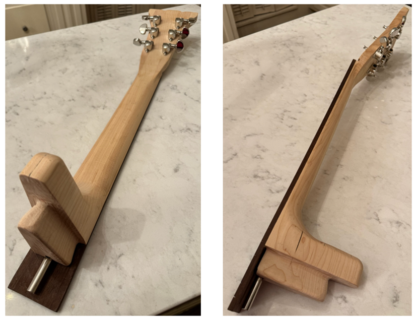

Neck is dead nuts flat, and dovetail fit to body is solid as a rock.

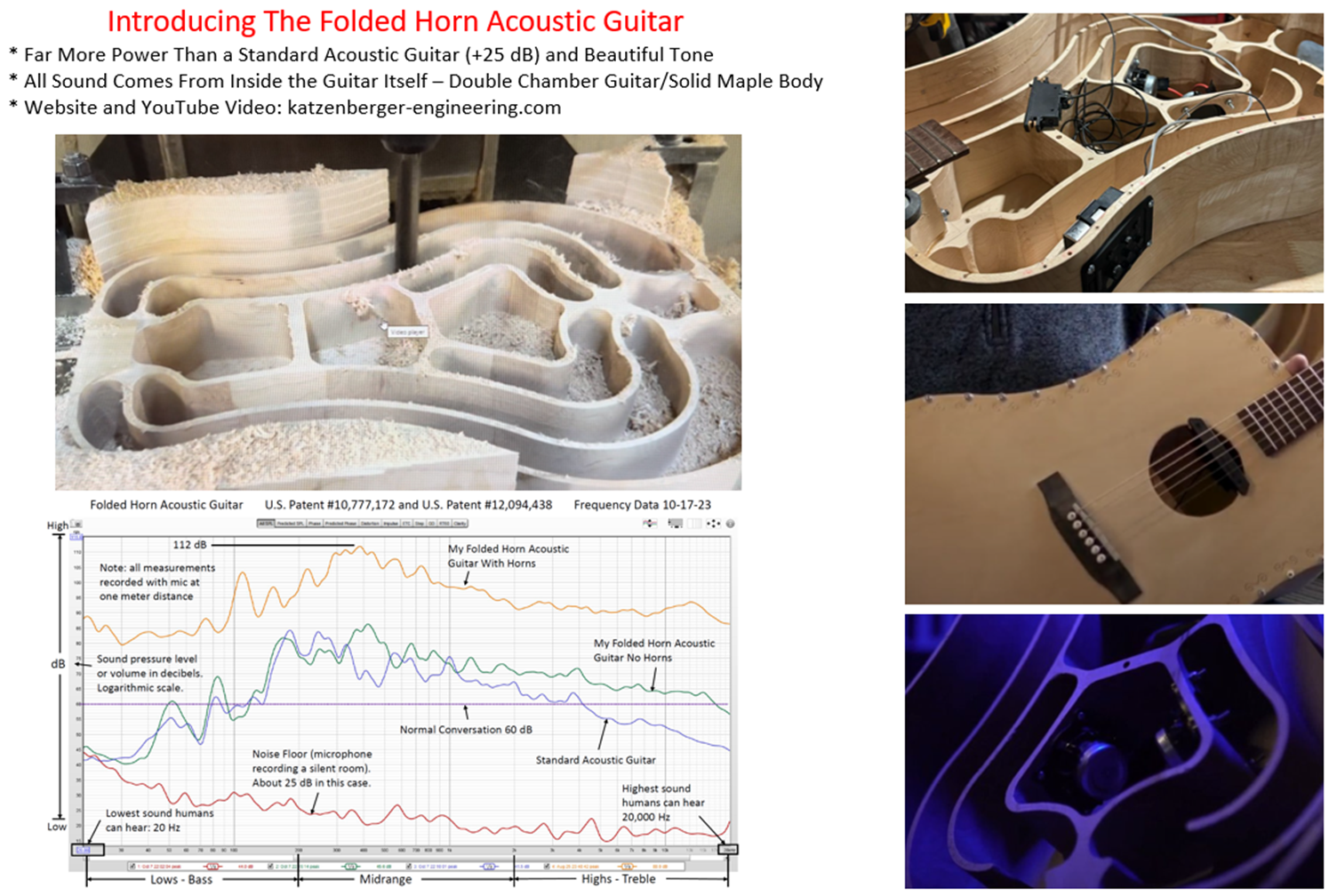

Preliminary Ad submitted to Acoustic Guitar Magazine for 1/2 page Ad. The resolution will be much better than this copy/paste. I asked for any corrections or suggestions they may have to offer, so we shall see!
Turning the magazine page onto this, few are going to get it. It needs to be your "3 minute elevator ride pitch" to a CEO...
I'd have one of the images clearly depicting, with arrows and lines, the path from each speaker face around to the horn exit.
I'd also show conceptually the layup of the guitar from top to back, so people can understand the "thinline" section consisting of the top, sides and narrow space to the dividing board, with the horn section being the separate routed out structure behind the dividing board. Otherwise no clue how this comes together to form a guitar.
Dont show the screws holding the top in place. Photoshop them all out, or just dont show the front of the guitar at all - keep it all to the horn channels, sectional layup and horn exits. Everyone knows what a common spruce top looks like.
As dumb as this may sound, if you could get pictured illuminated smoke or fog blasting out the horn mouths with some generic musician type holding the guitar in standing position - that would do more to sell/tell what it does at a glance than anything else I can imagine. You could always caption the fog dispersing pattern with "112 db!"
At my previous employ, we really wanted to visualize airflow, but without the smoke. Something about carbon dioxide gas and a thermal camera. Maybe just hot air?

What I get from the preliminary ad are photos of an guitar in various stages of construction, none of which would entice me to buy it. The squiggly lines won't have meaning to most musicians, and will be dismissed by those that may understand them- why does a "normal conversation" result in a flat line from 20Hz to 20kHz?Why do you think few will get it?
Why is "My Folded Horn Acoustic Guitar" measured with and without horns?
There is little to suggest a viable product is available, why anyone would want to buy it, what it costs, what tonal controls it has, or how it is powered.
I've been explaining to you for over a year why your "Frequency Data" provides almost no useful information for a technician or a musician, but it's obvious you still don't understand 😉Before you guys turned me on to REW, I would not get the Frequency Data at first glance, but I could figure it out. With all the notes I added, it seems fairly obvious to me, and I would be highly surprised if musicians could not understand this data.
Electric guitars have been made with easy back access to their electronics for over 75 years.Oh, the fugly screws. Yes I have always agreed with you on this, nobody likes them. Well let's see how everybody likes to have a glued on top with binding, then need to remove it with a hot knife, because there is MUCH going on inside this guitar, as opposed to pretty much nothing inside a standard acoustic guitar, live with that theoretical people.
In the year 2025 the only excuse for fugly access screws on an acoustic electric guitar is poor design.
The inverse distance law applies inside the horn as well as outside, the closer the mic is to the horn throat, the more SPL, no surprise.Art - I may have mentioned before that I put the miniDSP mic as far as I could inside the horn as shown below, and it was measuring very high.
Directing the horn output to the lower left of the player as designed does not seem "helpful".I keep thinking about elongating the horn back toward the player, or a second port toward the player, which I know we discussed, and maybe it would not be helpful?

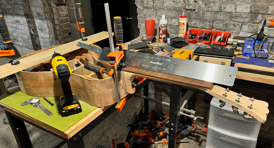

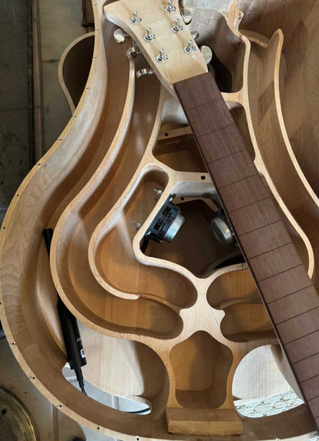

Another construction picture for the AGM Ad...kidding... 🤣 I forgot how hot a drill gets when it runs through 3" of a hard maple assembly.
You guys have me thinking about glue vs. screws of course. I have some black coated screws...hmm, might even look worse? Checked out yet another video of removing a glued on soundboard, it is brutal. Since glue is often stronger than the wood itself, the wood does not come off easy.
I know "keep the top on always", a challenge for this guitar. I can redesign and have some back components come off instead, not as easy when the entire back may need to come off, plus would not be anywhere near as stable on a CNC machine that is ripping wood off, to make an unusual shape, but may be doable.
When Casey was done playing my guitar he said the intonation was excellent, many reasons for this. He also said it projected like a mother, love to hear that.
I see guitar videos on YouTube stating a guitar is never really in perfect tune on every string at every fret, I cry ********. Make the guitar a beast and nothing will move when you are playing it. Of course drop tune, or beat the hell out of it trying to get some power, then yes it could happen. I have played this guitar for hours without needing to retune at all, and still in perfect tune the next day. Size matters, hence Grand Pianos need to be tuned very infrequently.
Plus my soundboard bracing is cut in solid, not glued. Even the best glue job can have a few problem areas, especially at the end of bracing as the top moves and moves over years. A slight disconnect, and buzzing brace, then the top must come off, get the iron and hope for the best!
