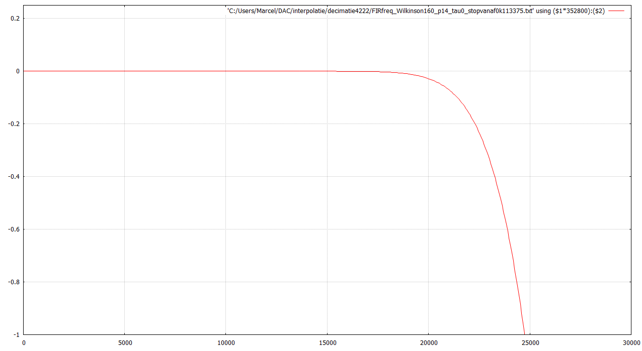

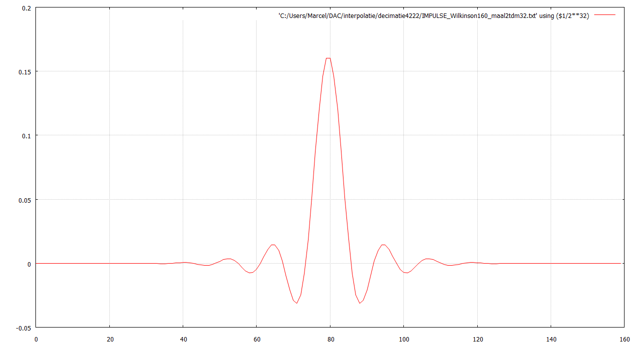

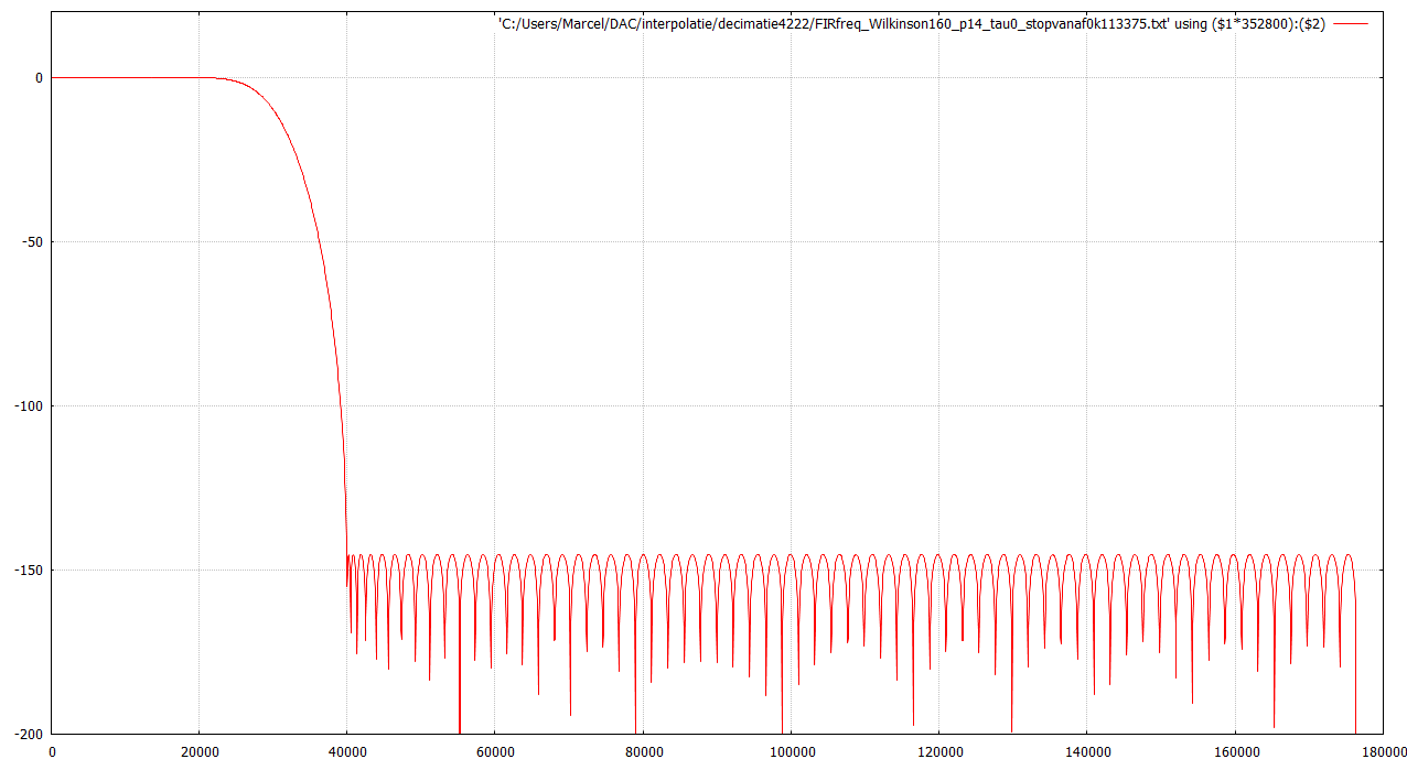

Regarding the last decimation step, what would you prefer:
1. No peak in the response, perfectly linear phase, equal pre- and post-ringing
2. A slight response peak, nearly linear phase over the passband, somewhat reduced pre- and somewhat more post-ringing?
Attached are pictures for case 1:
Magnitude in dB versus frequency in Hz
Zoom of the magnitude
Impulse response, horizontal axis in 1/352800 s sample times
