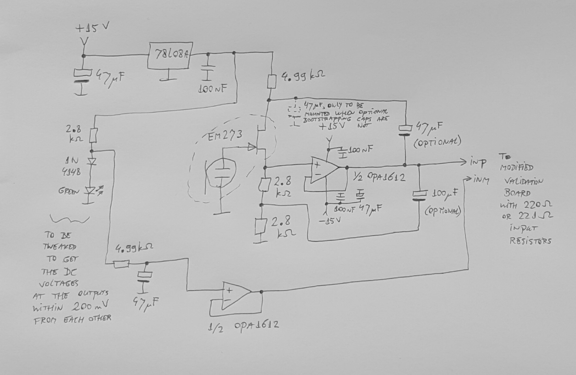

Scott uses nearly unity gain positive feedback to make the FET inside the capsule work at a nearly constant source current and a nearly constant drain-source voltage. That largely eliminates the distortion of the FET; the curvatures of its characteristics cause no distortion when it always works in the same point on the curves.
The NPN emitter follower copies the signal on the source to the drain to keep the drain-source voltage constant. The PNP does the same with the voltage across the source resistor, thereby keeping the source current nearly constant.
My latest sketch does the same in a more conventional, brute-force manner when you include the electrolytic capacitors from the op-amp voltage follower to the drain and to a midpoint of the source resistor.

Thanks Marcel - I think I can digest most of that. I would be interested to try to define a BOM for your circuit. I will probably also want to build fig10 for comparison.

Regarding the diode stack in the picture from post #113, the idea is to stack LEDs and diodes until you have a voltage close to the DC bias voltage at the source of the JFET. You can add an RC filter between the stack and the op-amp to filter off any noise.

Is this hardwire- or vero-bardable or should one go for a 2 layer PCB do you think?
The 8V (?) stab would one of the new super low noise ones (LT3045 etc) be of benefit? (Size?)
The diode array - 0,7V are quite large steps?
Your optional bootstrap... are you hesitating of its virtues... or?
When you use the SOIC-8 package version of the OPA1612 and solder some short wires to it, it should be Veroboardable. As the circuit is neither tried nor tested, Veroboard will give you the most options to change things if needed. To prevent hum, you will need a shielded enclosure around the Veroboard and some distance to the nearest mains transformer.
The noise of the regulator is filtered off by the 4.99 kohm resistor and 47 uF electrolytic capacitor (to ground or to the op-amp output, depending on whether you want bootstrapping). I expect that will suppress it sufficiently so you don't need an LT3042 or LT3045.
Regarding the diodes, you can try a red, green or yellow LED to make smaller steps. Red LEDs usually have the lowest and green the largest forward voltages, if I remember well. You could also replace the 1N4148 with one or more BAT85 Schottky diode(s) or play a bit with the current level, if needed. My best guess is a green LED and a normal silicon diode, as drawn.
Actually an alternative could be to choose the LED and diode such that you get about 2.3 V, replace the bottom 2.8 kohm resistor with 1 kohm in series with a 5 kohm trimming potmeter (wiper connected to the positive side) and trim it until the output voltages are about equal. That probably leads to a more reproducible source bias voltage than what I had in mind.
I'm pretty sure the bootstrap will reduce distortion like Scott's does, what I'm not sure about is whether it is acceptable to you. Even though they are not in the primary signal path and only reduce second-order effects, there are AC coupling capacitors in the bootstrapping circuit.
Cool. Yes, I did actually suspected that these capacitors must be seen as being on the signal path but ea a bit hesitant to ask this so to come out as ungreatful for the great support you give
I will arrange so that both options can be avaluated somehow.

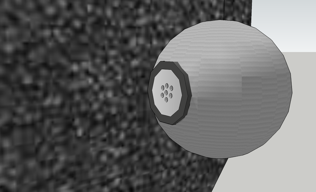

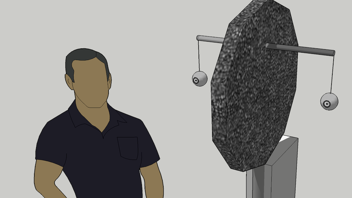

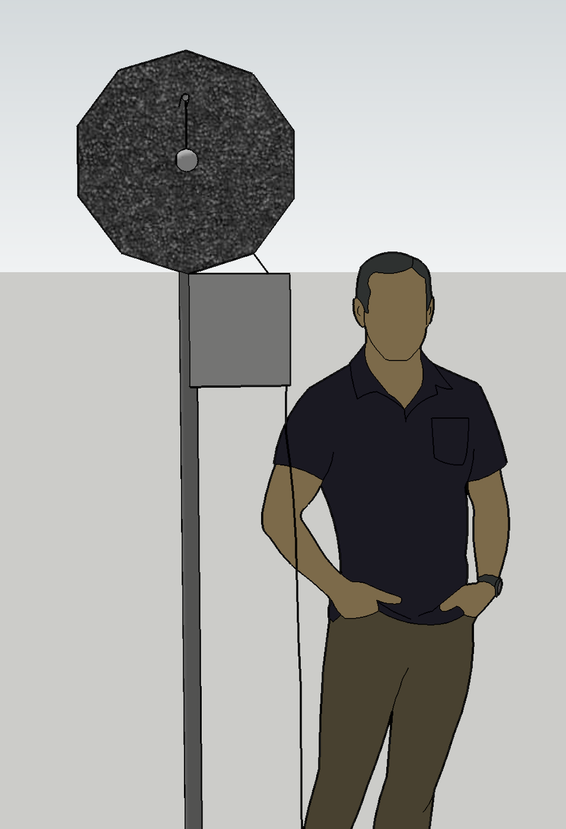

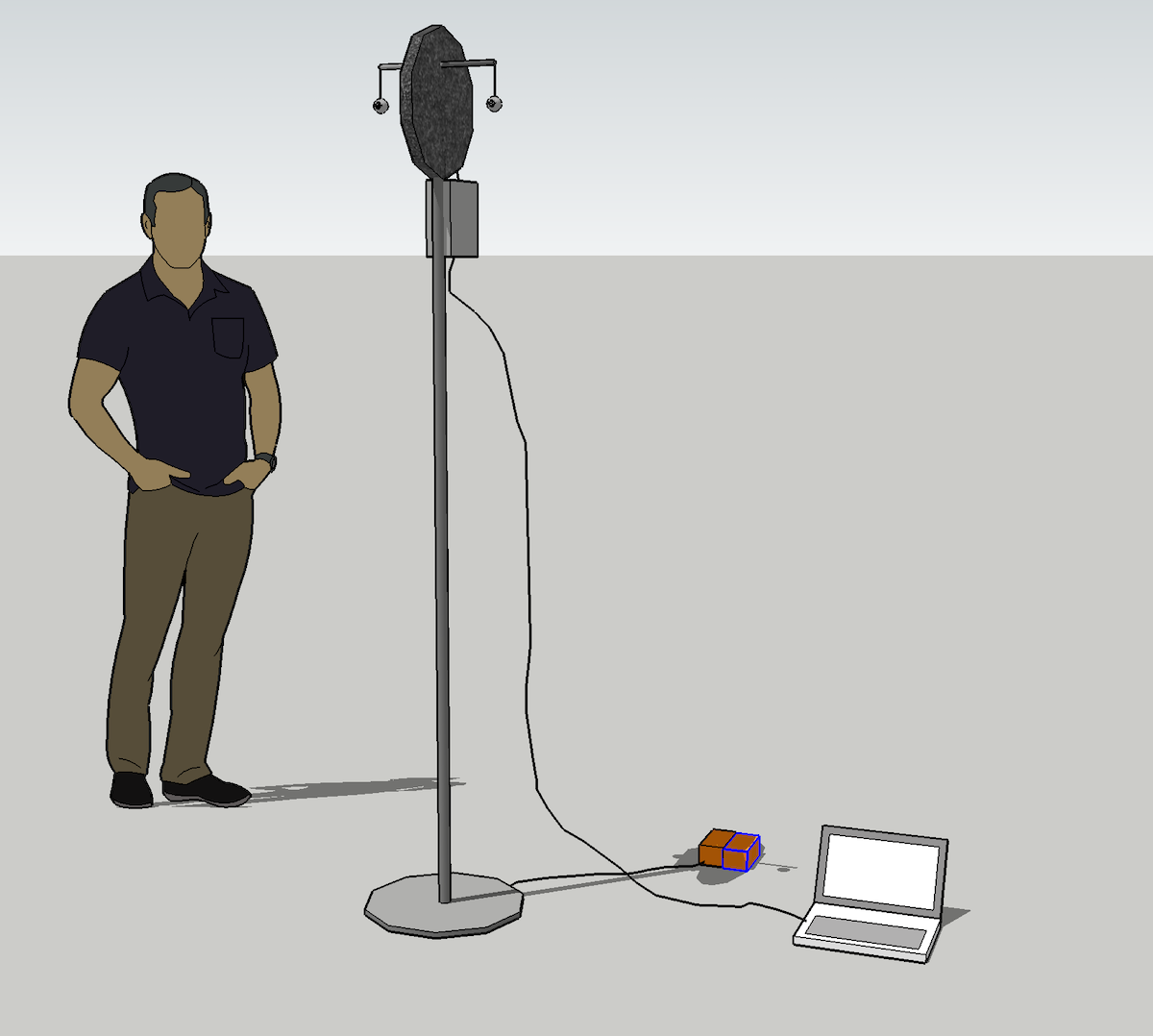

I have some ideas for housing the capsules that would give great shielding... see if I can draw something to test them here...

I don't subscribe to capacitor nonsense, the circuit as given won the European Triode Fest recording shootout against plenty of expensive tube mics and gear.
