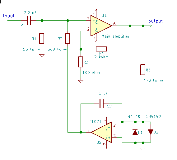

I feel the same way about offset servos, they are frequently in the signal path "technically" so I would go with a coupling cap, much simpler.
I sometimes combine coupling capacitors and DC servos in the same design. For example, the attachment shows what I use in my main amplifier (the upper op-amp is actually not an op-amp, but a nearly discrete power amplifier). It can work quite well, the only disadvantage is that neither people who dislike coupling capacitors nor people who dislike DC servos will like the design ;)

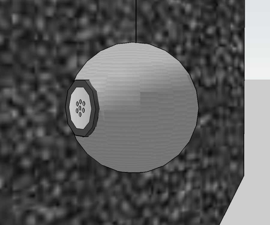

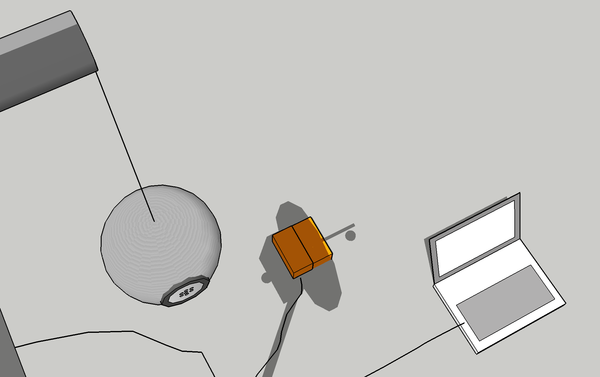

What about the "eyeball" mic? :) This idea I have taken from a pair of subs I built which in turn was inspired by B&W "ball subs". Apparently, vibration in a sphere tend to go around in the walls rather than vibrating the whole sphere. So I hope with this to have a very silent platform for the capsules. I ordered also the bespoke rubber grommets. I hope to suspend the eyeballs in perhaps springs or the like. Treating the innards with damping paint or other treatment... The only thing I like to move is the membrane...
But will there be diffraction or reflections from a big "tip" of the mic?
