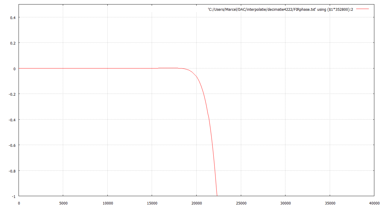

These are for case 2:

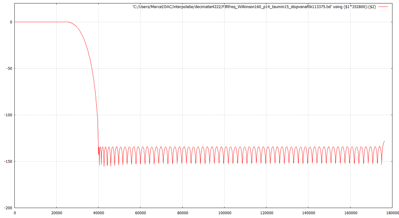

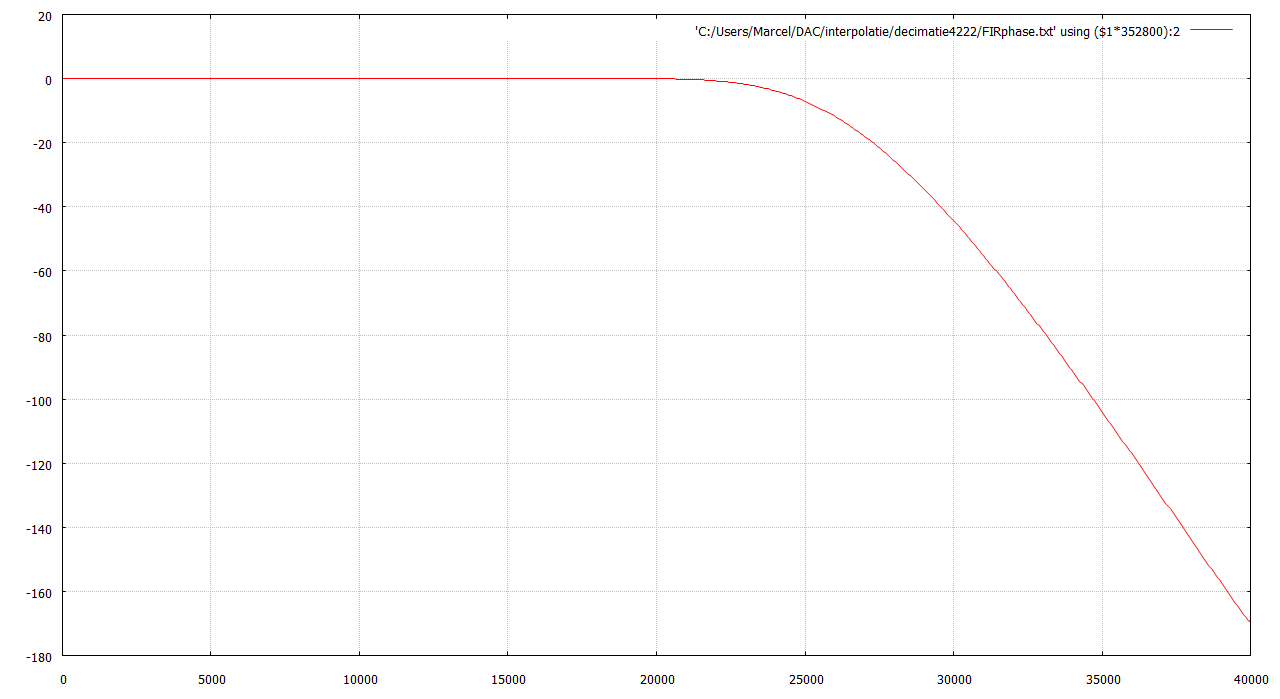

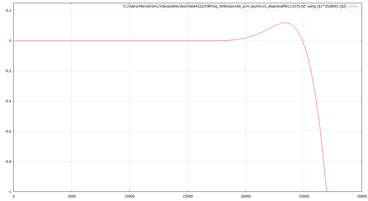

Magnitude in dB versus frequency in Hz
Zoom of the same

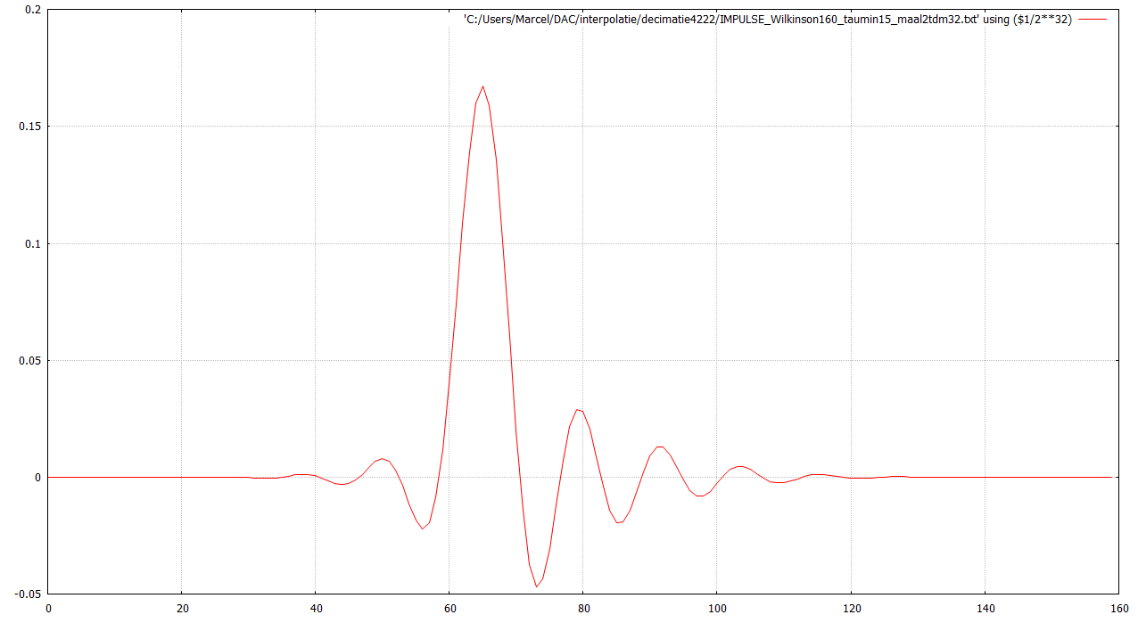

Impulse response, x-axis unit is sample times of 1/352800 s

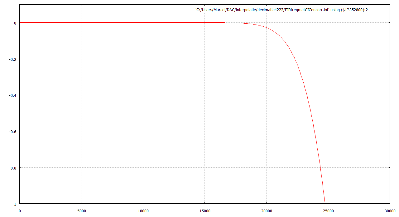

Deviation from linear phase in degrees versus frequency in Hz
Zoom of the deviation from linear phase
Zoom of the same
Deviationfromlinearphaseindegrees_Wilkinson160_taumin15.png30.1 KB · Views: 116
Deviationfromlinearphaseindegrees_Wilkinson160_taumin15_zoom.png30.1 KB · Views: 114

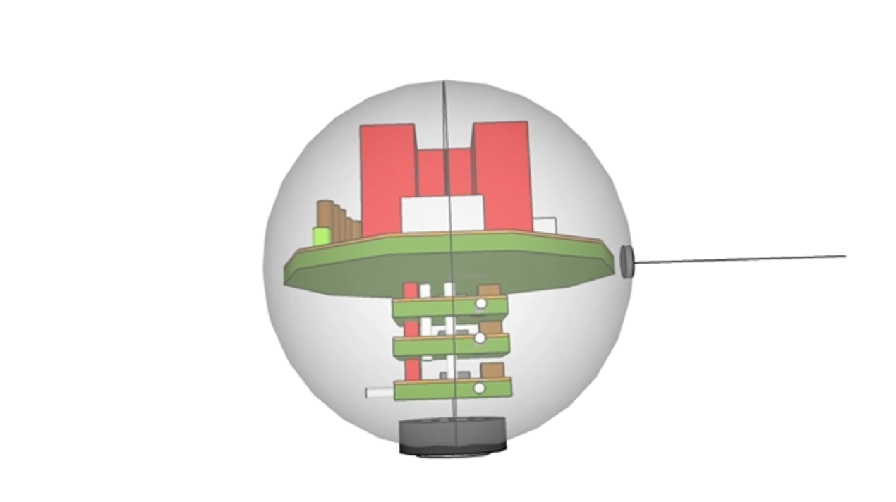

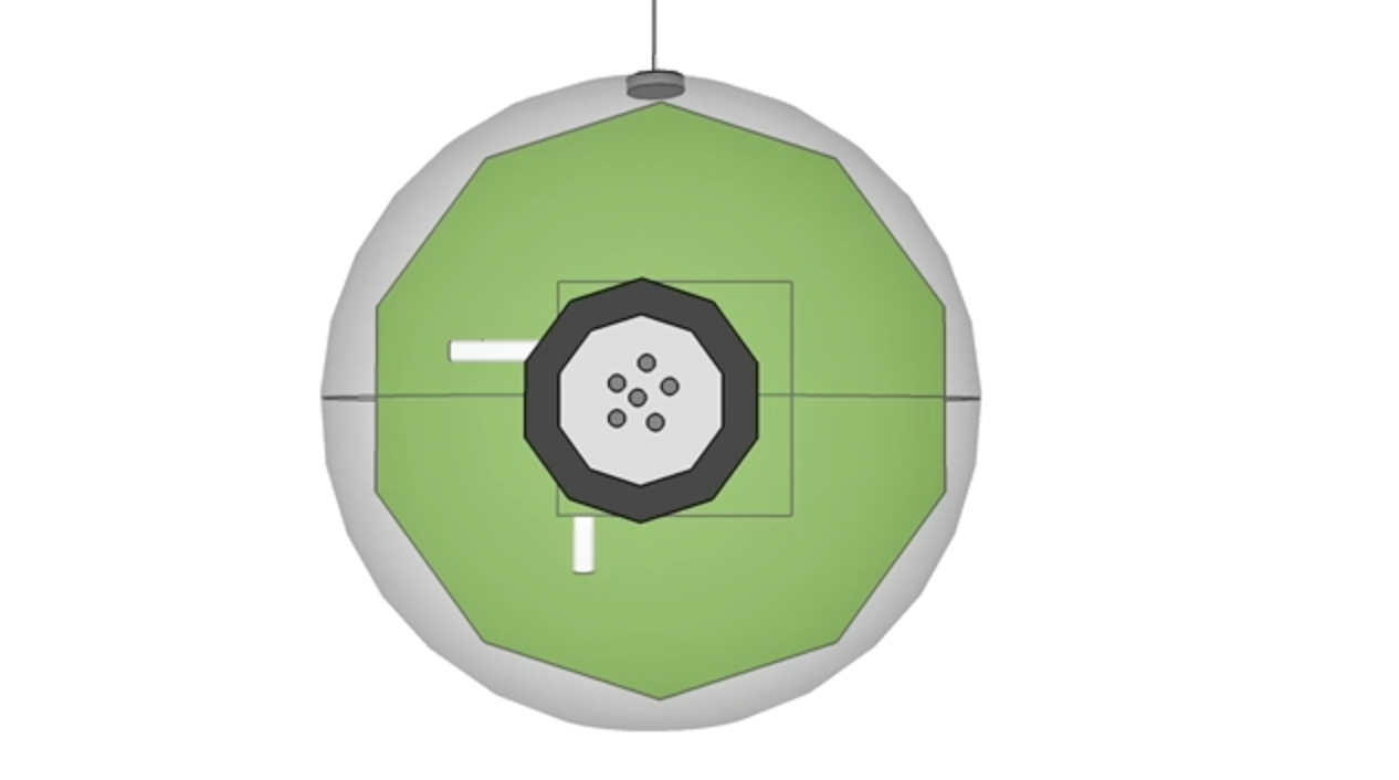

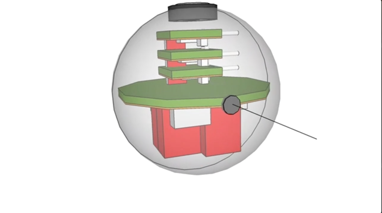

I think I can fit the Marcel circuit into a sphere made out of stainless steel from IKEA with a diameter of 50mm.
See the attached .mp4 video...

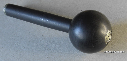

Some quotes I found..
Neumann's KK50 capsule assembly
"Through the design of mounting the Omni-directional capsule within a spherical housing, whereby the diaphragm almost becomes a small percentage of the surface of the sphere, helps to obtain the characteristic sound the KK50 capsule gives us. Somewhat similar in principle to recent the B&K microphone and "slide on" ball combination.
Let us not forget the old ST&C 4021 "Apple (Ball) and Biscuit" dynamic model, whereby the diaphragm also sits on the surface of a sphere. However, the "Biscuit" forms a screen to direct high frequencies, therefore enabling the microphone to offer an omni-directional pattern across the whole frequency spectrum."
Here, post #4: seems a bit promising re to the casing shape...
DIY M50 capsule | GroupDIY
Post #661
"Eyeball" capsules
This e.g., sound interesting to me:
"The degree of this effect can be quite surprising--I remember being in the control room of a large studio when recording a string quartet, and feeling a strange cognitive dissonance between what I heard through the monitors and what I saw through the glass: The quartet sounded as if it was being recorded from a moderately close perspective, but the M 50s were 20 feet or more (6 - 8 meters) away, up fairly high on stands. No clear recording should ordinarily have been possible at that miking distance.
When microphones can be placed more distantly from, for example, a large orchestra, this helps to solve one of the basic problems of recording a large ensemble in a concert hall: Concert halls are generally designed to have the proper reverberation balance when they are mostly full, but recordings are generally made when the hall has no audience in it; thus the microphones have to be brought in closer to the ensemble to avoid an overly reverberant pickup. But then some of the players will be (proportionately) much closer to the microphones than other players are, and will thus be picked up far more strongly and distinctly."

Both of them give the same error on the Android device I used yesterday and work fine when I look at them with my Linux computer.

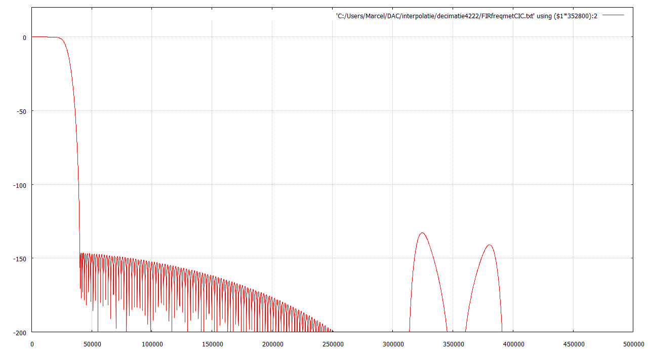

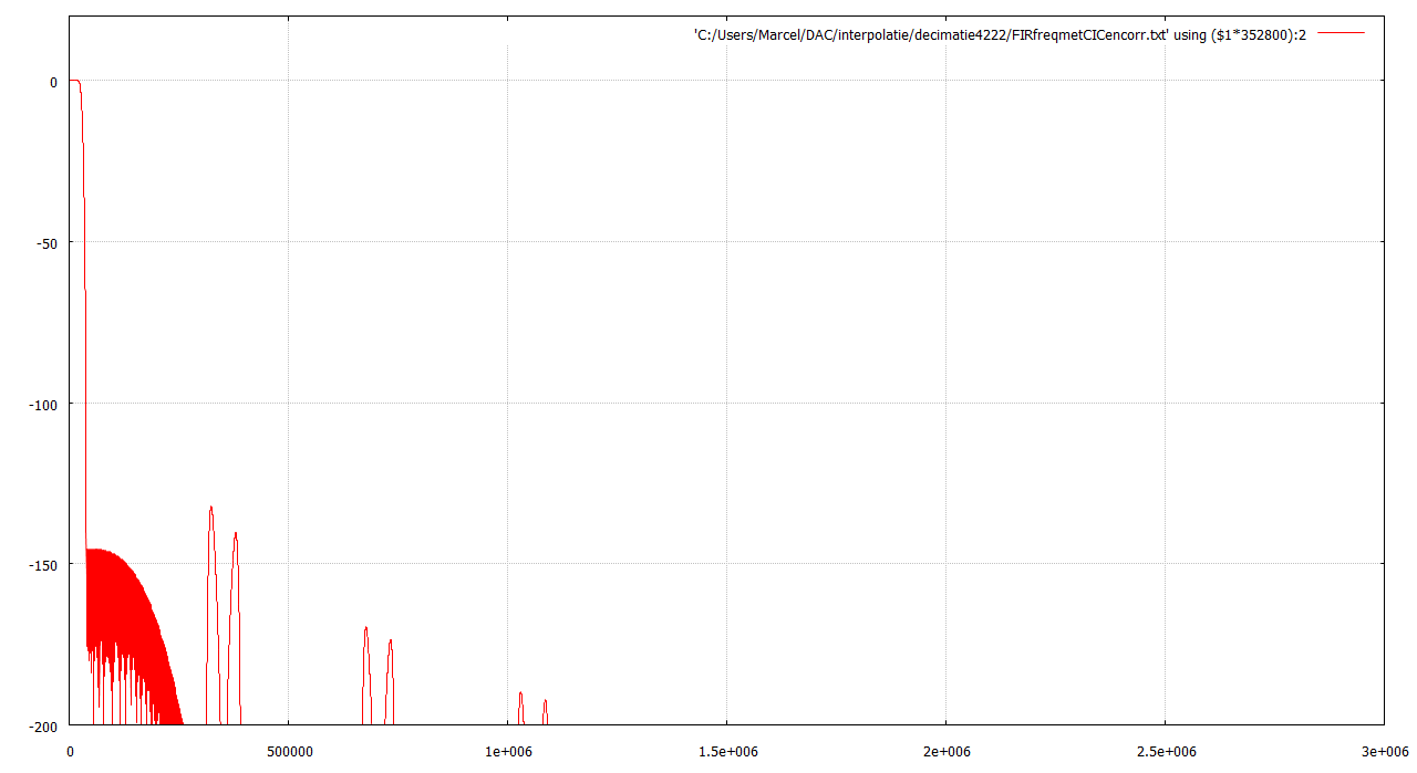

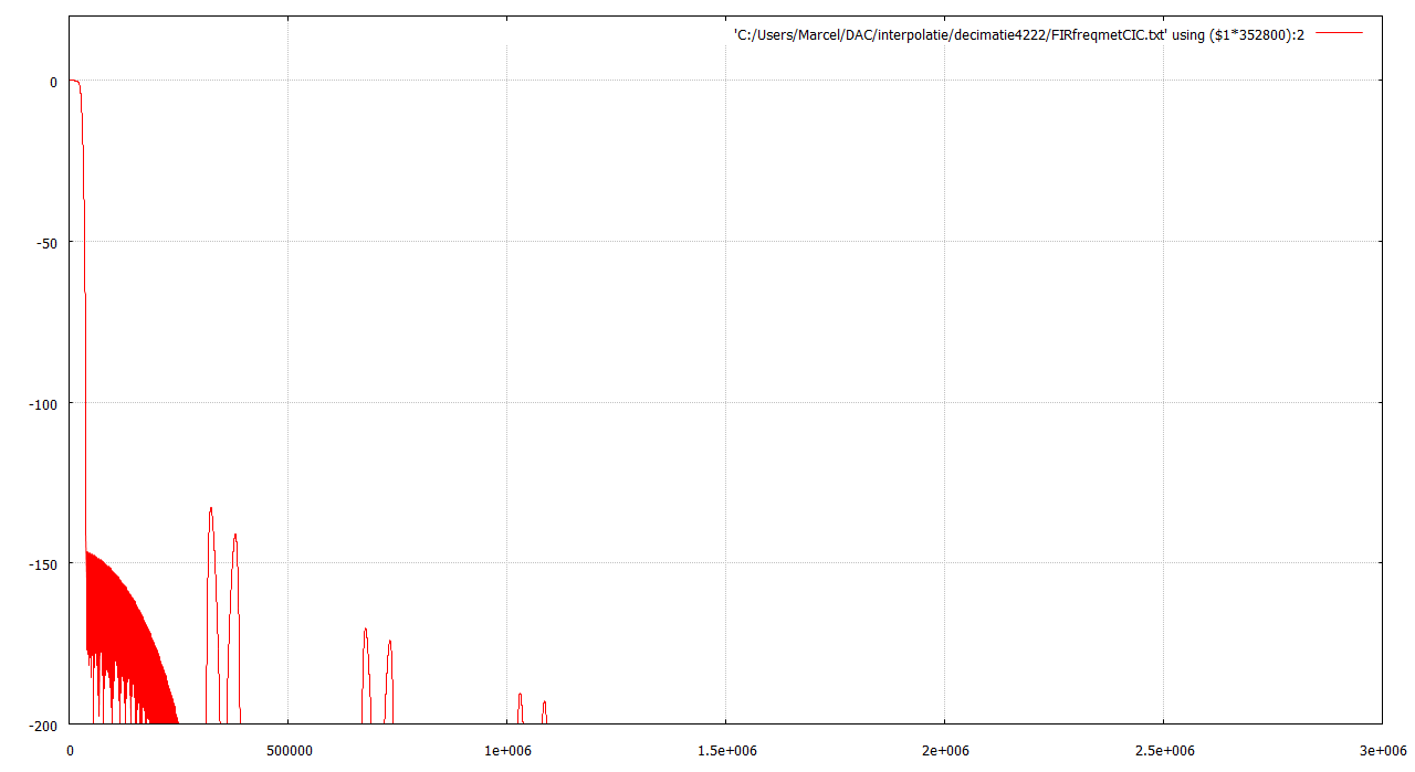

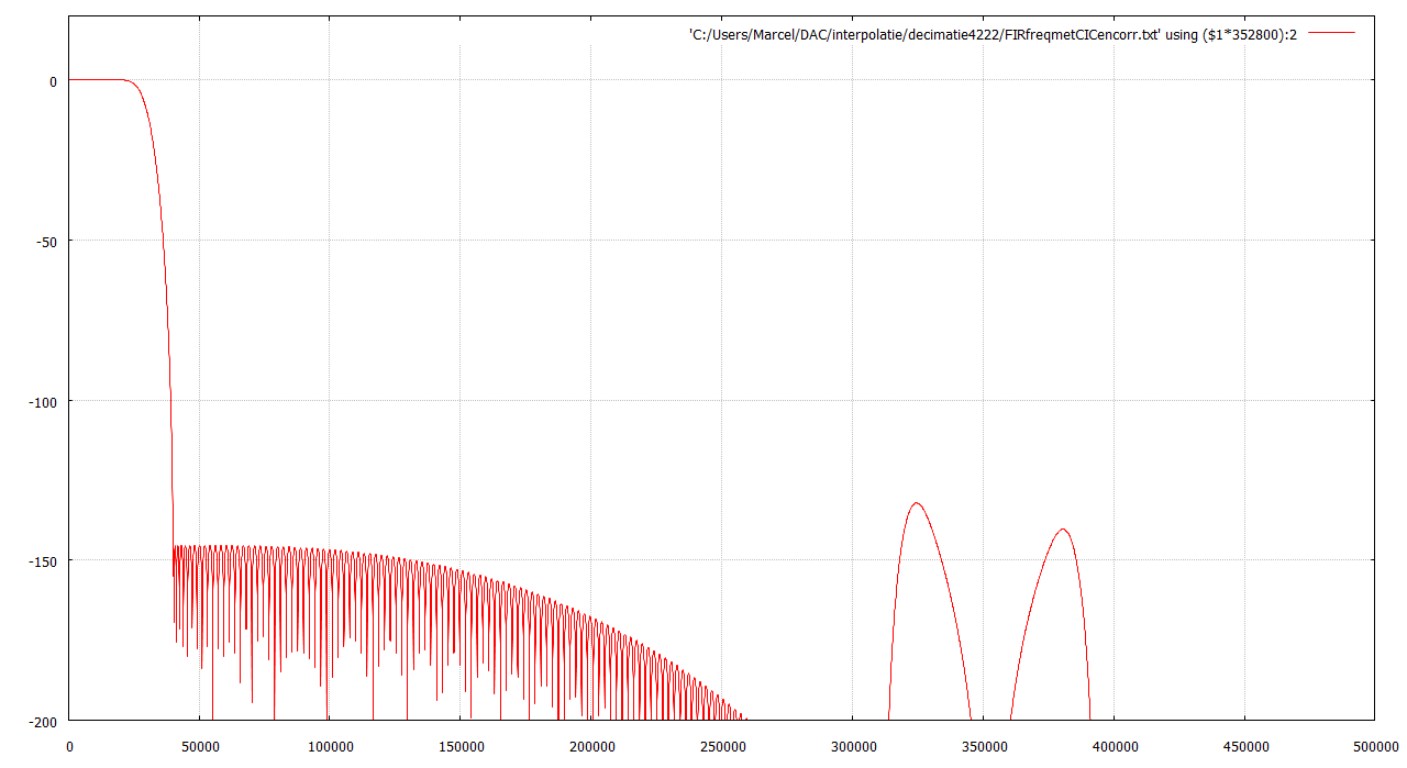

With the Xilinx program I have (free version of ISE 14.6), I can easily generate CIC filters up to the sixth order. Cascaded with Wednesday's linear phase filter, I get the attached frequency response (horizontal axis in Hz, vertical in dB). There is no need for intermediate rounding between the filters and it looks like it still fits in an XC6SLX9, the second smallest Spartan 6 FPGA.
The suppression around 300 kHz doesn't quite meet your spec: only 132.6713828 dB at 324.6173 kHz instead of 140 dB...150 dB, and it is bound to get a few dB worse when I compensate for the droop in the passband. The analogue filter on the evaluation module only cuts off above 657.3979 kHz (theoretical value, obviously), so that won't help. Then again, any practical microphone will have rolled off more than 20 dB at 300 kHz, so you will still meet it from acoustical input to digital output.
I assume there is no need for a digital high-pass filter, as you can remove the offset (which will be large, -20 dBFS or so) and any subsonics in your DAW. Is that a correct assumption?
The suppression of aliases around 300 kHz only degrades to 132.1246 dB at 324.5484375 kHz, so less than 0.55 dB degradation, when I include a five-tap correction for CIC filter roll-off. The in-band response becomes much flatter, as it should.
Cool! -140dB was not grounded in any deeper insight - I'm sure -132 is perfectly fina too.

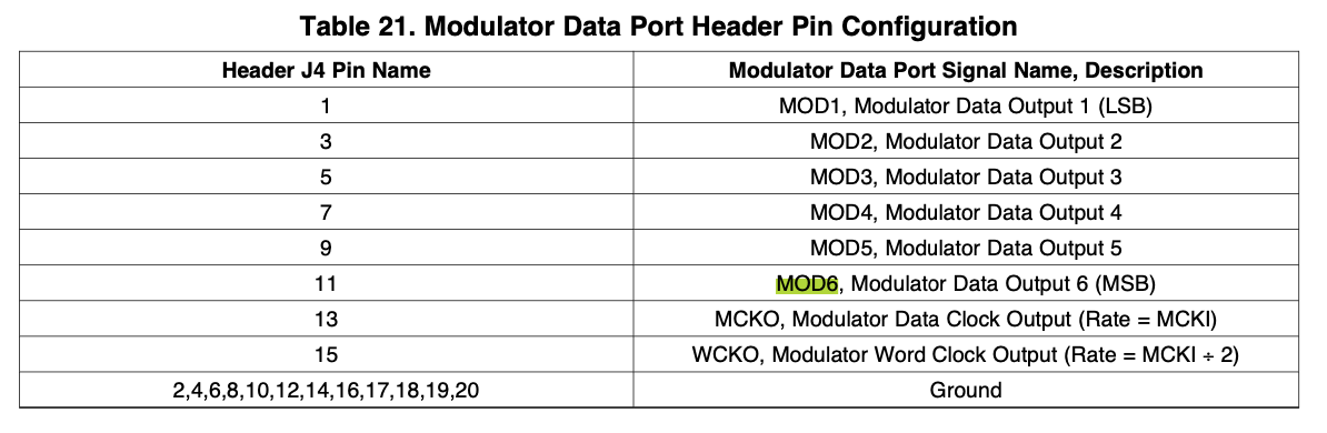

Cool. I see the 8 output pins from the EVM but which inputs shall these go to on the Mojo?
And where would the i2s come out?
And some good proper (opto) isolation between the EVM and the Mojo... and yet one battery / 5V system.
The inputs and outputs will be at whatever pins are specified in the user constraints file that I will write, although the master clock MCKO can only be connected to special clock pins.
