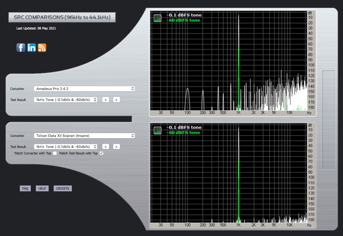

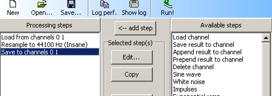

I plan to do any needed resampling with Sopran which seem to offer very high quality re-sampling... if not the best - despite that I have to resort to my PC laptop or my Virtualbox emulator... 🙁
Sopran:
Tolvan Data

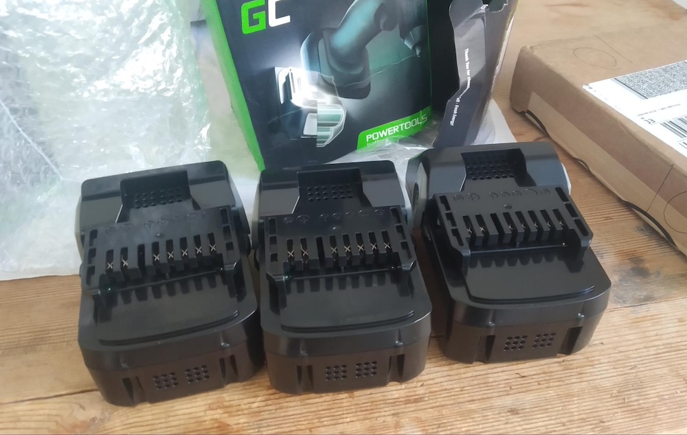

Got 3pcs 18v 4AH batteries for 5€ each from Amazon.se Charger was 25 :-/
Now to get some sort of connector to these....
They came charged to 18,4V
