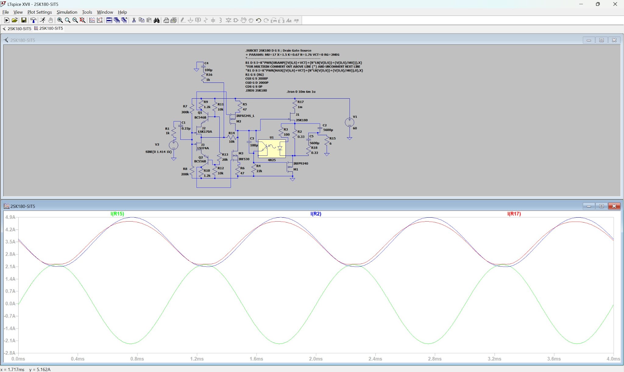

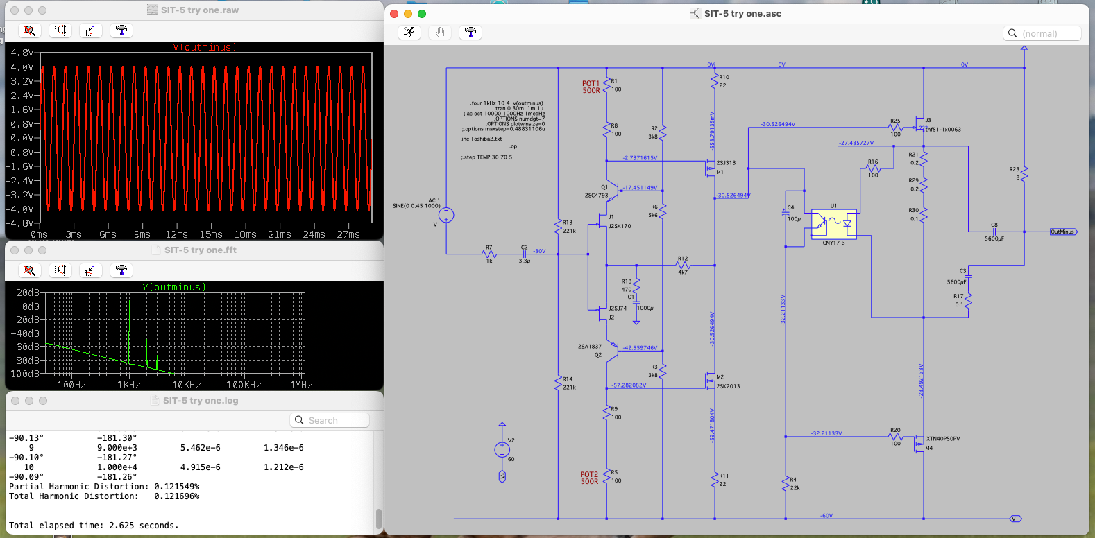

This circuit is working, see the pictures at 1W.
With 1VAC at the output it has 1% distortion.
Is that good?
I never can calculate for different types of amps the wattage by current and voltage. Hu, hu!
H2 is at 1W fairly high, 20db higher than H3.
Current is about 2A.

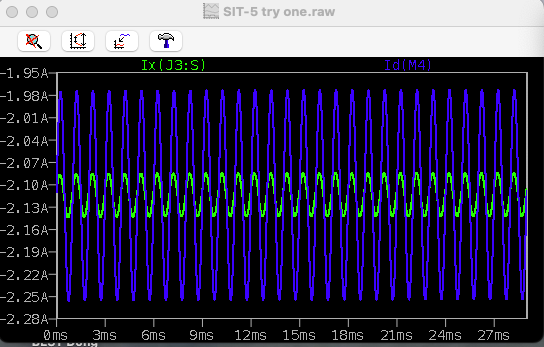

Most irritating is that not the Mosfet contributes 20% to the out current, but the SIT. I understood Nelson, it should be vice versa.
I get the inverse only by adding a bit 5R resistor in the source line of the Mosfet, that cannot be the truth....

For me, SIT5 looks more a DEFiSIT than Muff follower, so Mosfet contributes more current than SIT.

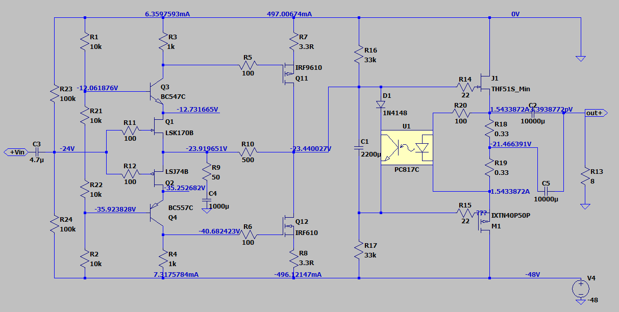

In the SIT rush, I bought few 2SK182ES bought and have been thinking what to do with them.
I wish I could win a Pass Vfet kit but came with empty hand, so decided build a simple one with the devices I have.
A post was done before and got all helps from our member including Mr. Pass. So I come with the original simple way.
It is like F4, the famous Jfet buffer with DEFiSIT. The bias is very simple: two diodes.
After I did sim I like to start with heavily degenerated Mosfet, like one our member suggested.

Of course I remember now, similar to SIT-3 with the Vgs matched SIT and MOSFET.

similar to SIT-3
everything pretty much covered in thread itself, and SIT-3 practically being commercial version of DEFiSIT, which was purely a prototype/proof of concept
