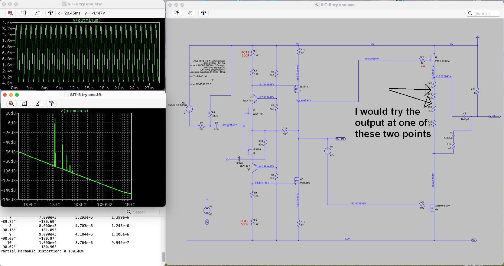

I may have to retract my observation. Re-reading it, it can be interpreted that the P Mosfet is contributing 20% of output.

Hello generg,
perhaps you could try to put the output between the first upper and second ( or the second and the third resistor?
Only a thought. Remember the 50W SE Schade -amp arrangement.

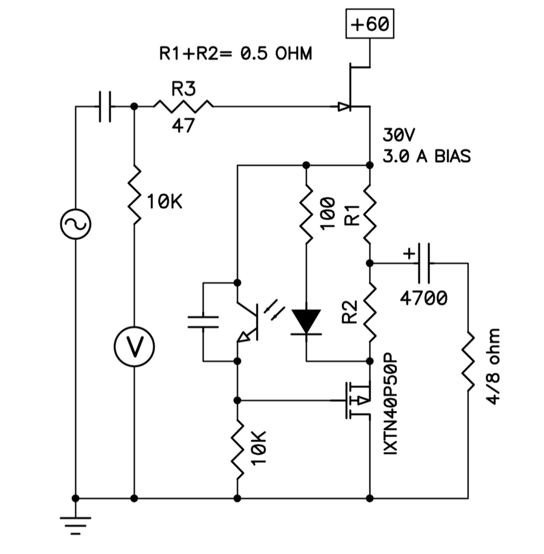

And I would think of an autobias -arrangement with 4N35 in the outputstage.
But this is my phantasy...
Greets
Dirk

typically about 20%
Judging by this sounds like the power resistors on the puck pcb are degen resistors(to be able to lower mosfet gm) and the power resistors on the sit pcb are current sense resistors placed in the drain of the sit. The sit behaves better without degen at high power levels and low impedance loads.
You can look in the sim how much current each transistor contributes and adjust the mos degen resistor accordingly.
Reactions: Chuck NoCal
Hi Dirk, I tried the different resistor connections, no real game changer.
I have the feeling this time there is no 4N35....
I stop here and wait for better men! With more experience in electronics and LTspice.

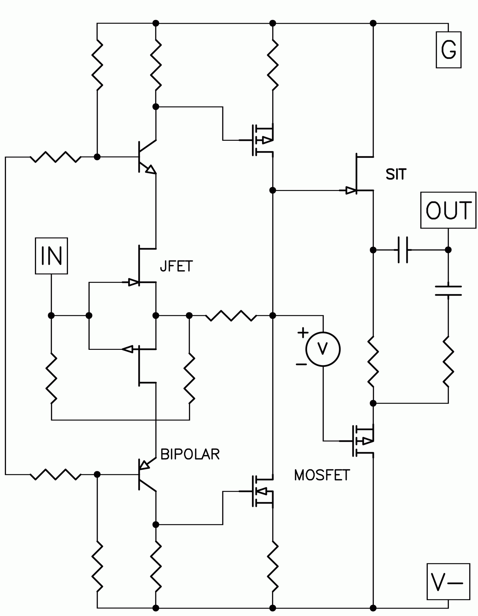

Seems pretty clear from the sketch, voltage gain from the front end, SIT is just a MU-follower, no gain, Nelson mention an easy 40W with this circuit at the SIT section. Seems to match the published pictures rather well…
Also the sketch shows that the feedback is limited to the front end section, and doesn’t include the MU follower SIT final section.
SB

without third ( 4th, 5th..) confirmation source, I'm not eager to draw conclusions between simplified schm above, and fact that FW Products page is stating SIT 5 as No Nfb gadget
though, output impedance and THD figure are sorta confirming No Nfb scenario
