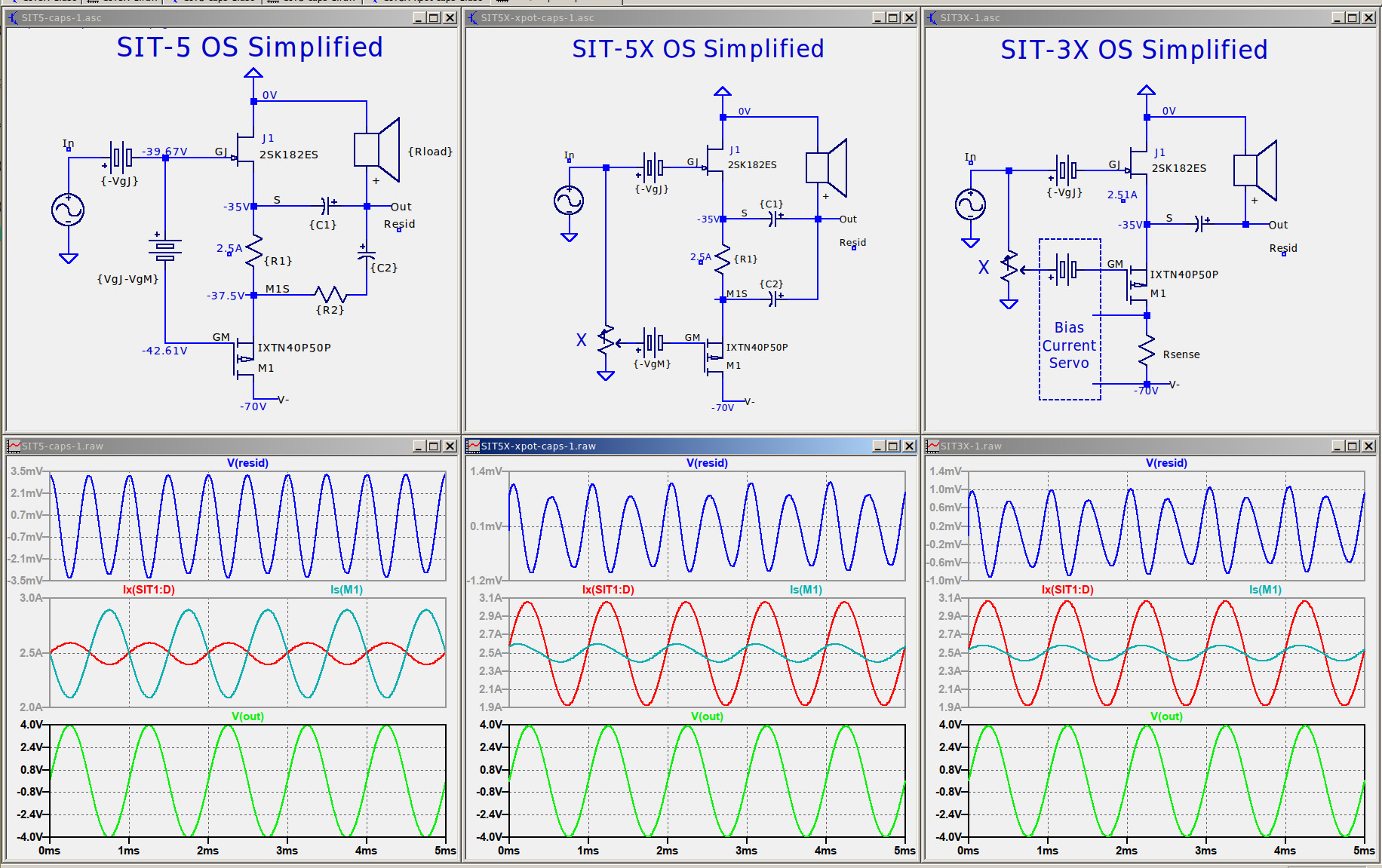

By actual measurement the AC current through the Mosfet is about 20% of the output current.

Did anyone think about installing a knob in the SIT5 like the SIT1? In this case to affect the balance, say from 10 to 30%, of the SIT's contribution. Or perhaps just a three position switch.
Yes, I did. You can change a few things with a knob in place of R2. Things like amp working class, thd spectra, thd at low power, thd at high power, output power.. actually too many things 🙂Did anyone think about installing a knob

Nelson writes some posts earlier
"....... In the diagram below, the output coupling caps have a DC bias and each carries the bulk of the AC from their attached Fet, but in reverse phase. In this manner the 2nd harmonic each would have is cancelled."
In my Spice the currents in the two output caps are not reversed. Only when I turn one cap about 180° the two currents are reverse....
Oh, this spice has more traps than I thought, I need a Ki....
I always thought LTspice is clever enough to set at least the DC currents itself in the right way using the difference of the voltages left and right of cap or resistor.
