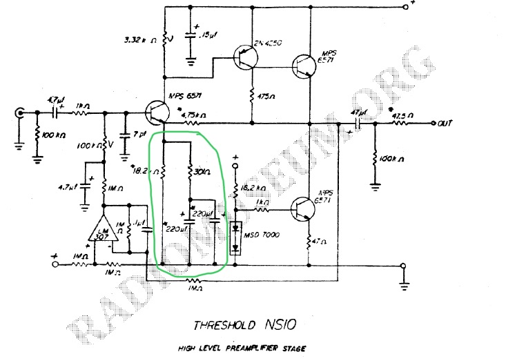

This morning was looking around and noticed a nice biasing scheme from earlier work of Pa
It's the "dual" of the textbook circuit: emitter resistors in series, electrolytic capacitor from resistor midpoint to ground.
In both cases the idea is to create an impedance from emitter to ground, which is lower for AC signals than for pure DC. Thus the AC gain is set suitably high, without disturbing the DC bias point.
The "dual" flavor as implemented in the NS-10, allows the use of smaller electrolytic capacitors to get the same AC gain. Which was probably economically advantageous in 1978 when it was designed.

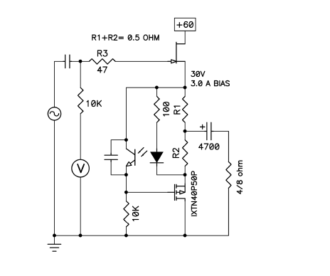

Hm, hm..... riddle of the day for beginners!
SIT-5 manual:
"we can trim the load line of the SIT so that it dominates the output character, adds a little to the output power, but mostly gives a consistent character across a population of SIT devices."
Desperate mind thinks:
This could lead to the consequence that the SIT contributes only 20%. and not the MosFet.
If we assume this, is then the condition "mostly gives a consistent character across a population of SIT devices." fulfilled.....?
SIT-5 manual:
- can the SIT "dominate the output character" and at the same time "add a little to the output power" ?
- "across a population of SIT devices" We know that the THFs vary much in their data.
Maybe the 20% SIT contribution are responsible for the H2 dominance up to 30W simply, that could be meant by "dominates the output character"

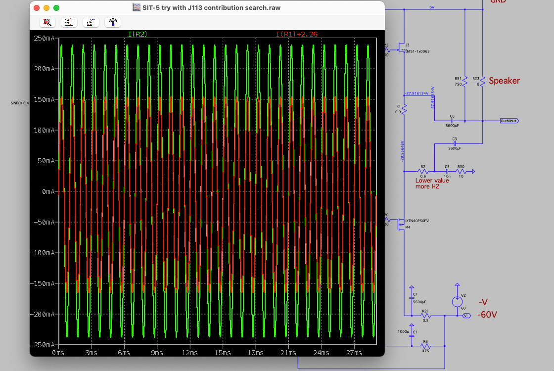

Changing the load line usually entails changing operating points. I suggest changing the SIT Vds, increasing it so that the SIT dissipates more energy than the mosfet.
The nice thing is that it can be easily done in LTSpice. Give it a try. 🤓

So it seems Nelson took into account details in his circuit to minimize the effect of SIT data differences.
Or look here.....
And
The Owners Manual description sounds like the MOSFET provides most of the power.
And
Hm, seems that I have difficulties to understand this sentence.....
" This arrangement is unique in that the SIT is given a single ended
Class A bias current by the P channel Mosfet which is allowed to make a smaller
contribution to the output, typically about 20%. This is seen on the right hand side of the
schematic where the output goes through two sets of power resistors and capacitors."
For me irritating as not native speaker.
And of course I am used that the CCS is always giving maximum 50% in Nelson designs.
Maybe I mix it up with the Aleph way of adding some more power.

to give more nightmare to Generg if you use 4 /8 or 16ohm speaker is the H2 H3 ratio change of just the amount of distorsion ? 😎
though, with Pa, you always count on possibility of typos, slips or similar .......... non- or deliberate
Papa's are funniest ways ......
By actual measurement the AC current through the Mosfet is about 20% of the output current.
no typo here!!
In any case you can set it anywhere you like with little effort.
