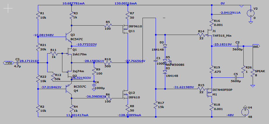

First Watt SIT5
I already have/had something similar, early iteration of Babelfish XA252 (SIT), which I abandoned, wasn't too happy with parts choice, even if I was happy with performance

I asked, he answered!
Spice says the currents through Nelsons R1 and R2 are anti phase so they tend to cancel when they are equal.....and there is remaining amount when they are not equal that can be easily done with a resistor change to the second output cap.
Am I wrong?

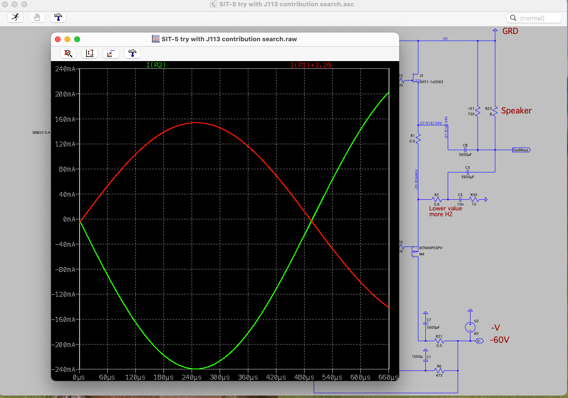

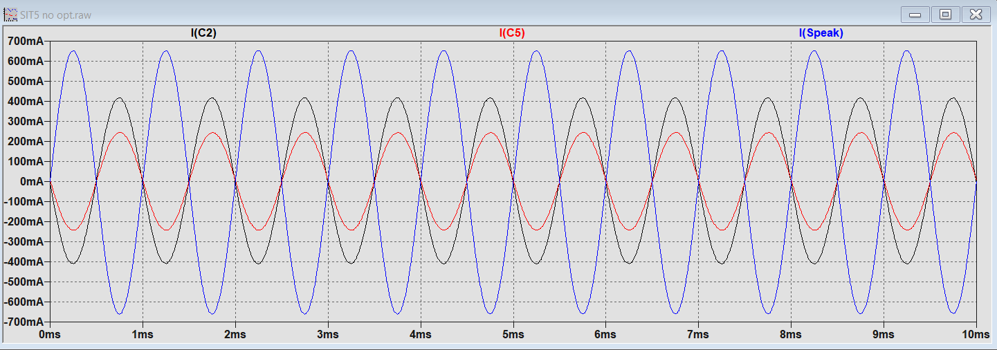

It took me one day to see this.... do not laugh!
I went back to my Spice and called the resistor between the sources R1 and the resistor going to the second output cap R2.
When I look at the currents of R1 an R2 they are antiphase. I lifted the R2 current a bit for better comparison.
And yes the current through the caps are in phase, but this was not my claim.....
So R1 and R2 do not simply add with their full values....
